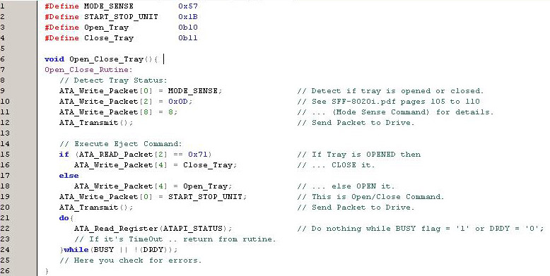

To Andrea:
here is code that I use to Open/Close CD/DVD Tray (see attachment).

Hello Dave,
in my therms, 'initialization' is similar to that made for LCDs at startup or DSA Modules, when you tell them how to configure DACs or other pheripherals to work properly or accordingly to your needs, etc... About the first command... (in my actual version of firmware) is 'Inquiry' (0x12) to see if it's any device connected on ata bus and then those commands related to Read-TOC. I apologies for this disagreement and i'm sure that my code is very similar to yours regarding Ata / Atapi.
