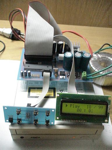

This is my CD-Rom Controller. I started this project 3 years ago.
I've developed the circuit and software time after time. The circuit board in the picture is the newest version. It can be commanded by remote control.

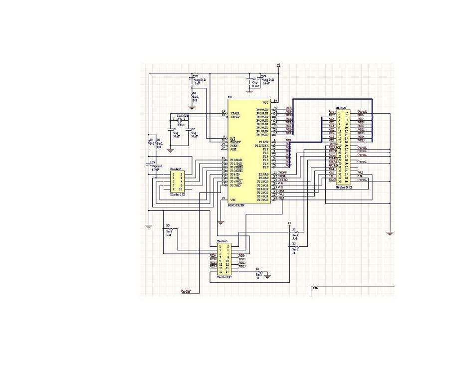

Thx.
The schematics that I have weren't completed because I had designed time after time, sometimes I designed PCB without drawing the schematic. But if you need I can give you, just give me your email address. However, I have a few samples for free, it might be more useful for you.
I'm interested in all the designs, enjoy considering design choices
different people have made.
I would be happy to see anything you are willing to share.
@rogers.com needs to be added to my screen name to create an email address.
I am also guilty of some direct_to_pcb_layouts. Sometimes not so successfully 😉
