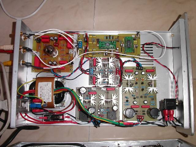

Here My DAC...
CS8414 + AD1852 + OPA134

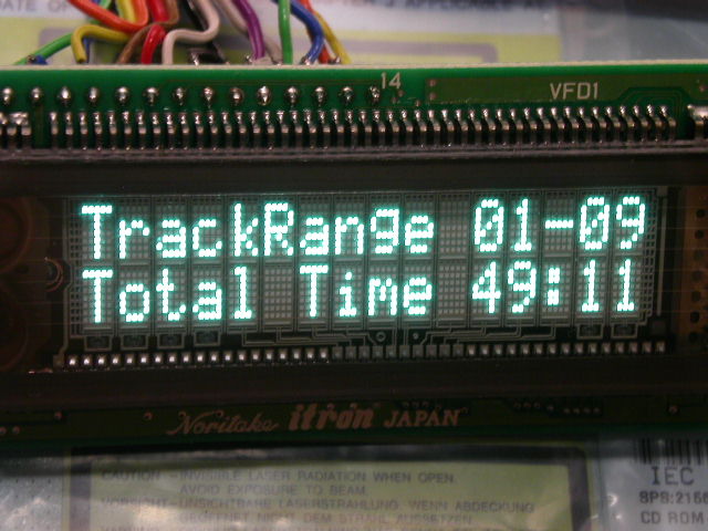

davesaudio said:
MCLL,
That must be a HD44780 compatible VFD?
or did you rewrite the code?
D
Yes, HD44780 compatible VFD from Noritake-itron. In Hardware Pin assignment, just disconnect pin3. In coding, It's too mush flash & blink when playing, I was rewrite complete.

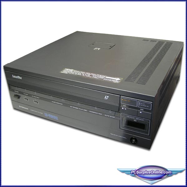

karma said:
could you not mod out a old laser disk player?. there the same size as the lp and the tracking is allready there.
would be nice if it worked😉
Nice idea.
How much could you get on the LDs MB wise?
The LD would definitly provide an easier transport and mechanical solution.
Just leaves fixing the tracking for a record groove and adding the read beams.
Perhaps the designers of the Laser Player got the idea from the LaserDisc.

Checked the bay, old LD players are literally bin material price wise. There's a pair on there for 70 pence at the moment. 😀
