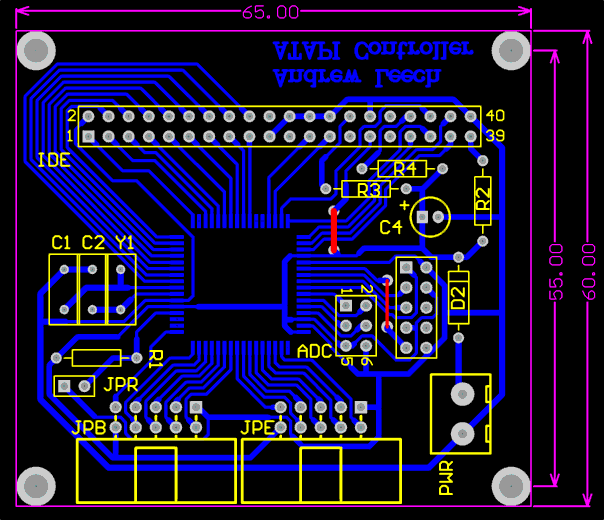

I've been interested in building a micro based cd controller for some time, only just read this topic in the last couple of days.
I've already designed a prototype board for my chip of choice, the ATmega64/128. My board has the advantage of being quite small (6cm by 6.5cm) and is single sided, so very easy to home produce. That's what I do, anyway. Haven't started on the code yet, still getting myself lost in the ATA/ATAPI specifications drafts.
I've read many comments about people not wanting to have to use surface mount stuff, but there really isn't anything to worry about. I realise it seems easy for me becuase I've got experience, now, but it's not like my hands are all that steady or anything. The 'secret' is to get a tub of paste flux, I found some at the local hardware store. you wipe on some of this gunk under where the chips pins go, then sit the chip down, and just wipe a big blob of solder over all the pins in one go. the flux means it basically removes bridges on it's own. I can put a mega128 on a board in under a couple of minutes like this. Don't try soldering them one pin at a time, that's what makes it hard. Any stubbrn bridges can usually be removed by putting more flux over them, and then wiping the soldering iron's tip along the bridge away from the chip.
