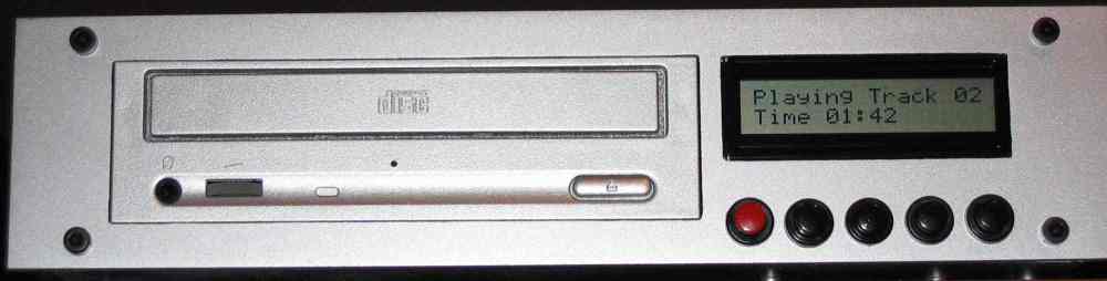

I've partly finished the MCLL CD-Rom controller. Here is a photo how it looks like
