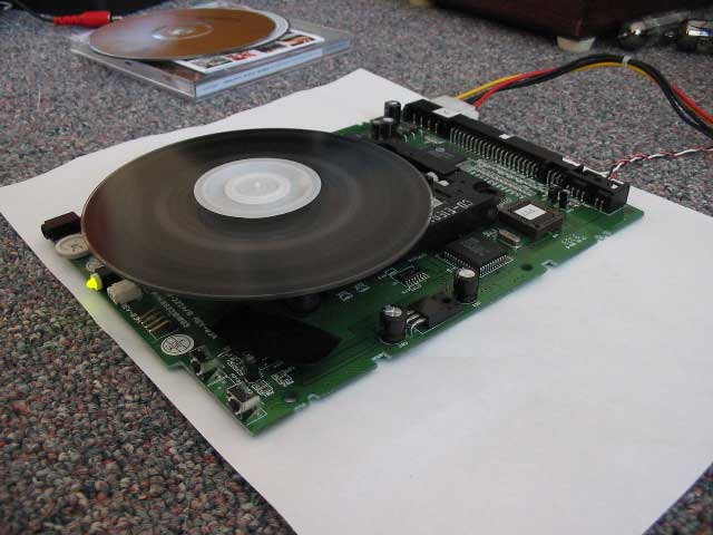

Cool this thread re-appears. I have yesterday Build a power-supply 5V and 12V for a cd-rom and attached it to my stereo having 3 cd players plus this computer cd rom i have to say that the computer cd rom sounds best.. Only fed audio with left and right output at the cd into a tube pre-amp to a tube power amp with my new speakers it sounds better than a store bought cd player.. So far.
Now i want to build a dac the something that can pause the cd player and maybe a small buffer to up the cd-roms out put a little. It's kinda weak on the output..

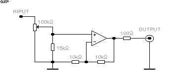

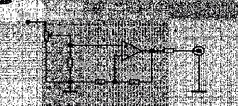

Any one know of a simple op-amp circuit i can use to up the output power on the cd rom * stock * OR a simple dac circuit to use with a cd rom ?
I got it from here for simple OPamp.
http://sound.westhost.com/project09.htm
For Dac I use TDA1543 x 4 you can search in this digital forum so many schematics.
Pradit

i had 3 cd roms i listened to all of them then this one became it. I disassembled it and kept the rubber isolators on the cd module and now here it sit's now i want to build a audio buffer and see what it sounds like then a digital dac .. if that works out then go from there to a nice case top-loaded then a display : O )

Well as i listen to this cd player more and more i like it a-lot. My only problem is i cant tell what track i'm on or pause ir ot skip back only forward and play. Im wondering what my steps are ( im on a mac but have access to a pc and a programer maybe ) to get a display to work on this ide cd rom with out killing the sound from the audio out port. i can build every thing with no problems just need the path to follow..
I have a Optrex red display brand new just dim.
Model number is C-51505 Tm005 If pictures are needed i can provide them..
