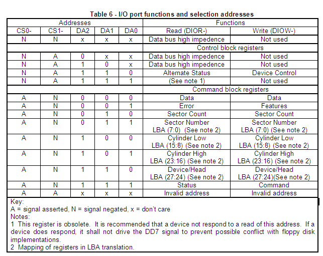

I see in the assembler source available that in the write both W and R pin of the ATA bus are set to high, why ?
How to set the register in the write and in the read to see if the drive is busy and to send a command like play, eject, stop .. ?

"I see in the assembler source available that in the write both W and R pin of the ATA bus are set to high, why ?"
The strobes are active low, high is the rest state.
I think some DMA transfers will run on both clock edges but that beyond me...
Can you give me some reference for this packet containing
write_atapi(0x1e, 0x00) ?
maybe its a newer command?
I have been told they have depreciated some useful commands
so its best to try firstime with an older drive

I would expect to initialize with similar pseudo code as below
set up all you regular stuff
start here
make dio read high
make dio write high
wait a couple of seconds
routine to select device 0
------start routine-----------
low CS0
high CS1
low DA0
high DA1
low DA2
high byte= 0
lowbyte= 0
strobe write
--------end routine-------
;check if cd busy then wait loops here
; read atapi status register
routine to read atapi status
;ATAPI STATUS Register:d7-d0
;BSY,DRDY,DMA,DSC,DRQ,CORR,Reserved,CHECK
low CS0
high CS1
high DA0
high DA1
high DA2
read cd atapi status and save
wait until drq=0 fourth bit and bsy=0 eighth bit
keep reading until above true
routine features_reg - tell it we are not doing dma or ovl fancy stuff
low CS0
high CS1
high DA0
low DA1
low DA2
high byte= 0
lowbyte= 0
strobe write
rest of the code here....
now we can talk to cd?

In respect to this table which is the line to consider in the startup and command phase ?
--- phase 1 - select device 0 ------
low CS0
high CS1
low DA0
high DA1
low DA2
high byte= 0
lowbyte= 0
strobe write = (W = 0, delay 1ms, W = 1)
--- phase 2 - check state -----
low CS0
high CS1

Andrea I'm not sure I'm providing any extra value to you?
I don't know C. I have been giving you my understanding based on the elector pandora code (link in this thread) which i have hacked a little.
I believe you know MPASM and should be able to convert to C?
I see you have ssf80xxxx.pdf its the best doc
how to read the status AFAIK
set up the address via
CS0 CS1 DA0 DA1 DA2 - you know this
read strobe low
maybe some delay to settle
now read low byte this is atapi_status
copy the low byte to some variable
read strobe high
read the bits on the saved variable and apply logic
if the bits are not good do it again (wait)
Not sure of you last qustion,
what must you do to be able to get to the point where you can command the drive?
will answer what I can....
low CS0
high CS1
low DA0
high DA1
low DA2
high byte= 0
lowbyte= 0
low CS0
high CS1
high DA0
high DA1
high DA2
strobe read ?
save status ?
--- phase 3 - features_reg ------
low CS0
high CS1
high DA0
low DA1
low DA2
high byte= 0
lowbyte= 0
--- phase 4 - unlock tray ------
low? CS0
high? CS1
low? DA0
low? DA1
low? DA2
high byte= 0x00
lowbyte= 0x1e
strobe write
high byte= 0x00
lowbyte= 0x00
strobe write
high byte= 0x00
lowbyte= 0x00
strobe write
high byte= 0x00
lowbyte= 0x00
strobe write
high byte= 0x00
lowbyte= 0x00
strobe write
high byte= 0x00
lowbyte= 0x00
* btfss INTRQ PORTE,0 ;interrupt line
* goto $-1
* call read_status
wait until INTRQ is high then read atapi status register
--- phase 5 - check state ----- atapi status register
low? CS0
high? CS1
high? DA0
high? DA1
high? DA2
read strobe low
read strobe high
If the bits are not good do it again (wait)
--- phase 6 - eject ------
low? CS0
high? CS1
low? DA0
low? DA1
low? DA2
high byte= 0x00
lowbyte= 0x1b
strobe write
high byte= 0x00
lowbyte= 0x00
strobe write
high byte= 0x00
lowbyte= 0x02
strobe write
high byte= 0x00
lowbyte= 0x00
strobe write
high byte= 0x00
lowbyte= 0x00
strobe write
high byte= 0x00
lowbyte= 0x00
--- phase 7 - check state ----- atapi status register
low? CS0
high? CS1
high? DA0
high? DA1
high? DA2
read strobe low
read strobe high
