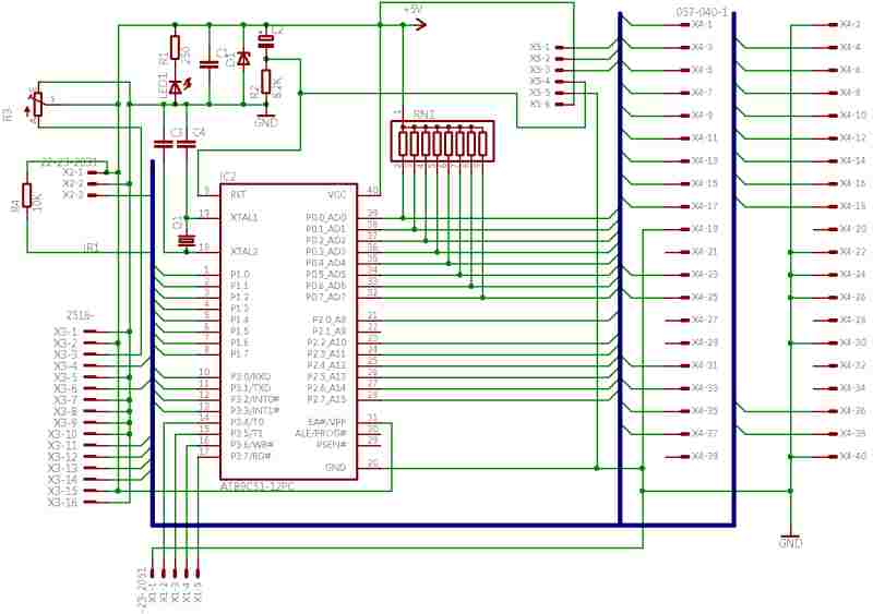

MCLL,
Sorry about this fool question, but I want to build it, but there's only 4 control buttons in the PCB Pdf file from your site, and in the source file I see five buttons.
Is your PCB File and schematic file updated? What are the functions of the buttons respectivelly 😕
Best Regards,
Fernando
