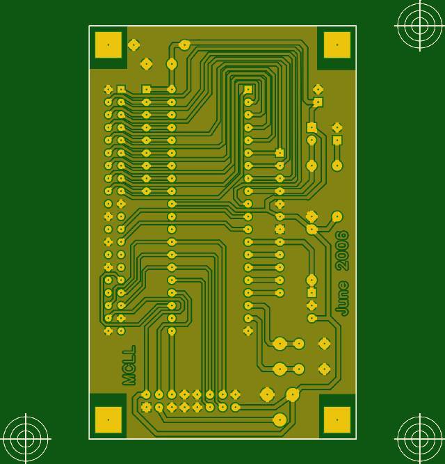

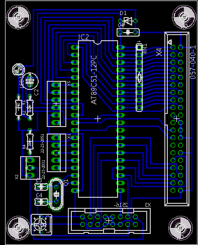

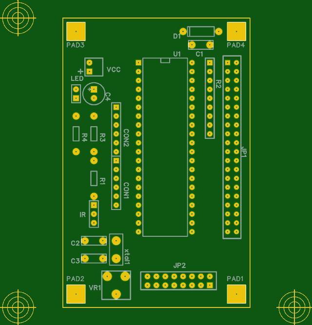

DIY CD drive based on a computer CDROM
PCB
And The PCB
We are using a CD-ROM controler from diyclub.biz that works pretty well. When conecting the digital output of a CD-ROM drive to a DAC we however have the following problems: One CD-ROM drive generates a terrible noise during reading in a CD (so something totally wrong must happen on the digital output). Another CD-ROM drive is totally calm when reading a CD. But when you start the CD or you skip to the next track you get an awful plop.
Is this a problem of the CD-ROM drives? Did somebody have the same problem or even better a suggestion which drive to use? Is this a problem of the controler?
An answer would be highly appreciated.
Christian
