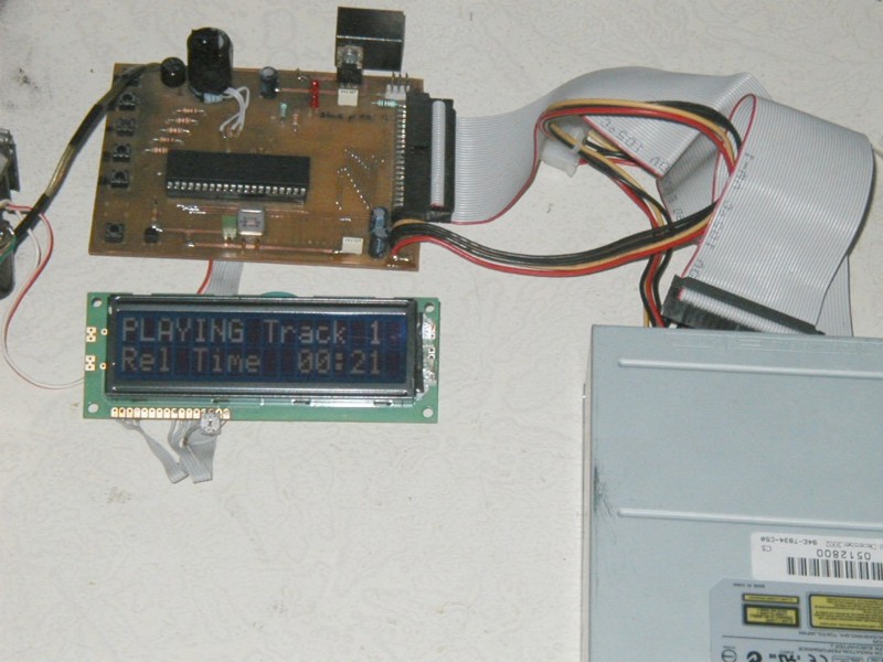

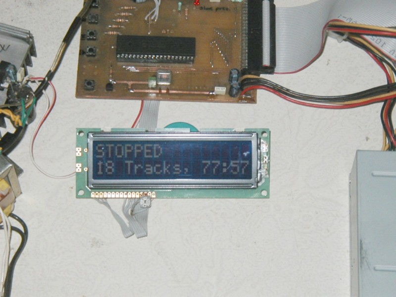

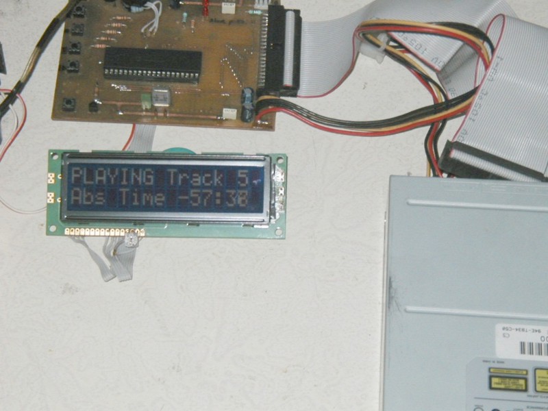

My project is almost finished and works fine. Here are some pics with the test board. I'm making a final board now with a cleaner layout. The uC is a PIC and the software supports front buttons, 2x16 display and RC5 remote - almost all functions. Also supports 2 cdrom units on the same cable (master/slave).
