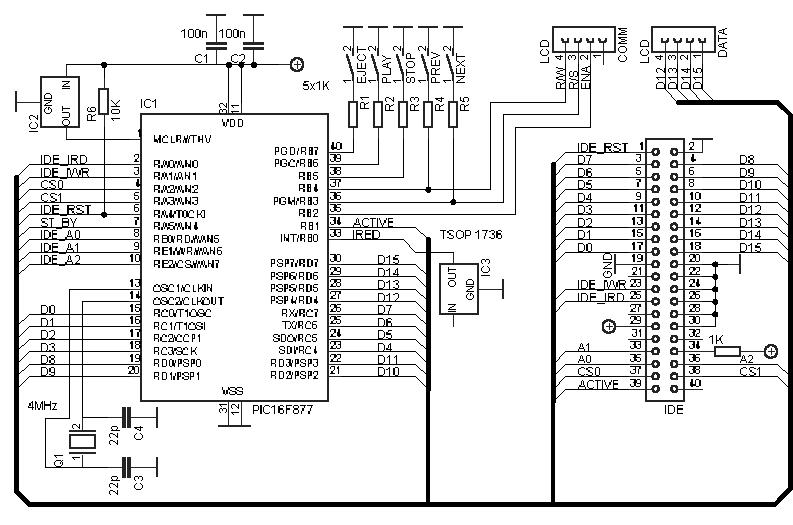

Actually the final board is with 2 layers, too. But if there are enough requests I will make the boards available. I will post schematic today. I'm working also for the complementary DAC for the cd-rom drive in this configuration: AD1892/PLL1705/AD1865N-k/custom I-V stage.

reuses a nibble to talk to the lcd ?- clever
maybe link to larger image?
ok, i have finnal got a crystal and tested my prototype of the MuCoP circuit. first time, nothing. re-check every connection, 4 connections reversed. so i fixed that, and try agian. this time, the IDE status LED came on, but all commands are ignored.
i think the chip (a 4MHz version of the PIC16F877) cannot handle 20MHz. 😛 i will try re-programming it, on monday when i will have a chance to get to my PIC programmer. if that does not work, i will buy a new PIC (a 20MHz one).
sorry to disappoint anyone.

Mucop is the project MatttCattt is building. On a related note has anyone managed to get one of these players to play back at greater than 1X speed?

yes, that is the project i am copying/building.
Lupulroz, we like what we see
in which direction are you thinking?
a commercial offer /a kit / board / open source / something else ?
Playing at another speed than 1x is perfectly possible, but only implementing the READ command - and getting parallel data on the ATA-bus.
If you like my project then I will make the final boards available including pre-programmed PIC's. I don't know for the moment the price of the boards, as I have no clue how many to order.
So please, everyone who's interested give me a mail at fiction_73@yahoo.com

Actually the PLAY commands are not supported by the old ATA cd-drives, according to documentation and my experiments. So anyway you have to deal with the READ command if you want to use them, I suppose.
Only newer (1997-today) ATAPI devices understand the PLAY commands.
