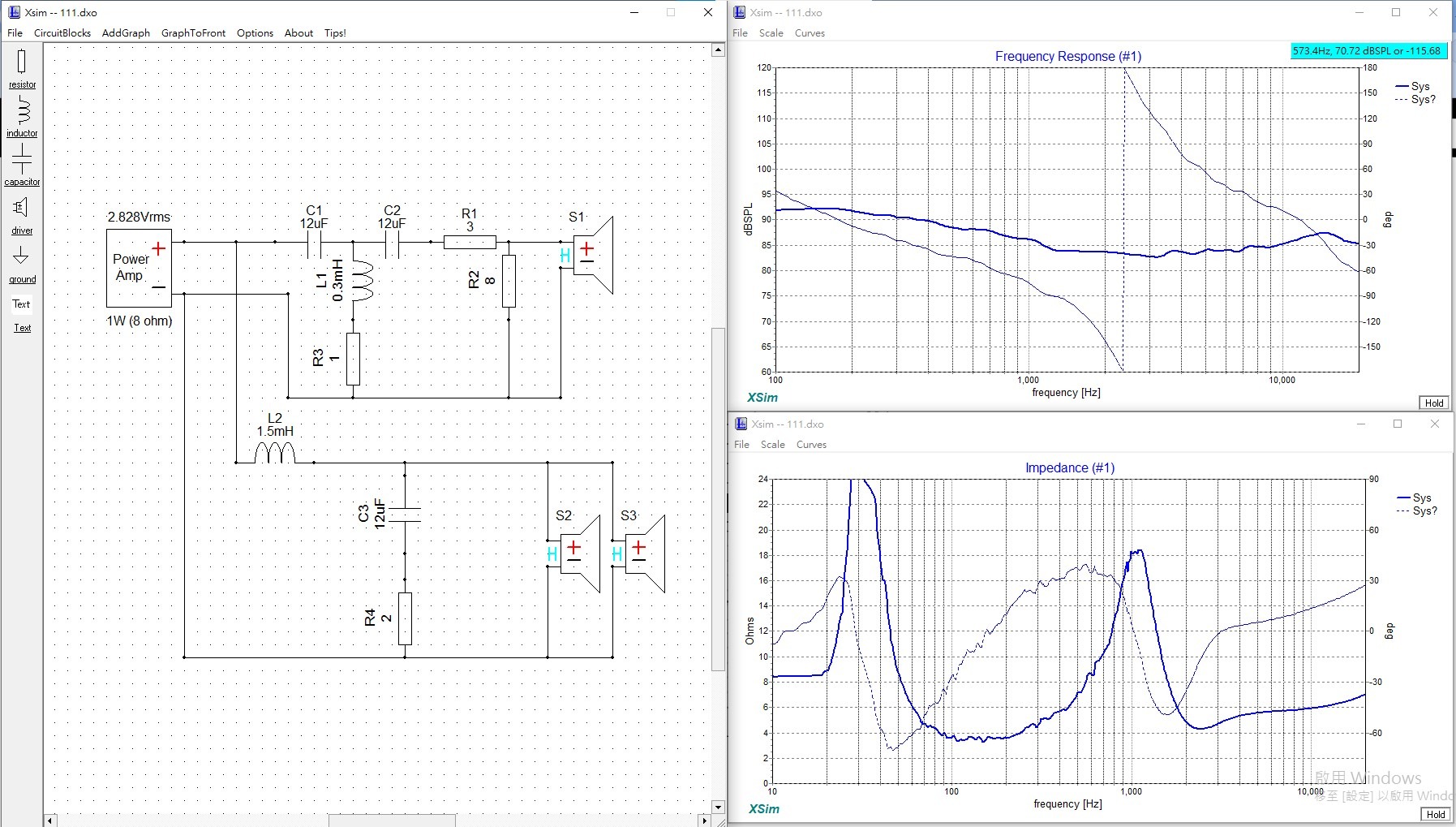

#1606

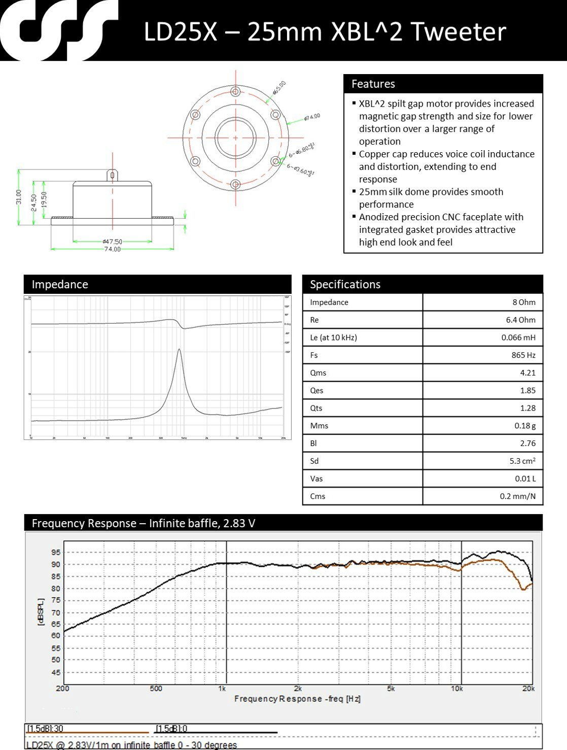

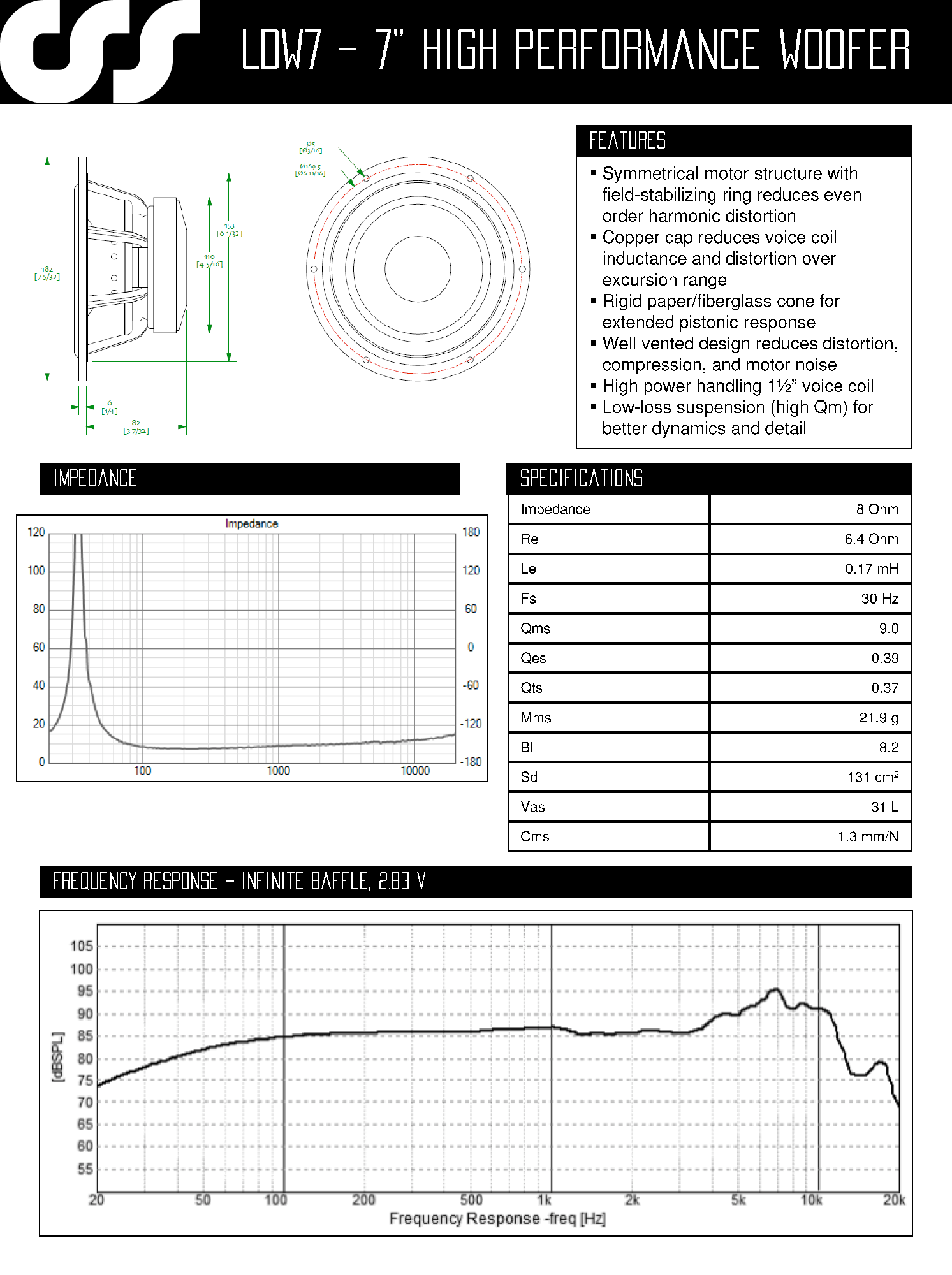

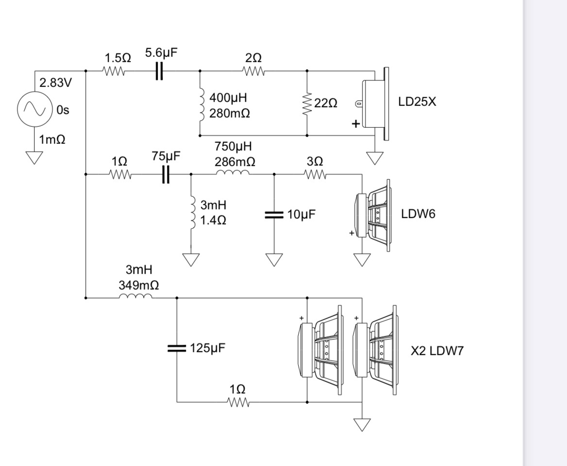

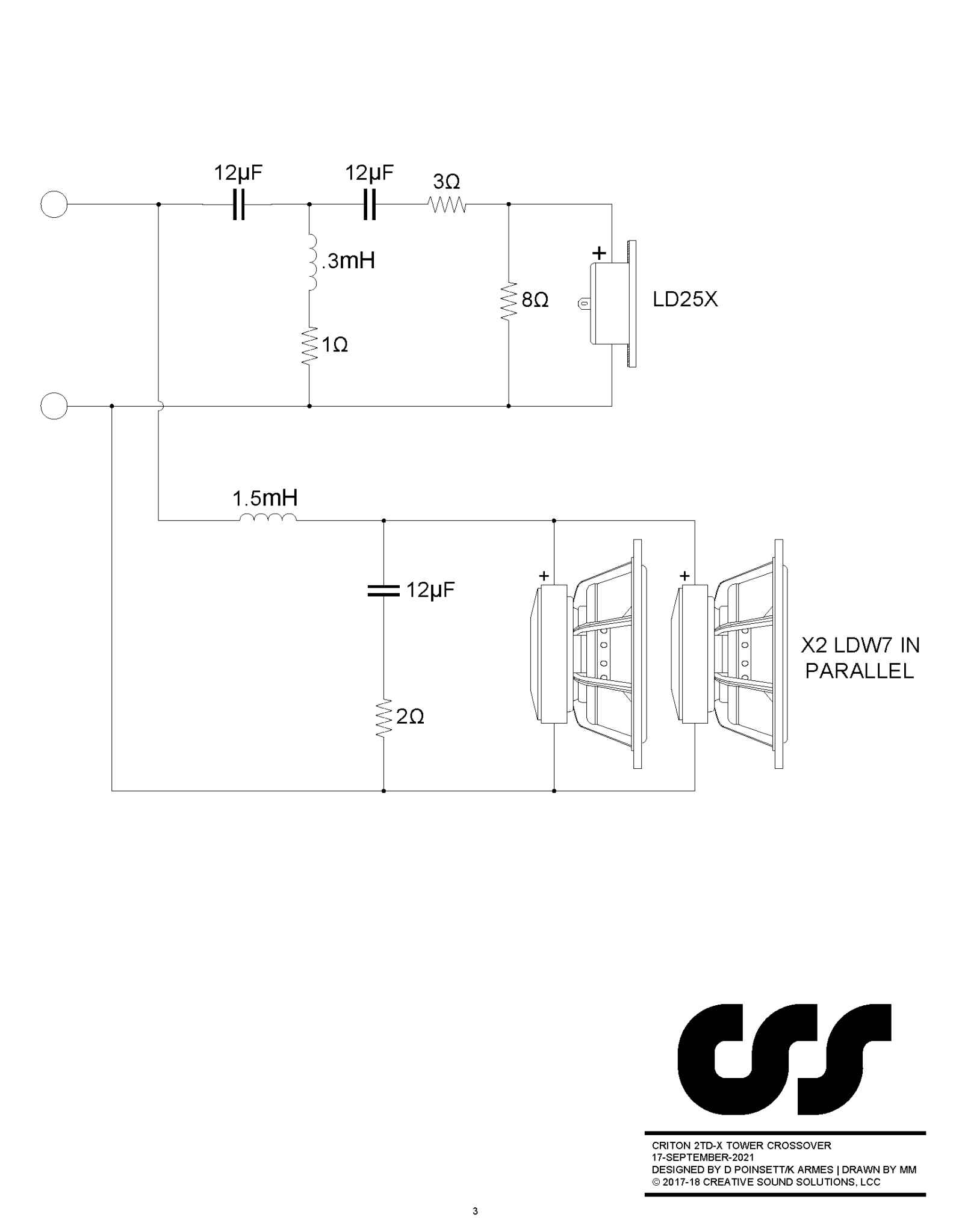

I did studied a little bit about the original speaker design and how to recreate similar performance by this active crossover board.
"Tweeter info" is the tweeter charateristcs.
"Woofer info" is the Woofer charateristics. Two identical woffer are wired in parallel for one channel. So half the impedence only.
"original passive XO design" is the offical design crossover with passive component.
"XSim stimulation" is the simulation of orginal frequency response and impedence when all things combined together. The data of tweeter and woofer were extracted and applied to the simulation.
I need the response from the drivers as they are mounted in the speaker.

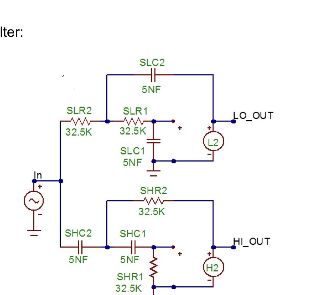

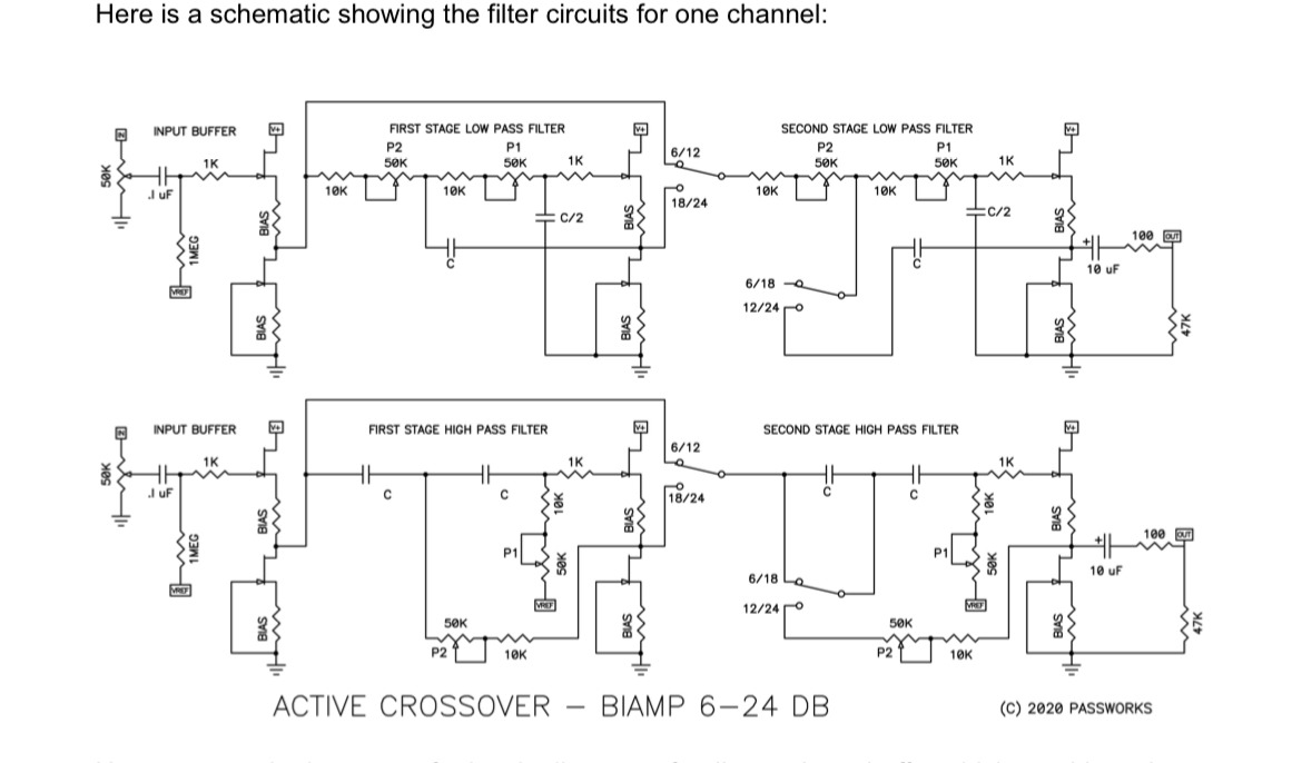

Your R values are too small looking at the Sim for the 50K trim pots. This is why your filters at off.
The R value should be the fixed value 10kohms plus 50% of the 50K trim pots (25 kohms) for the trim pot to be centred at 1.8 khertz.
So select your C values for about R equals 35K in the case of 50K trim pots. You may prefer to use 25K pots so the R value in your Sim is 22.5 kohms for the pit to be centred at 1.8 khertz.
This will need looking at the preferred values of C to get C/2
To set up the active crossover and test that it is working correctly use REW with a scarlet 212 interface to perform a frequency curve of each filter.
Alternatively measure your trim pot values before you install them.
These impedances are high but remember you are using Jfets here not opamps.
I would worry about the passive network. That will just confuse you. Simply aim for a 24 LR network @1.8 khertz.
Once you have tested the active crossover voltage drives then use REW to perform frequency response measurements to obtain a 1.8 khertz Acoustic crossover frequency. The electrical crossover points may end up being different to obtain the transfer function. The electrical polarity of the LR24 is in phase. Reverse the phase to confirm a phase null of about 20 db at the crossover point. By adjusting the Trim post you will obtain the phase null.
This is why need the trim pots centred at the design stage.

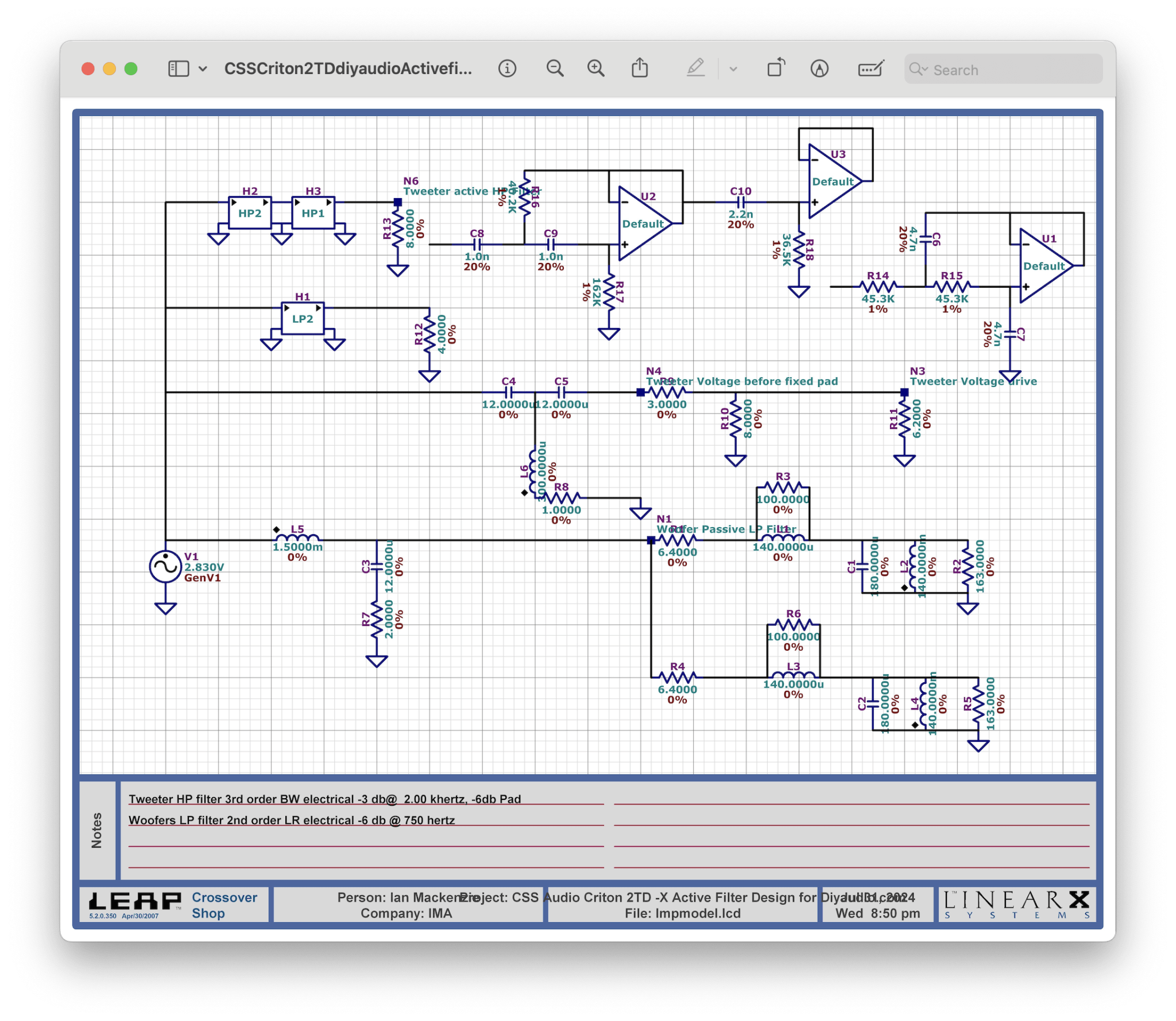

You have a lot of problems, and none of these responses addresses them.
You say you configured the 6-24 for 4th order, but your CSS crossover schematic clearly shows 3rd order for tweeter, 2nd order for woofers. Of course the wrong slopes will not sound correct. You cannot arbitrarily change the basic design of the speaker system and expect it to perform acceptably.
Also, if you turn your pots counterclockwise, that will make them the highest resistance, not zero. Turn them clockwise to obtain lowest resistance.
There is nothing wrong with your 6-24.

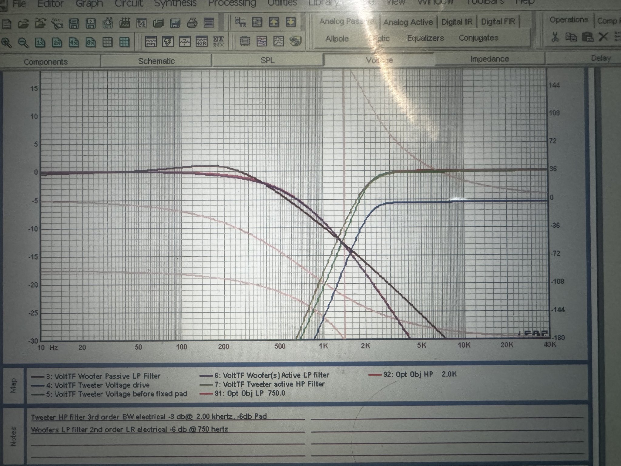

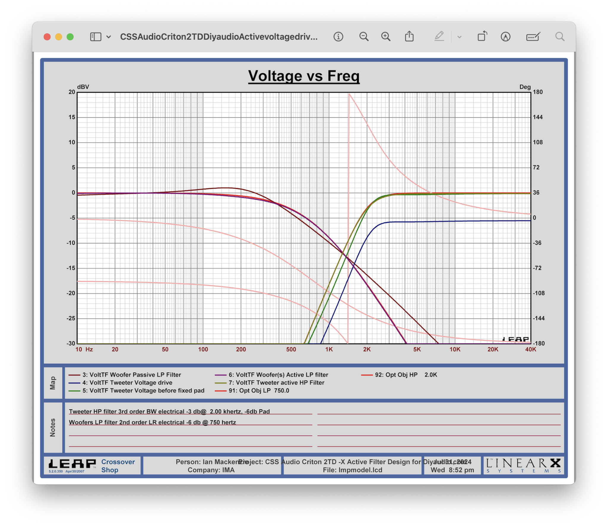

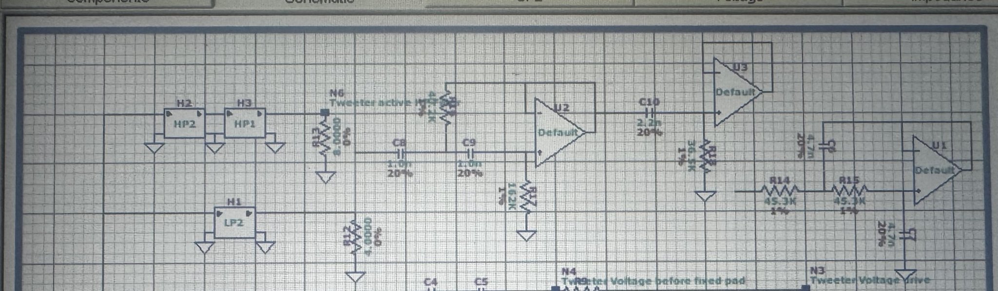

Briefly outlined below is a work flow to obtain the desired active filter design.
Obtaining first an active filter realisation of the original passive network using voltage drives was felt appropriate where the user may not yet have the means to obtain accurate indoor FR measurements.
Notes:
If the user has the means to obtain indoor measurements competently then there is no reason that an alternative active filter ie 24 db slopes could be designed (incorporating baffle step or other desired driver EQ). Less crossover region overlap generally means less vertical polar pattern irregularities. See my summary.
1. Modelling of the woofers in Leap to obtain a close approximation of the impedance curve of the CSS woofers.
2. Input of the passive schematic provided by CSS Audio for the Criton 2TD-X kit.
3. Simulation of the CSS Audio Criton 2TD-X kit schematic to obtain the passive network voltage drives for the woofer filter and tweeter filters using the impedance modelling.
4. Curve fitted Objective Target curves for the passive filter voltage drives. See notes.
5. Modelling of the active low and high pass filters to fit the Objective Target curves.
Notes:
Fortunately the Objective Target curve in the Leap Optimisation Engine for the woofer(s) voltage drive fits a 2nd order Linkwitz low pass filter with -6 db point of 750 hertz. This closely matches the passive network voltage drive.
The Objective Target curve for the tweeter voltage drive fits a 3rd order Butterworth filter with a -3 db point of 2,000 hertz.
These are voltage drive target curves not FR response target curves.
Based on the passive voltage drivers of both the tweeter and the woofer the tweeter is attenuation some 6 db in the passive network.
The woofer low pass passive filter incorporates some response shaping EQ above 750 hertz.
6. Run active filter schematic realisation for both low and high pass filter to fit the desired R resistance values including the 50K ohm trim pots. The C values provided by Leap Crossover Shop are preferred C values. This will allow the 10K ohm R values with approximate centre position of the 50K trim pots. There is more than enough trim in the pots to make for any minor variations between the passive network and the active network filters.
On the basis of the above I recommend :
The user first measure the passive Criton 2TD X system with REW as a system and the individual drivers.
Measure the drivers mounted on the baffle in free space with the passive network.
Apply the above active design and again measure with REW.
This will enable the user to consider other active crossover filters which can be designed to fit the loudspeaker system (the drivers and the baffle).
Summary
None of this is rocket science and is an appropriate routine for obtain an equivalent active filter from a passive system network.
It should be pointed out that passive network realisations are not set in stone and the adoption of alternative active filters can provide some performance improvements where a passive network is not practical.
The link below is an excellent template for anyone to fully appreciate the process of designing an active loudspeaker system.
Referring to the way in which the Jfet buffer schematic is set up only the C values are relevant in the realisation schematic from Leap which uses op amps.
I chose those R values for continuity of the pot values. The pots are there only to offer a range of crossover frequency either side of the desired crossover point .
Normally a sallen key Opamp filter uses R values of no more than 3kohms. It’s not appropriate to load these Jfet buffers with those values. A Sallen Key filter can be set up with equal or non equal values (ref Doug Self text Designing Active Filters)
The user can check the sim offers by NP to validate the working values for the kit.

As a final thought the user might eventually consider making this 2 way system a 3 way design. For example using the CCS new 6 inch mid bass driver just like their 3 way kit if he wants a better loudspeaker than the two way system. This 3 way system has superior directivity in the midrange.
https://www.css-audio.com/online-store/CSS-Criton-3TD-X-Kit-Pair-p644003321
The 3 way design could be bi amped between the woofers and the midrange with the passive network with the tweeter using the process l outlined above to obtain the response characteristics. The midrange passive network would need to be reworked as it would only be a low pass filter.
This would offer the benefit a significant improvement in dynamic performance over the passive 3 way system. A high performance amplifier could be used on the midrange and the tweeter further pushing the performance envelope. It would also reduce the cost of the 3 way passive network.

Low pass filter.
In the attached schematic from the crossover kit instructions see the custom LR 12 db low pass filter with the R value designation SLR1 and SLR2.
As the CSS Criton low pass filter has a -6 db voltage drive point at 750 hertz SLR1 and SLR2 should be 43 Kohm.
So looking at the standard crossover schematic deduct the 10kohm fixed resistor value to obtain the trim post value of 33kohms (adjusted before installation). Note here the C values must be 5nF.
Set the switches to 12 db on the low pass filter.
