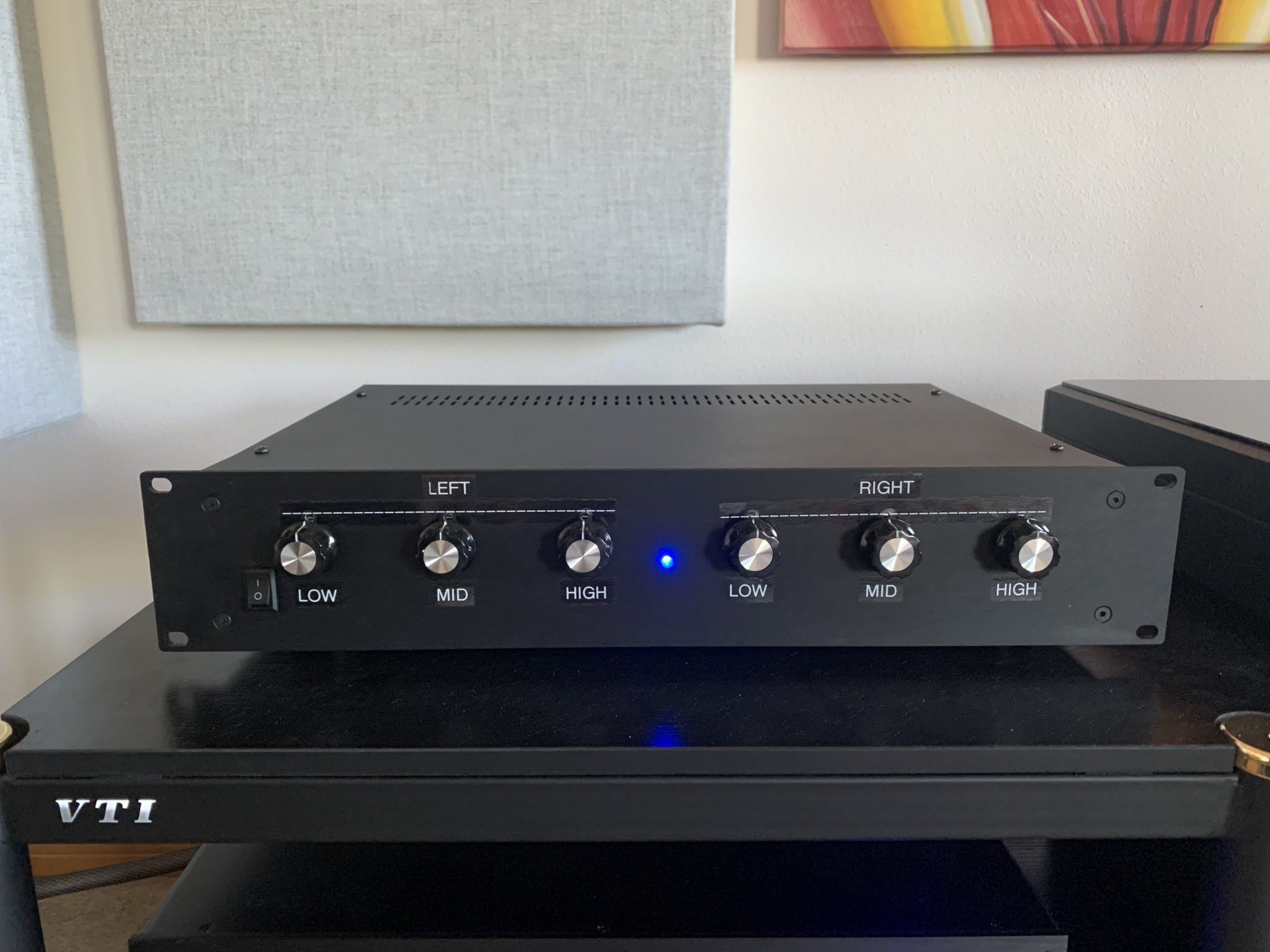

@George Ab: Waooo! That's spectacular! I'm looking forward to hear comments on the sound. I was in the process of considering the Marchand but now that I see this...
I was thinking to build the ESP P09 xover but this one is tempting.
I hope somebody can help with the following:
1. What's the input impedance? I have a tube line stage that doesn't like anything below 50K, 100K would be much better.
2. How much the PSU is critical? Would a classical LM317/LM337 regulator be enough to ensure low noise?
3. And now a final curiosity. In the past I've been really impressed with the Nelson's B1 buffer. If I had a different phono stage I would used it as my main preamp. How these buffers relate to the wonderful B1's circuit?

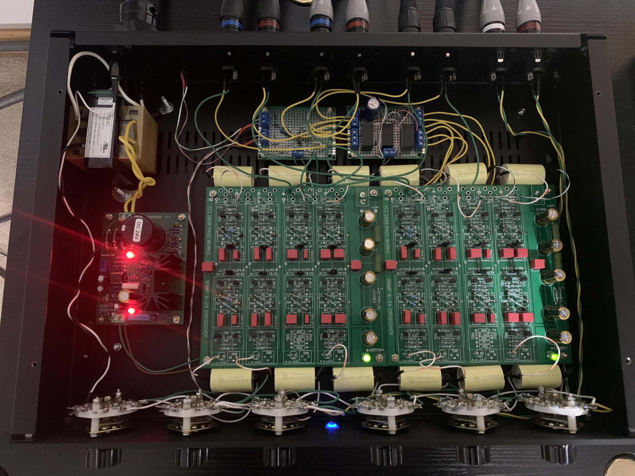

Why are mounting holes on 6-24 boards part of the ground path? I don't think I've seen that before
To give you the option of using either conductive metal mounting bolts and nuts and washers, or non-conductive nylon bolts etc.

No joy as of yet. Chasing hum, which is usually a challenge. Look at it with a scope and it adds another ground loop. Isolation xformer removes from high pass, but not band pass.... grrr... its like wack a mole. I am going to step away from this for a few day and go to my happy place of listening to music.

I need two of these boards to make a 3-way design

Yes, you will need two boards. One board for the low pass, same board's high pass filter feeds into the next low pass filter section which is set at higher frequency creating a bandpass, last section is the high pass.

Declaring victory over hum. Iso-max Jensen isolation xformer on input and I have to use shielded interconnects. I had Kimber KCAG unshielded interconnects that were inputting noise. My grounding scheme at the board level is solid, but need to do some work on areas like hooking up shield to ground to shorten ground loops, but for now I’m good.
Listening impressions: I am over the moon with this DIY active XO! IMO for apples to apples comparison the biggest improvement is going to an active xo over passive xo whatever method you use. Caveat is it is not easy getting the crossover points and slopes right and anytime you de-integrate your system by adding amps you are increasing likelihood of hum etc. With that caveat out of the way, amps directly controlling bass and mid drivers and not having to go through inductors, capacitors and resistors work well… tight control, accurate phasing, etc. In my experience even using a digital solution like a Behringer active xo or Minidsp will garner improvement over a passive xo, but as much effort and expense as most have put into sorting our digital front end hard to justify an A/D converter and multiple D/A converters after the DAC. With the Pass Labs XVR1 being out of production the best commercial solution IMO is the Marchland active XO. I do love that piece of gear. This DIY solution of a handful of unity gain FETs and no feedback is next level. What I am hearing is its excellence at what it doesn’t do, no sonic signature or smearing that can be experienced even with well implemented op amps. It performs its function divided audio frequencies to amps without adding or subtracting information from signal. Just really happy with this xo.
Still work to do. The startup delay circuit that shunts output to ground until power stabilizes still dumps voltage into amps. It just delays it when the relay kicks in. Not bad, but it trips protection circuitry of my Moon Audio amp. Easy solution is turning on amps after active xo and turning off amps before turning off active xo. I likely will remove capacitor responsible for delay and add a capacitor to 12V trigger signal to delay turning on amps. Should not be an issue when I turn off, as at turnoff when 24 decreases to approximately 19V output is shunted to ground and amps are shut down from loss of 12V trigger voltage. Will have to test to find out. Shouldn’t be hard to engineer, but for now just going to enjoy the music.
