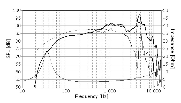

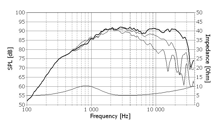

The drivers are:
SEAS W16NX-001/8 (MidBass), frequency range around 45Hz - 2500Hz
SEAS T25CF-001 (dome-tweeter), frequency range around 2000Hz - 25000Hz.
He sent me informations about the passive crossover and some SPL-graphs. I checked on the SEAS-internet-
site to get some infos about the drivers. I know the tweeter, but never used the Midbass W16NX-001/8.
I will add some pics below.

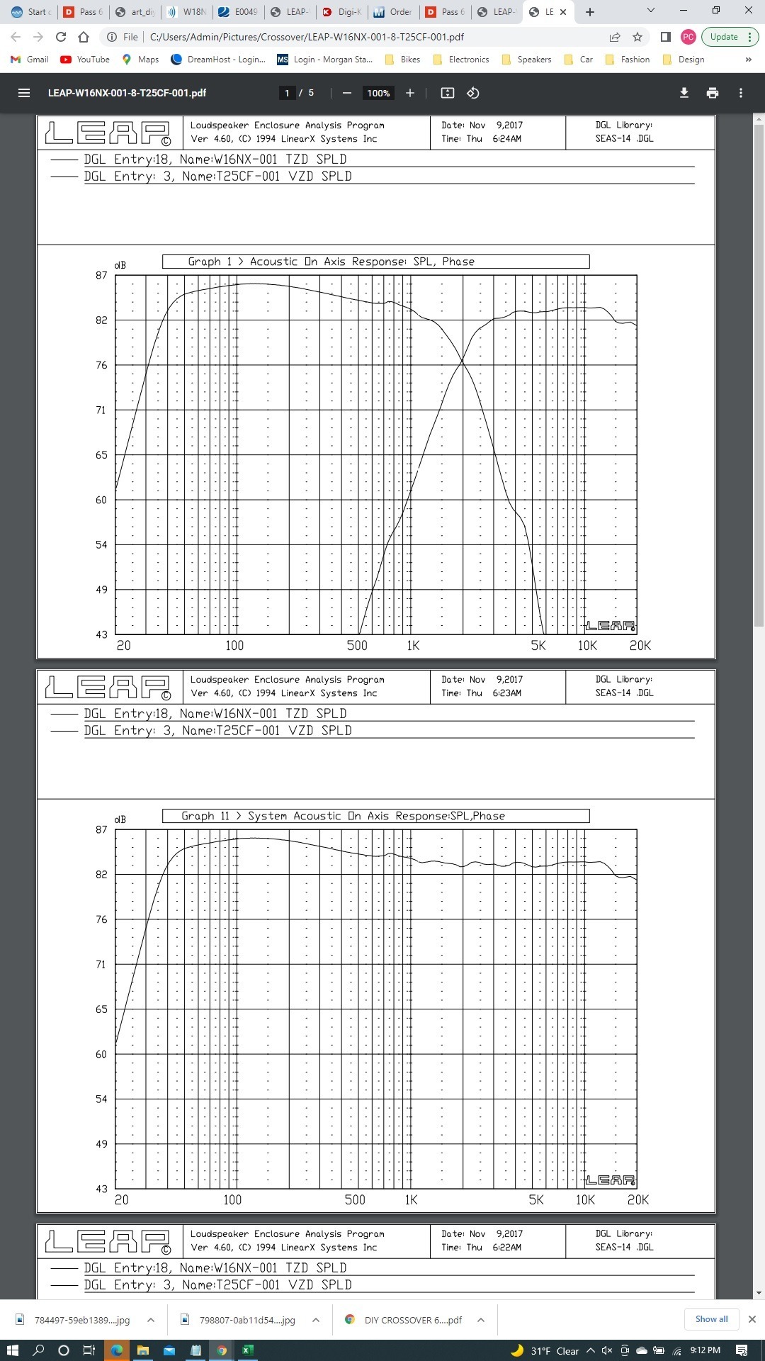

Reactions: Russellc
On the third pic you can see the summed SPL-curve with the passive crossover.
Crossover frequency is clearly at 2000 Hz.

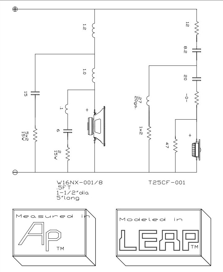

When I checked the schematic of the passive crossover, I immediately saw, that there is
some equalization in the passive crossover.
Especially the MidBass (W16NX-001/() has an 'interesting' behaviour in the upper frequency
range. This will be difficult, if not impossible to cure inside the 6-24AXO.

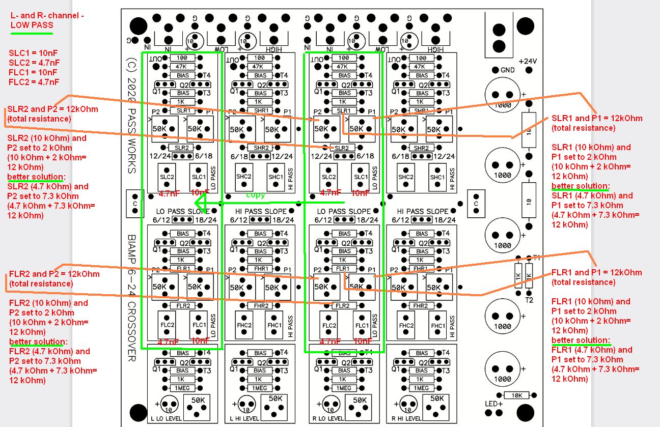

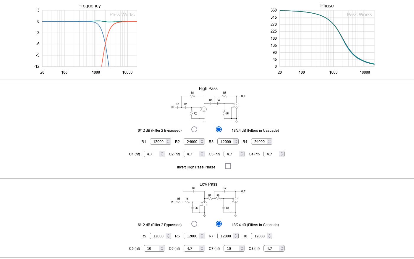

Then I started to simulate the values for Cs and Rs for a two-way-active-crossover.
I would use a 24dB/oct.- slope. Crossover-frequency at 2000 Hz.
And I had always the 'problem' in mind how to solve that roll-off in the upper frequency range
of the W16NX-001/8. Hmmm? 🤔
I made the following simulation with Mike Rothachers-calculator - ignoring the roll-off of the W16NX-001. Check pics.
Cheers
Dirk

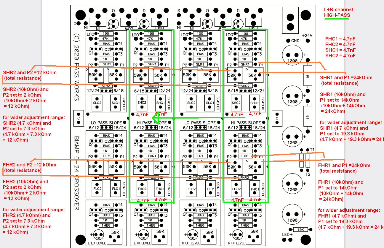

The 6-24AXO-board for the 2000Hz crossover with 24dB-slope could look like this:

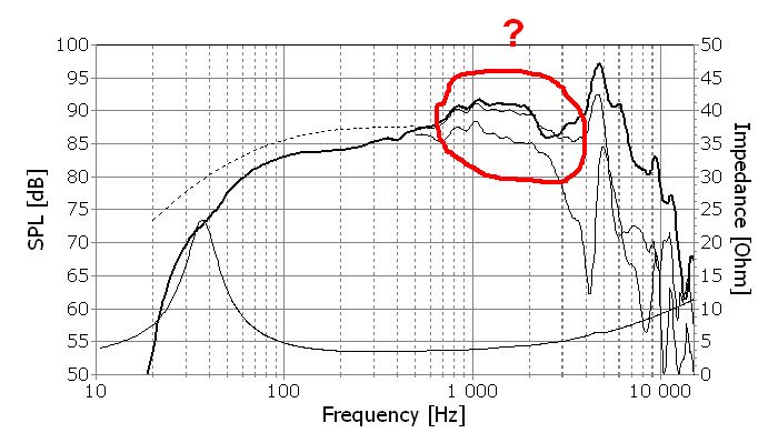

But how could we adress the problem with the roll-off of the MidBass?
Perhaps lowering the crossoverpoint of the lowpass in the 6-24AXO?
Any hints/tips are welcome! I am awaiting a good discussion. Let's have fun...

Wow. Dirk, thank you so much for putting all this into a direct perspective for me. I am digesting all this information and will complete the board as described above. Speakers sound very good as they are now but I bet there are more to discover. I will post some pictures of the speakers.
Appreciate all your knowledge and enthusiasm for good audio.
Hello PC997,
you are welcome! But you know - there will be some homework left... 😉
A lot of listening and readjusting the filters ( I think especially the upper crossover frequency of the lowpass will have to be lowered?)
If you have questions - ask. I / We will try to help.

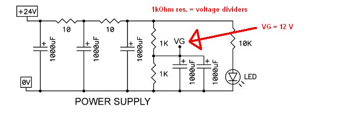

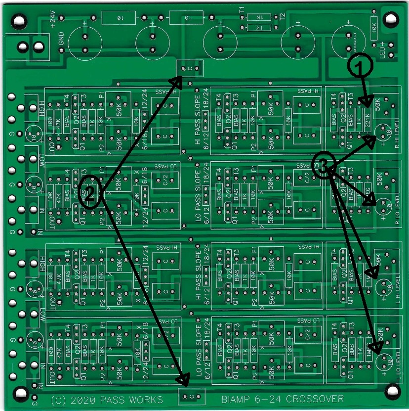

I am actually stuffing my 6/24 board, but I have three questions. Look at the image:
1. The value 221K is printed, but it should be a 1MEG resistor. Correct?
2. I cannot find these caps in the schematics. Whats the purpose? /Edit: I just see in the diyaudio Guide from 6L6: they are part of the PSU
3. These are the input caps, isn't it?
3a. In the schematics 0.1uF, Here some 10uF.
3b. is the polarisation on the PCB correct? + is connected to the 1MEG resistor to ground, minus to the potentiometers wiper connection?
Thanks for your support!
Franz
I am looking through this thread and I could find some more answers:
1. Post #180 mentionned 1MEG is correct
2. is already answered by the build guide from 6L6
3a. Post @171 Input caps
3b. not found up to now. I am quite sure the polarization is not correct when using electrolytics in this place
Franz
Hello Franz Gysi,
the input caps are 10uF (if you use polarized caps). The polarity of the input caps is correct on the pcb.
The 6-24-AXO is single ended. The music - signals '0 V - level' is shifted midway between ground and the +24 V rail (slightly below 12 V).
Cheers
Dirk
