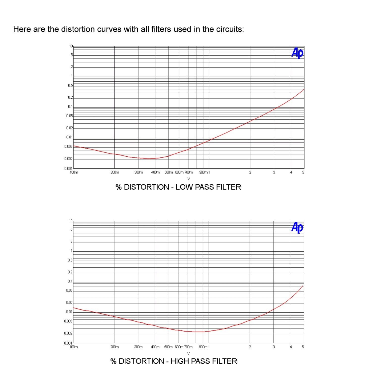

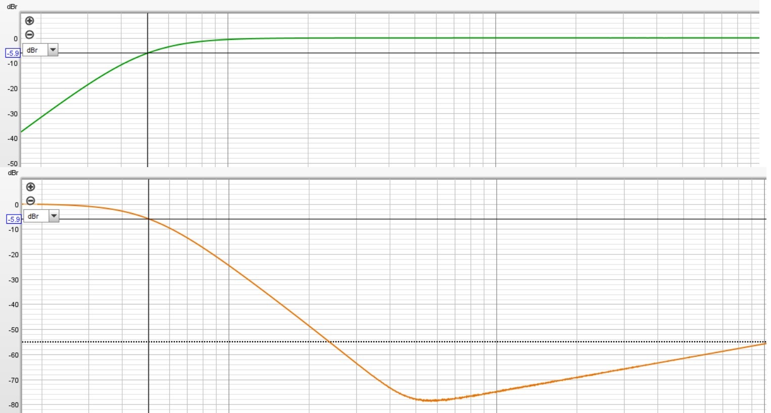

My "PassDIY 6-24XO" is set to 50Hz and LR24. Attached is the response measured with REW (using my laptop and an E-MU 0202 USB audio interface). This is the left channel, and the right is very similar (identical). The response of the low-pass section is rising above 5 - 600 Hz as can be seen. Using the 3.149 kHz testsignal (no50) from the Denon test-CD, I am able to hear a wek tone, presumably 3149. BTW the response bears some resemblance to the distortion plot for the LP filter as shown in Pa's article (page 5).

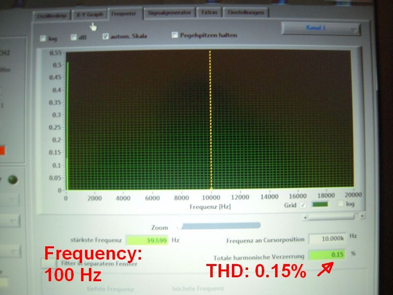

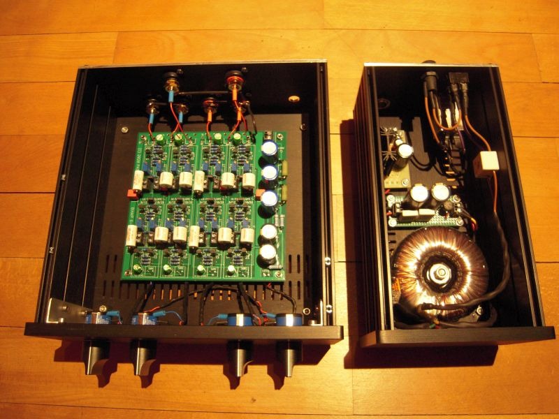

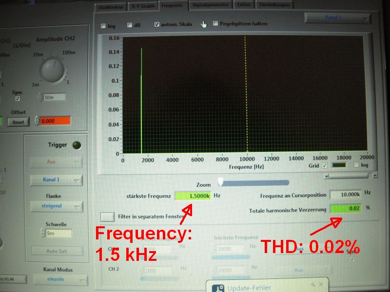

Hello DualTriode,
it is always good to have a look at the distortion of an amp or an active crossover.
I have built two versions of the 6-24-active crossover from Nelson Pass. One for the Mid-High-crossover (2000-3000 Hz) and one for the sub
(60 - 120 Hz). I am really convinced from this active crossover. It is a possibility to build an active crossover to your specific needs at an affordable
price.
The active devices used in the buffers of the 6-24-ACO are J113 (Onsemi/Fairchild). Pretty cheap and more important at the moment - available!
If you are searching for lower distortion you could try other N-channel-JFets. You could exchange them with Toshiba 2SK170 or Linear Systems LSK170.
But you would have to adjust the constant current sources in each buffer cell to the demands of these different N-JFets on your own.
Toshiba and Linear System N-JFets are available in the diyAudioStore at fair prices. Most of the offers in the internet - especially the Toshiba 2SK170-
are fakes!
I have built my two 6-24-ACOs with the matched J113 delivered in the kit. These active crossovers sound great! But it always depends on the rest of
your setup. The chain is always as good as the worst link...
And this crossover is not a project with one standard recipe. You should have some knowledge about your drivers / speakerbuilding and you will have to know
where the crossoverpoints will be. You will have to experiment with simulators to get the right values for the caps and resistor values in the filters.
This crossover has no real equalization possibilities built in!
And a last sentence: I measure also distortion - but I also trust my ears. 🎼🎶
Cheers
Dirk

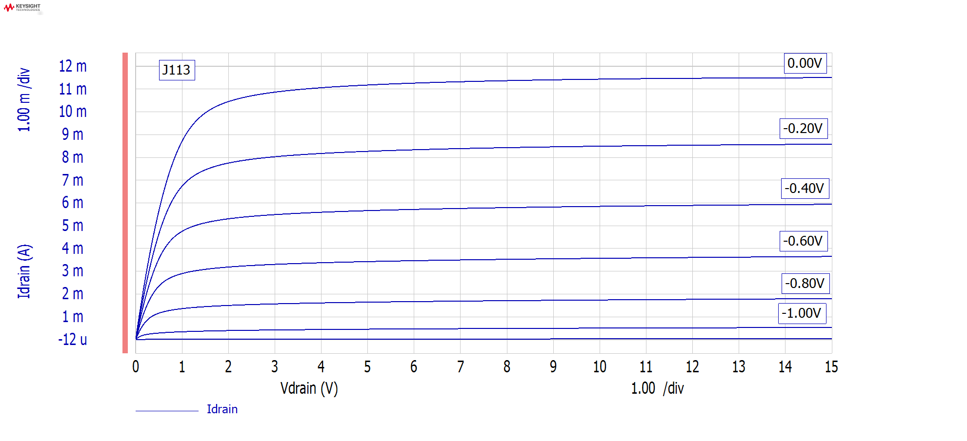

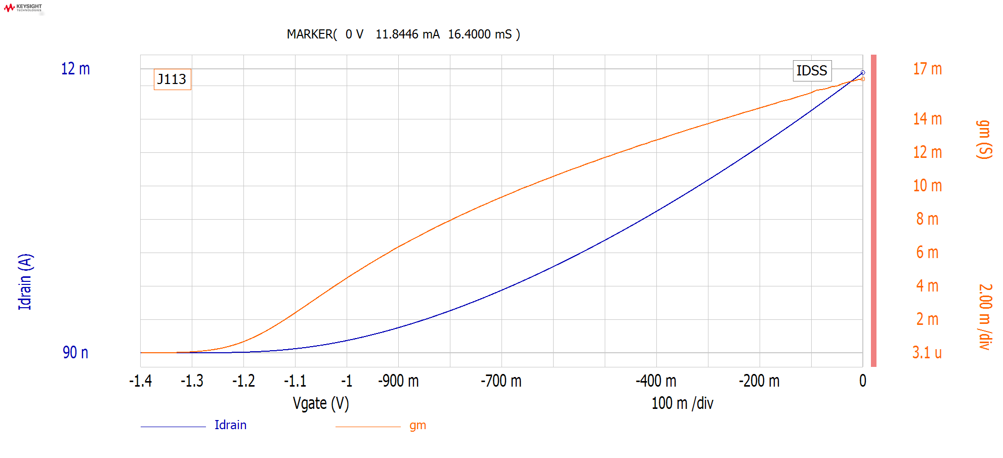

On the bench
Keysight B2912A SMU
APx555
Sample J113 plots

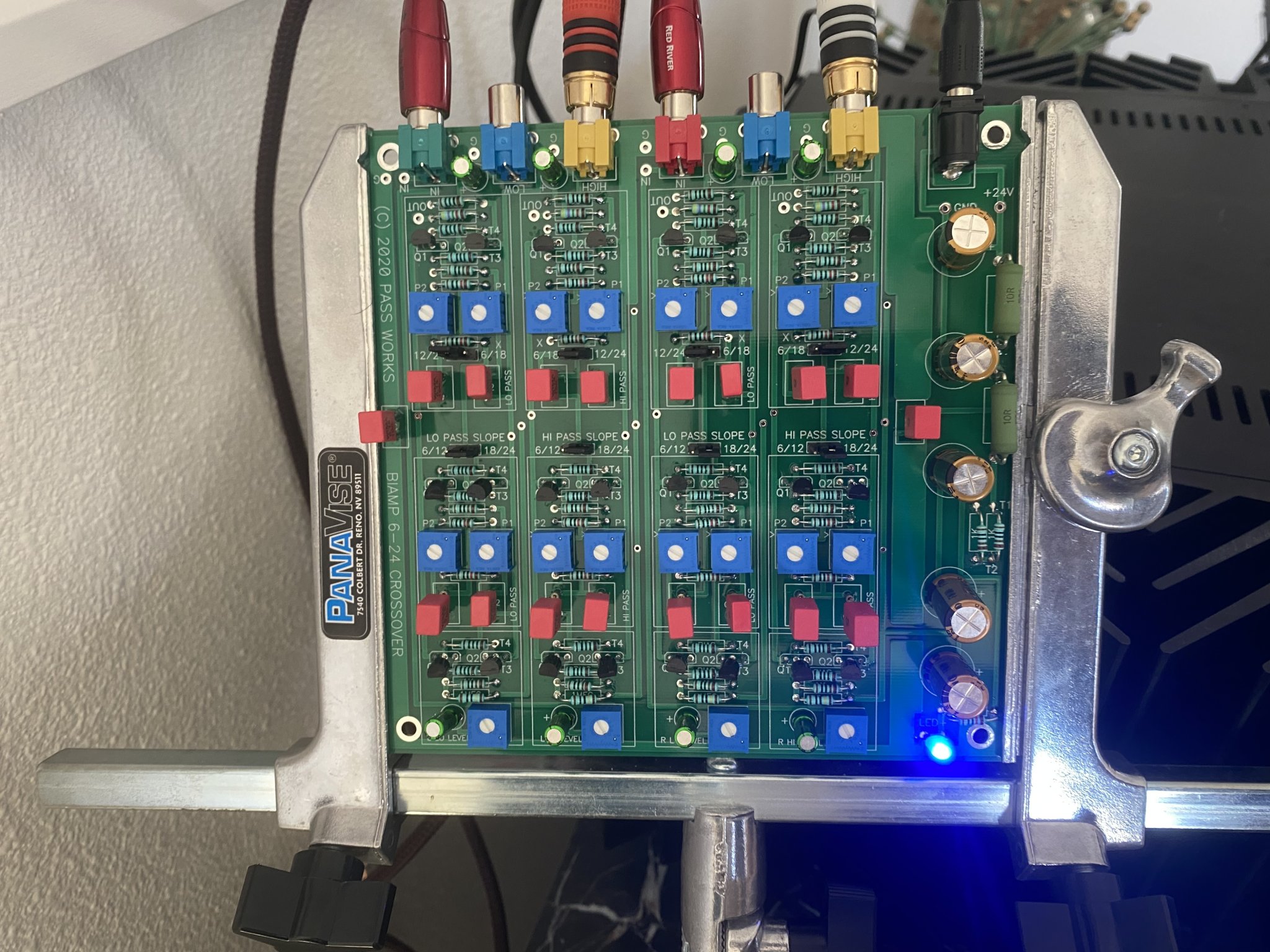

Surprisingly, I got it to work the first time. 6L6's build guide was super helpful and much appreciated. Also, I used Mr. Pass' recommendation (Post #230) to use Digikey part 116-87-210-41-006101, which made for easy swapping of the WIMA caps.
