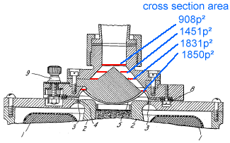

Hello Bill,
I disagree with the choice you have made in order to define the constriction.
On a cross section schematic it is difficult to estimate the total area of an annular shape (the radius to the axis have to be taken in account).
As an example, if we take the WE555 schematics, and consider 4 cross section of the ducts linking the exit to the diaphragm. (See the red lines in the attached figure)
According to your definition the constriction is more important on the lowest cross section. But now let's calculate the annular areas!
What we obtain is that the smallest annular area (908 square pixels) is obtained un the uppest cross section. We have to put the end of the compression cavity there.

Hello Bill,
That's fine. I just eyeballed it, and I could very well be wrong about the exact locations of the cross-section minima. It's the principal of how compression ratio is figured that's important.

Bill,
As a teacher, for pedagogical purposes, I often try to keep the thing I want to explain in a simple manner (KISS), but I try also to not outrageously simplify.
You'll see here attached a graph with the isopressure lines in the ducts of the WE555 coloured in green. A simple geometrical consideration will demosntrate easily that the calculation performed using the "red lines" will lead to similar results than the calculation performed using the "greeen lines" .
(Additionally I would say that for the measurement of the annular areas in square pixels I use PaintShop pro that can only give me the horizontal and vertical dimensions in pixels of the selectionned areas...)
Best regards from Paris, France
Jean-Michel Le Cléac'h
Jean-Michel,
Just a little point, but I'm still curious about why you are measuring annular area in a plane that is not normal to the direction of pressure wave travel.
Looking at the cross section of the 555, it seems to me that pressure waves are converging during their passage across the phasing plug, and their inner edges would not be coplanar with their outer edges.

Bill,
In the phase plug annulus [gpix]=[rpix]/[2^(1/2)]
WHG
Hello WHG
As the angle of the duct is not 45° from the axis, most probably it is
sqrt(height²+width²)
heigh and width being the measurements on the surrounding rectangle...
( I wonder if Bill and you are you are kidding me or are you serious?)
WHG
Pythagoras Revisited
Hello WHG

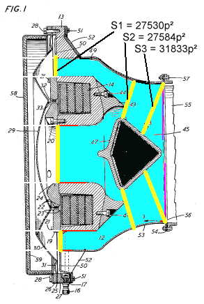

Good Morning JMMLC,
Within the granularity of the unit of measure, a pixel, either formula is sufficiently accurate.
We are all supposed to be having fun here.
Note that the area of front-center chamber of the Thuras driver is smallest nearest the diaphragm, not at the annular exit. In any event both front cavities should be modeled separately and then their outputs combined. If output upper frequency limit is kept low so that wavelengths are much larger than cavity dimensions, then standing wave modes in these cavities, both front and back, may be ignored. Only the avoidance of air-flow turbulence need be addressed in an enhanced design.
Regards
WHG
Hello WHG,
Thanks for the "good morning" even if here in Paris it is evening and I am about to get back home for dinner...(18H37mn).
You are right, in the Thuras bass driver the smallest front wave area in the ducts from the diaphragm to the throat of the horn is seen near the diaphragm.
See attached graph with 3 areas calculated.
That's why I did the remark about the 2 different aspect to consider: the low-pass filter behaviour of the compression cavity and what geometry to consider to calculate the efficiency...
Specially in the case of the Thuras bass compression driver, we cannot use a simple common geometry in order to study the 2 aspects.
Due to their shape I guess we may ignore the standing waves in the cavities.
