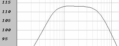

Hmm input and output data is as in the paper. Below system specified between 30Hz-300Hz with 10:1 compression ratio:
Code:
Constants
c 343.2 m/s
p0 1.29 kg/m3
Input data
Vb, Vrc 0.02 m3
Sd 0.088 m2
St, S1 0.0088 m2
fl 30 Hz
fh 300 Hz
Rin 8 Ohm
Re 6 Ohm
Output data
fc 94.9 Hz
Qtc 0.29
Qec 0.61
Qts 0.22
Qms 0.41
Qes 0.46
Vat 0.0088 m3
alfa 0.79
fs 71 Hz
Vas 0.015753696 m3
Cmd 1.34E-05 m/N
Mmd 0.3758 kg
Res 2 Ohm
Bl 28.7 Tm
n 44.6%
Vaf 5.00E-04 m3
f3 362.67 Hz
Of course such a large Mmd is impractical for 880cm Sd. Qms was too low. More likely 5 or even 9 as Hornresp suggests. I don't see any bugs between spreadsheets - just correct Sd and Fh.

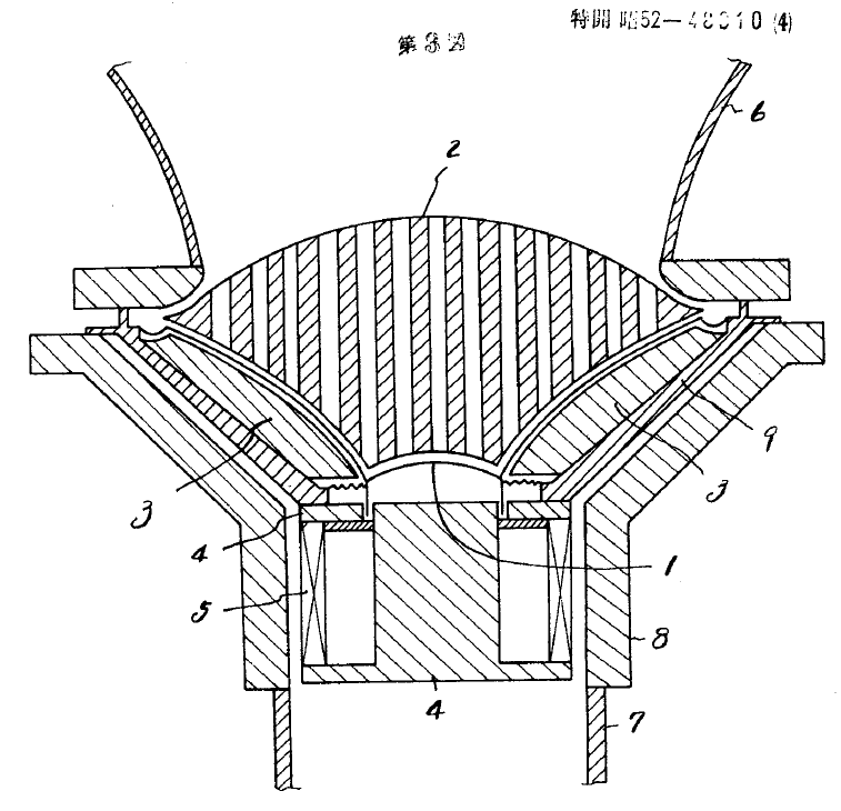

Angelo and Jack,
Thuras drawing in the patent isn´t all clear to me. The centerduct is no problem, but as I see it there are also ducts around the magnetsystem that is said to be connected to #13 with, as the text says, "a plurality of projections". This would give a realistic compressionratio of 5:1 or even 4:1.
