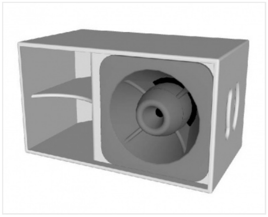

Before we go into details let me simulate "Thuras" driver.
1) Outer diameter 20"
2) VC diameter 8"
3) Optimum coil mass for 8" is 32g
4) Membrane thickness is ca. 0.1mm
5) Membrane mass is then 8.3g (plus suspension)
6) Assumed Bl is 30Tm, Re=6R.
7) Total Mmd is then 40.3g
8) Resulting Fs=53Hz and Qt=0.12 for Cms=1.6E-04 m/N
9) Optimal throat S1=210cm2 for Rg->0.
Largest domestic horn S2=18000 cm2, length 400-500cm, Hypex 0.6.

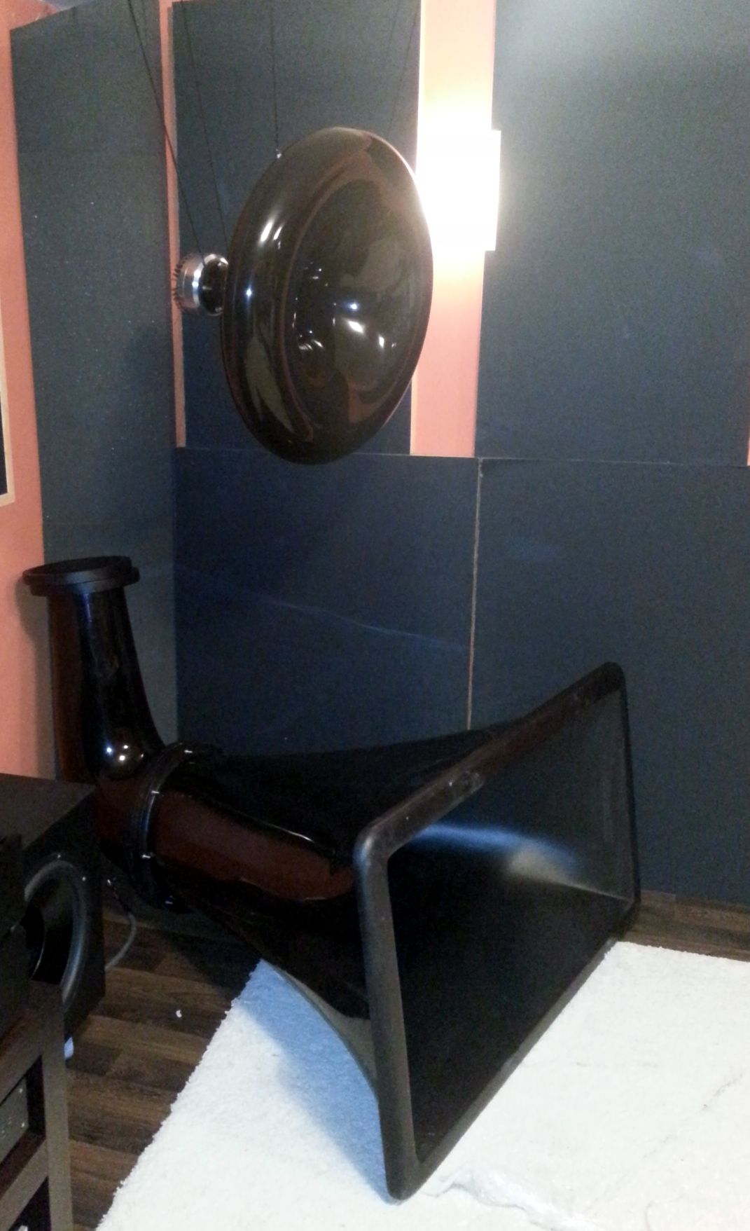

Basshorn have despite the fact of reproducing low frequencies, which are more omnidirectional, clearly perceivable directionality, which is even more perceived in small rooms. I see no advantage to use them domestically anymore. Much better use a bass array.

of course it depends as well how big the bass horn is. If you have a basshorn that has the mouth size as big and high as the entire room wall, then distribution will be even. But most common bass horns we see around have a rather small mouth exit, so the radiation angle is rather limited, and the energy of the sound waves directional in a way that can be clearly perceived. That was a reason, why i did add two 15" woofers above my basshorn, having now even vertical distribution of bass in my room.
Jean-Michel

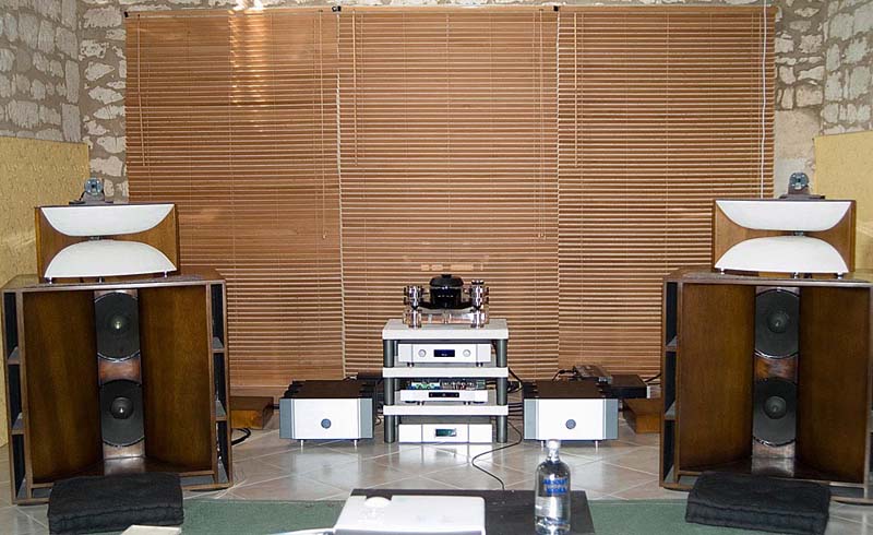

Hello Angeloitacare,
I cannot call bass horn any VOT or Altec 211, JBL4550 and such
The lowest reproduced frequencies by them being is emitted by the bass-reflex part like in that example
http://www.artec-france.com/photos/salle-ecoute-2007.jpg
and even that one (in the middle) , I don't call this bass horn!
http://www.melaudia.net/zfoto/bretagne1205/P1040088-800x450.jpg
Only the upperbass range and midbass range being emitted through the small and too short horn part.
This is what I call a bass horn (and even this is a Le Cléac'h basshorn )
http://nsm01.casimages.com/img/2009/05/17//090517055721545253677910.jpg
http://www.melaudia.net/zfoto/bretagne1205/IMG_9967-800x533.jpg
And with such true bass horns the directivity is very low...
