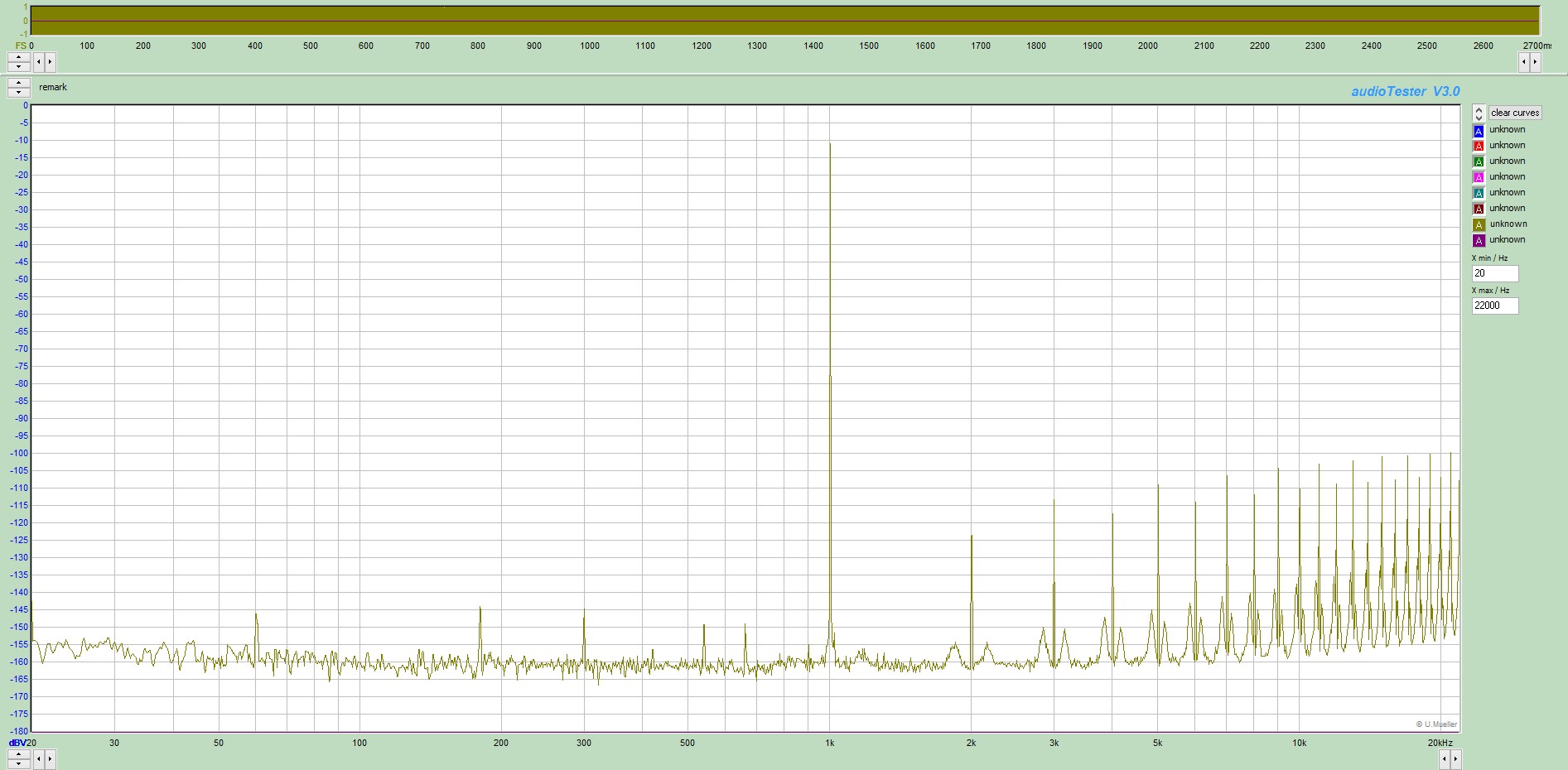

Hello,
Auto-ranging is a different creature. The RTX6001 does not have this feature. The user is forced to select the output and input voltages range best suited to the DUT at hand. Pick the incorrect output and or input selector switch position and you will get compromised results at best.
The input selector switch position is fairly straight forward. Each switch position is labeled with the maximum voltage without overload. Select the switch position that you want to use.
For audio Tester: go to options, select calibrate and enter the selected voltage scale in mv. (1.0V = 1000mv)
The output selector and output voltage is not as straight forward.
The left hand output selector position is 0.100Vrms full scale. Set the output at 0dBFS the output voltage is 0.100Vrms. Set the output at -20dBFS the output voltage is 0.010Vrms.
The center output selector position is 1Vrms full scale. Set the output at 0dBFS the output voltage is 1Vrms. Set the output at -20dBFS the output voltage is 0.100Vrms.
The right hand output selector position is 10.0Vrms full scale. Set the output at 0dBFS the output voltage is 10.0Vrms. Set the output at -20dBFS the output voltage is 1.00Vrms.
You will need a calculator or spread sheet handy to calculate between the particular dBFS value and desired output voltage. I am developing a little spreadsheet for my use. I will share it here.
If you look at the early system I and system II AP machines you can write scripts to execute programs you are talking about.
If you look at the AP APx500 SW many of the procedures you are speaking of are preprogramed in Sequence Mode.
Speaking of manual switch positions to pick switch position that you think should be okay. Practically speaking they may not work out so well. As you get closer to the 0dBFS setting the generator output distortion will dominate, it will be greater than the DUT contribution. You should do some loopback testing before trusting the results.
The only difference between the plot in post 1836 and the one below is 10dB greater output. The generator output distortion increases to a large degree.
