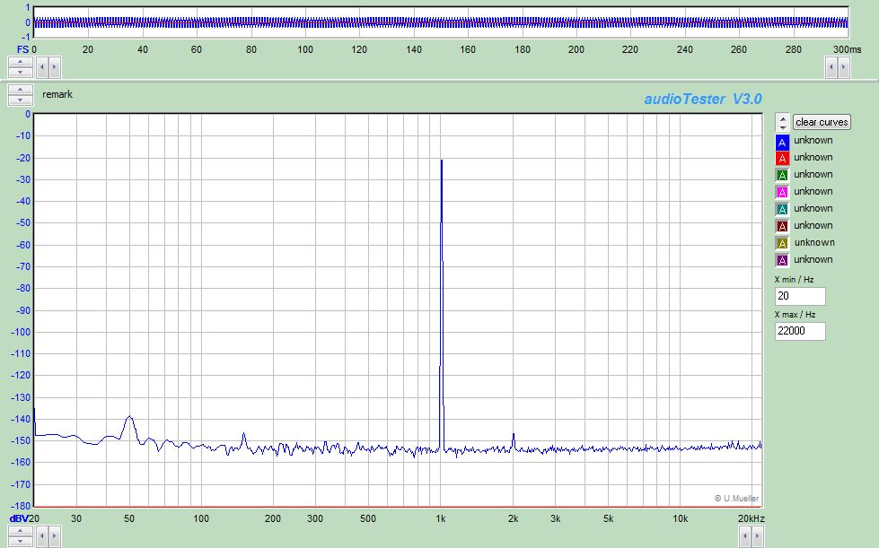

This is a sample “calibrated” balanced plot scaled in dBV.
The output switch is in the center position 1 volt, -20dBFS is selected in the steup options.
The input switch is in position #6, -10, 0.316.
Select options from the menu, click calibration and enter 316.22 mv and enter.
Sample size is 192K. 10 averages.
The computer is gen. 8, I7 8700k coffee lake.
This RTX 6001 rocks.
DT
DT

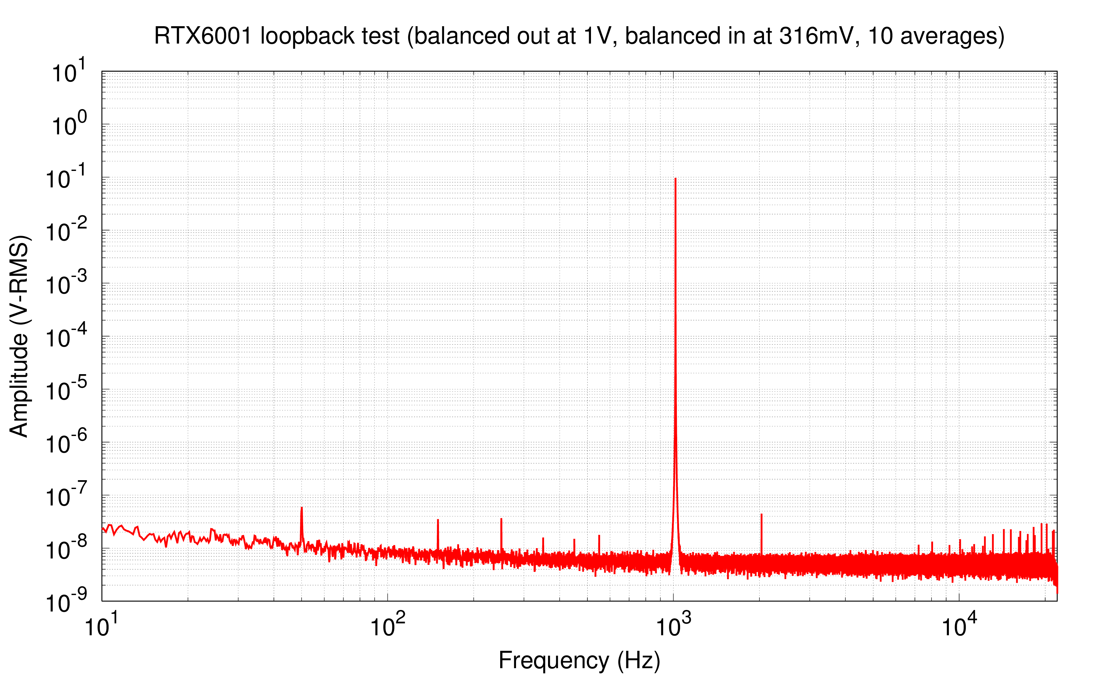

That's impressive! I actually didn't believe that mine is as good as this, so I repeated the loopback test with your settings. Wow, mine is the same!
(I should stop drooling over loopback results and get some real work done...)

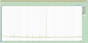

I followed your setup + vince3 Window.
Similar results...
