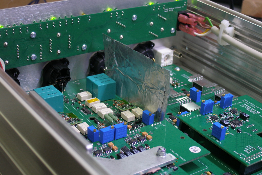

I had noticed that the left input channel has a little hum noise (50Hz) but at the right there is no any hum noise.
I decided to open the unit and make some measurements and tests about this.
I noticed that this 50Hz (hum) on the left channel is due to the proximity of the right generator to the left input.
At this area, there are some points for shielding.
Do you remember the nice shield that PaulBC has made? But, JensH had saind that there is warranty issue due temperature increase.
For this reason I did some measurements with not a closed shield but with a vertical pieces by aluminum double tape.
The hum of 50Hz will be decreased a lot of, if you put a piece of double aluminum tape between the right output and the left input.
If you set more of these tapes to the various places as the middle of the inputs and between the inputs and the ADC, the crosstalk at very low frequencies will be improved.
With that method, the temperature of this area not will increased and I think that there is no any warranty problem.

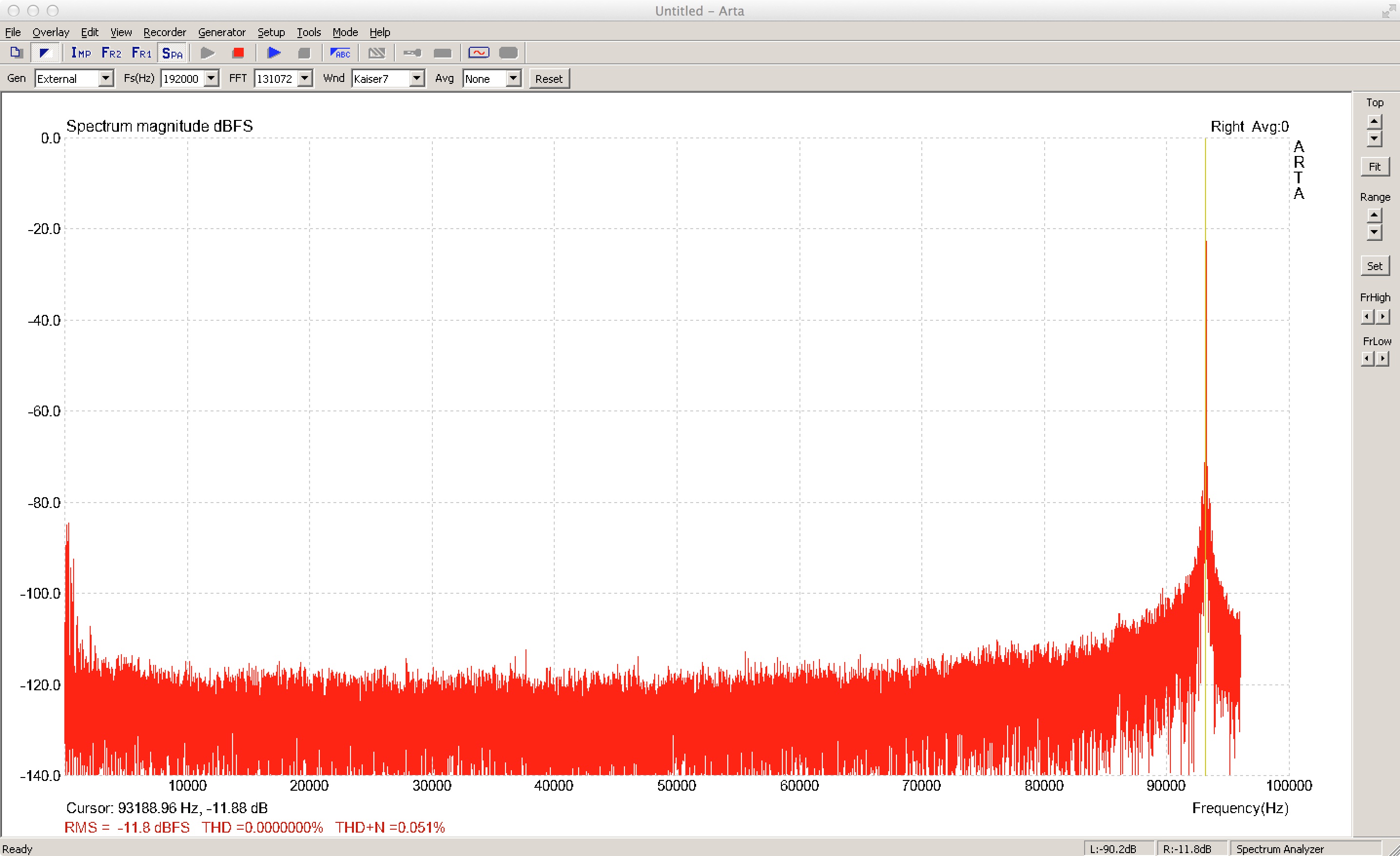

Now something else: Take a look a the pics below, same settings(-3.099dBFS, 44.1kHz, 32Bit, Window Rife-Vincent-3, average 5) the only differences are in the Analyze dialog window. Is this a bug of the SW?
It's not a bug of the software, you've instructed the software to exclude all the harmonics in the THD computations, so it ended up returning a max value defined in the software.

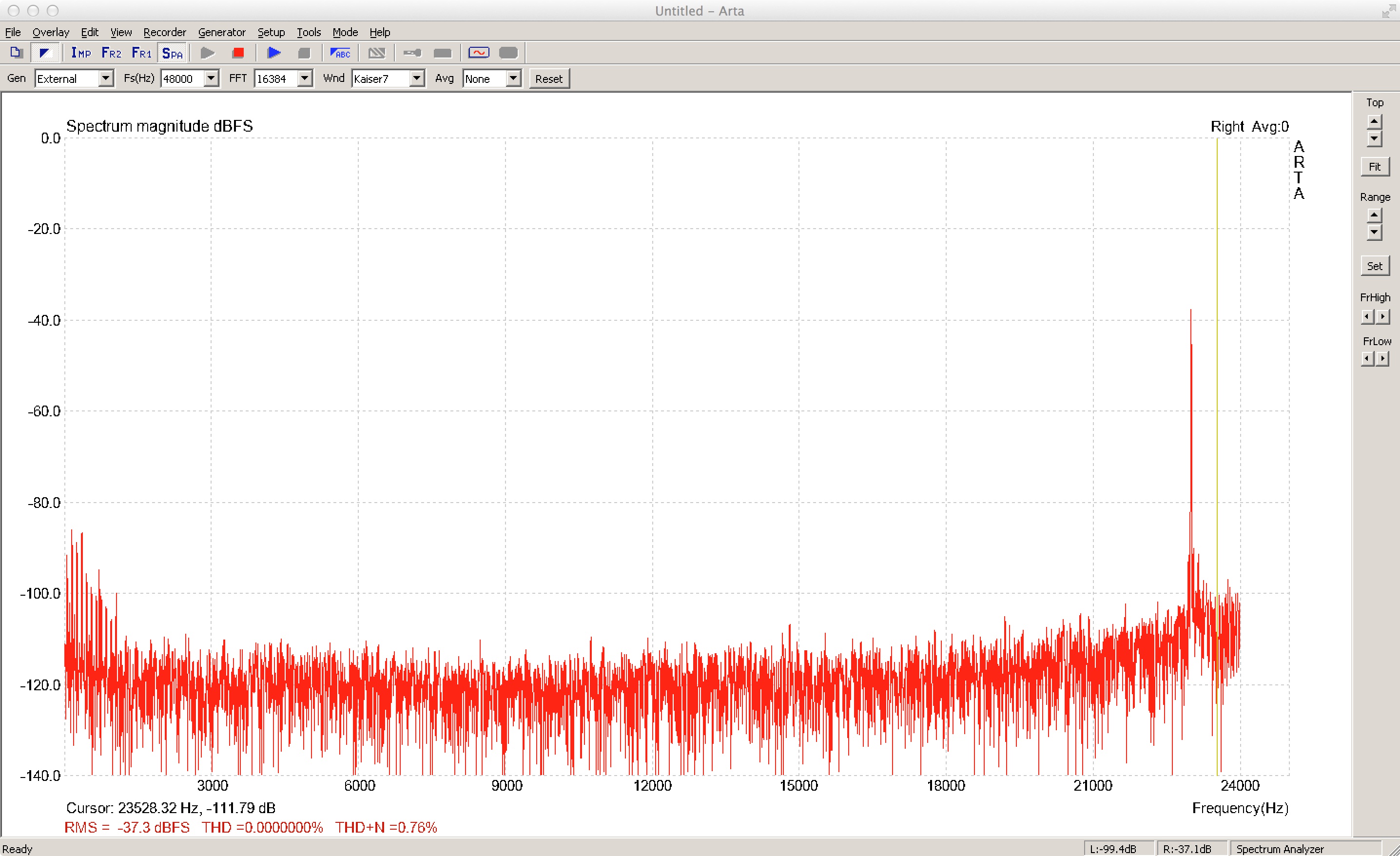

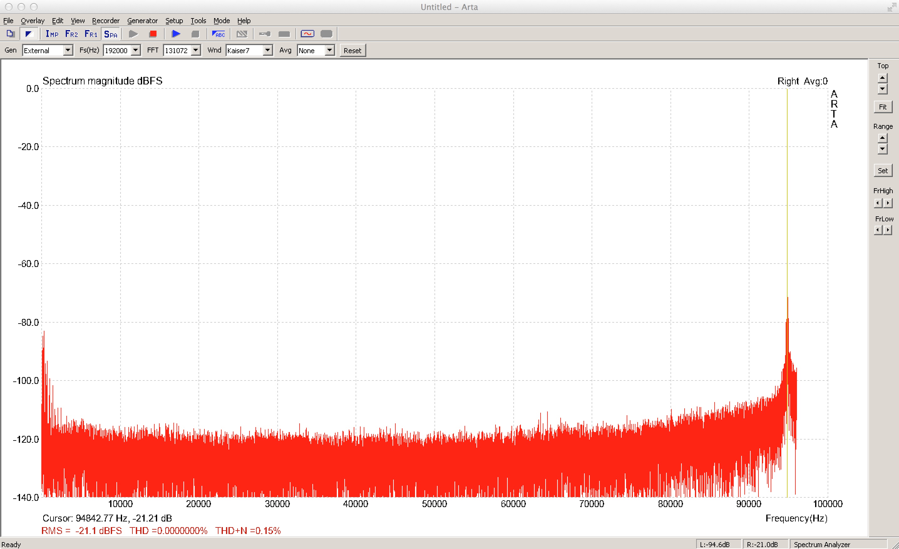

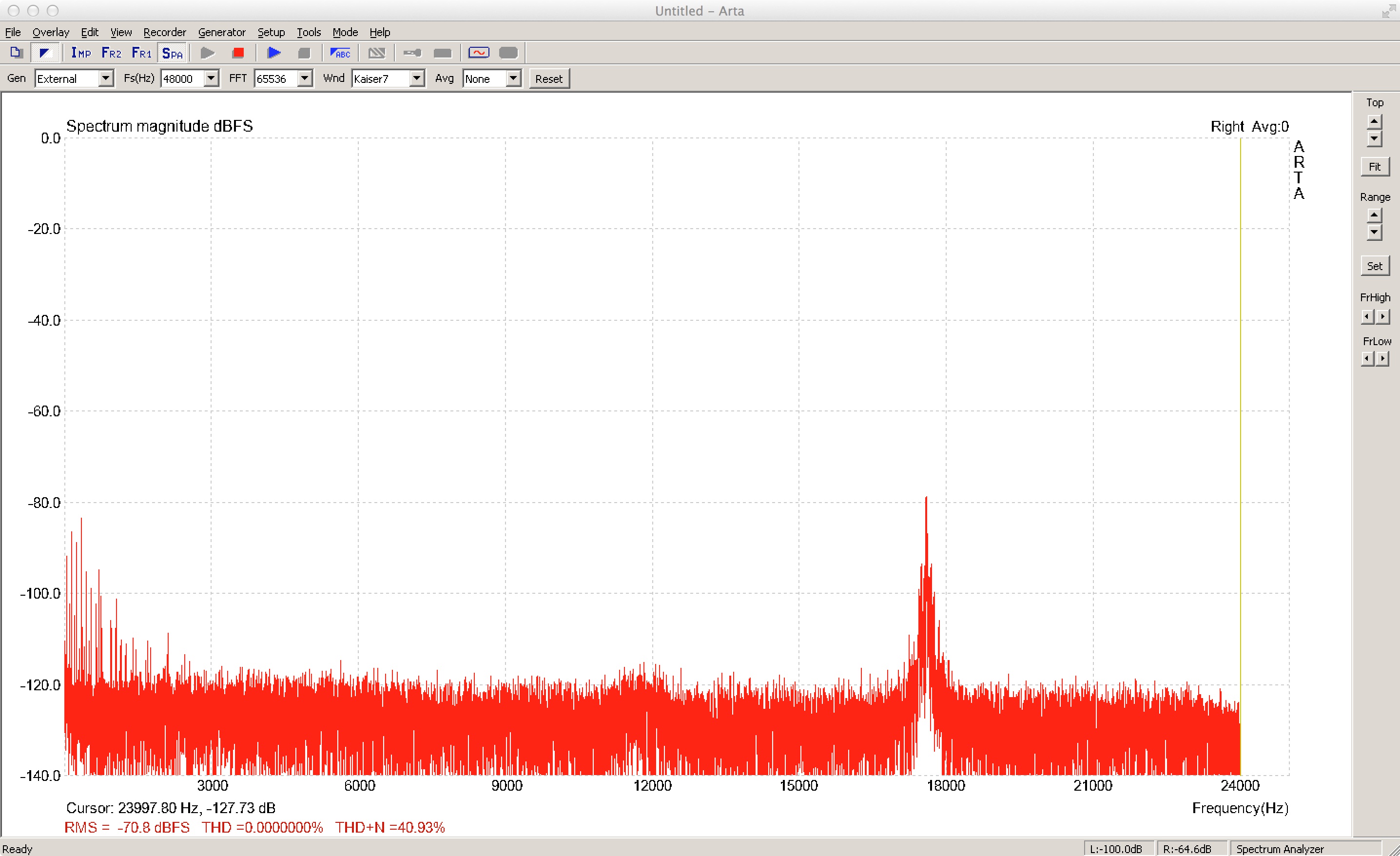

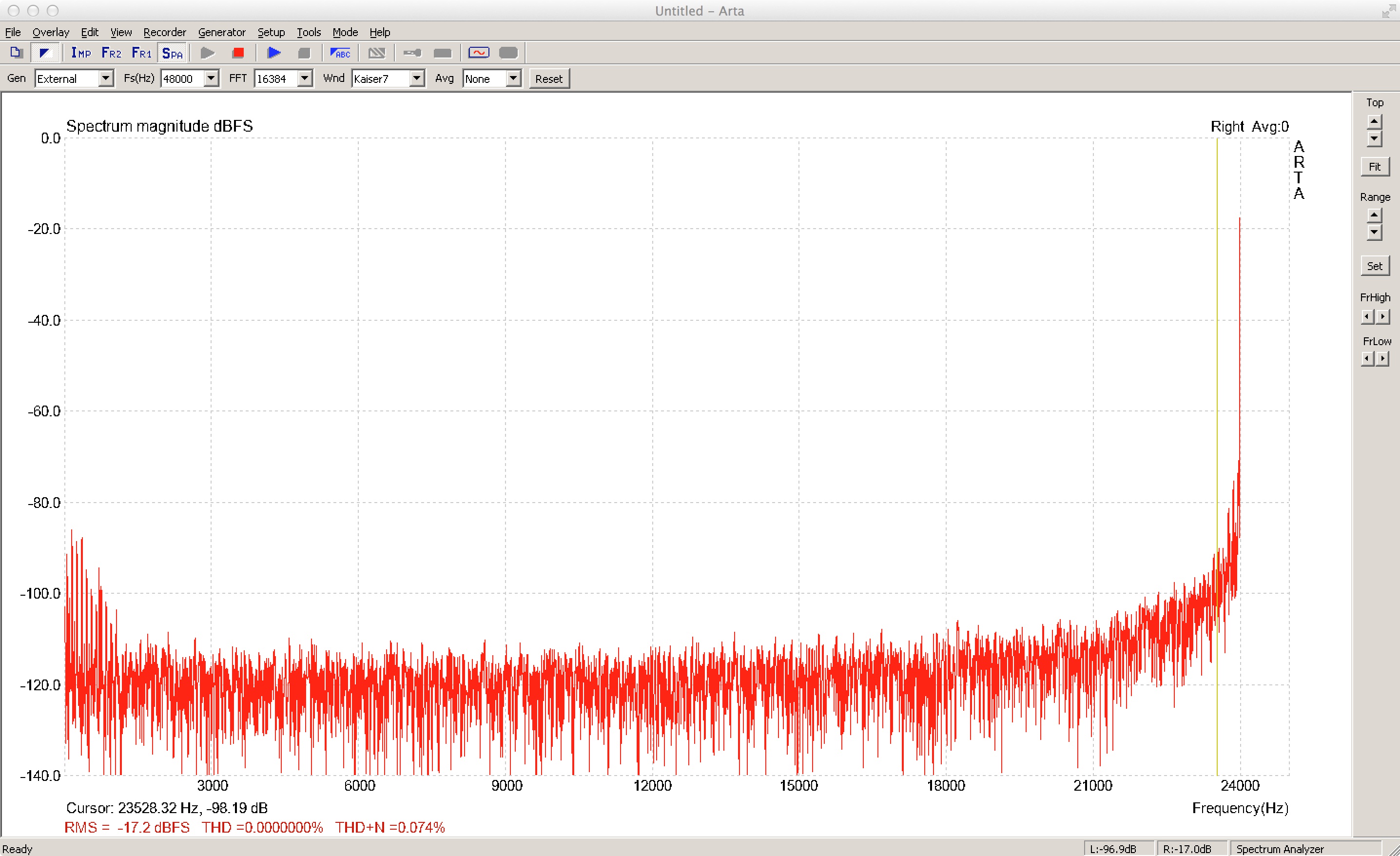

I did some experiments on the aliasing of the ADC.
The data sheet of the AK5394 says it does 128-times oversampling and has a digital low pass filter for suppressing the aliasing.
Thus for fs=48kHz sampling frequency the ADC samples internally with 6,144MHz.
Summery of the Measurements:
1. The signal level starts to drop slightly before fs/2 and we see some aliasing artifacts for frequencies slightly above fs/2 but vanishing fast.
2. For signals of about 6,144MHz we are with the aliases again in the passband of the filter and see noticeable peaks. However they are about 60dB weaker than the signal, probably due to the fact that the input stage is not meant for this frequencies.
3. For fs=192kHz we see also the first artefacts again for signals of about 6,144MHz. Thus, not surprisingly, the ADC samples always internally with 6,144MHz, only the oversampling rate drops with increasing fs.
Some pictures. The RTX 6001 input was set to 10dBV the function generator (a vintage HP8116A - thus do not expect too good signal quality) was set to 1VRMS output.
First fs=48kHz, signal roughly 23,5kHz, 24kHz,25kHz, 26kHz, 6,2Mhz (fist to last picture).
For fs=192kHz, signal roughly 93kHz, 95kHz, 97kHz, 101kHz, 6,1MHz.

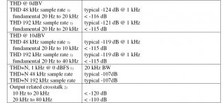

@ Jens:
On the specification page of the RTX6001 unit there were mentioned figures of THD, THD+N, seen on the attached jpg. I assume that these measurements have been taken using audio-Tester V3. Would you please define the full setup applied to the SW and the unit of receiving these results?
This technical section has measurements at two levels, 0/10dBV at 48K@1KHz but there is no any information about the signal level of gen, the FFT resolution, the Window e.t.c.
With a well pre-warm unit, I could to catch the specification only at 10dBV, 48KHz@1KHz but with -10dBFS signal gen (131K, Kaizer7) with ARTA. Almost 0.000089% at the left or right channel (mono).
This meaning that a level of -121dB has achieved vs -119dB of typical.
I had the same level of -121dB and with 0dBV (the rest same like before), I was -3dB under from the -124dB of typical.
