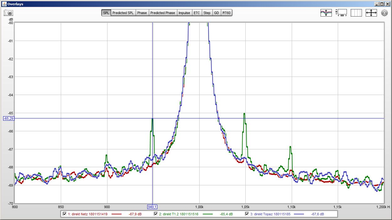

Did some loopback test in various 230V configurations to get rid off the mains peaks:
Too small audiophile transformer (Stein T1 MKII; some 30-50 VA, I guess) brings side line at mains frequency (50Hz) appart from the carrier:
attachment.php
A 500VA Topaz noise isolation transformer performs much better in that aspect.
attachment.php
Reduction of mains peaks was surprisingly low:
attachment.php

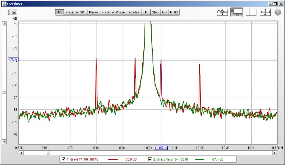

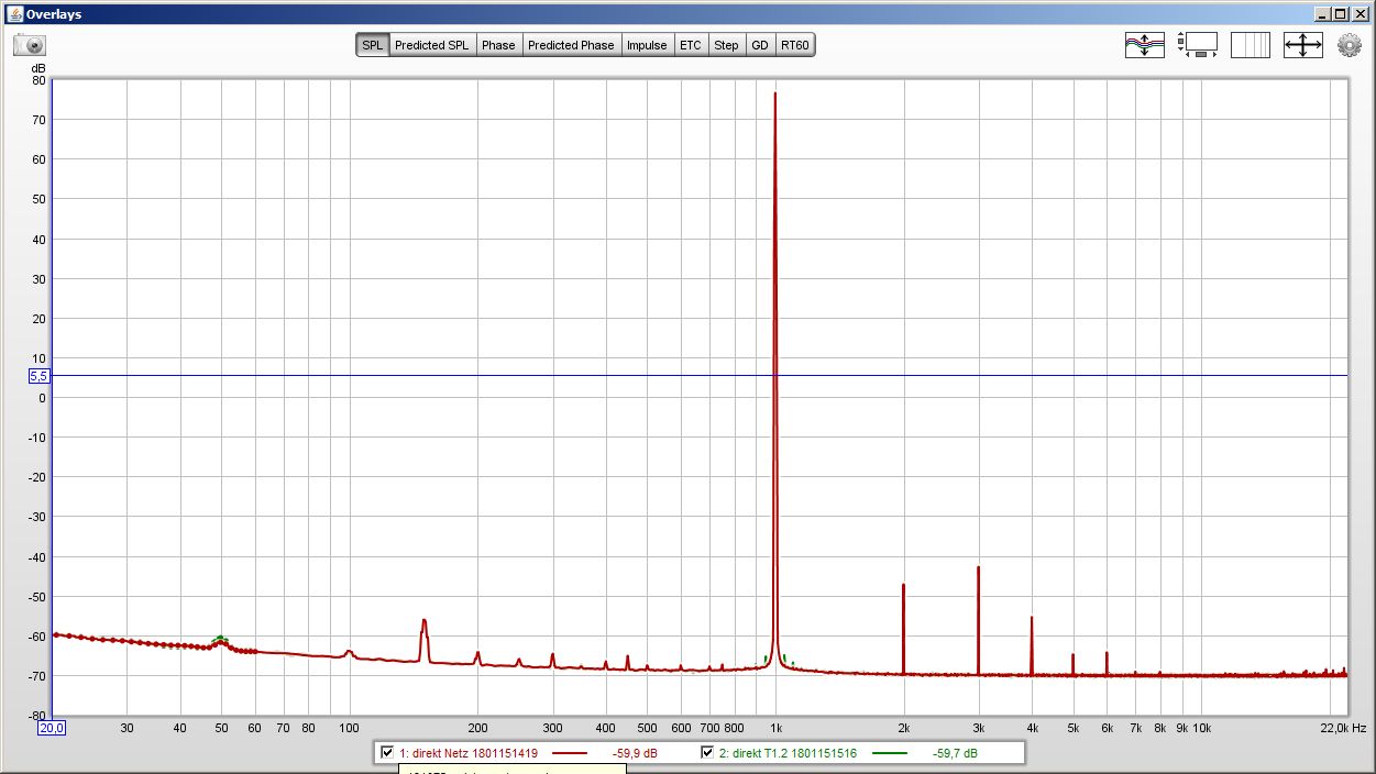

It depends 😉
attachment.php
attachment.php
attachment.php
Why would an isolation transformer be useful in a loopback test? There is no ground loop, because there is no DUT with a safety earth connection involved in loopback test.
Can you try your isolation transformer(s) with a DUT that connects its GND to safety earth?
