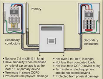

Yes without fault protection we are talking about arcing faults. Assume a fault occurs in the 20 amp circuit. Once the arc is initiated inside the panel the arc blast is current limited only by the upstream conductors and devices.
The tap rules are all about protecting upstream conductors and transformers.
The attached graphic is from the link.
Feeder and Transformer Secondary Tap Conductors | IAEI Magazine

I'm not sure we are. This last post has nothing to do with ground fault protection. Introducing the 'tap rule' is also not relevant to the discussion thus far. Tap rule has nothing to do with arc flash and nothing to do with protecting the upstream transformer.
Arc flash has nothing to do with ground fault, so much so IEEE rejects the use of ground fault characteristics to calculate arc flash incident energy. I think you are getting confused on your terminology.

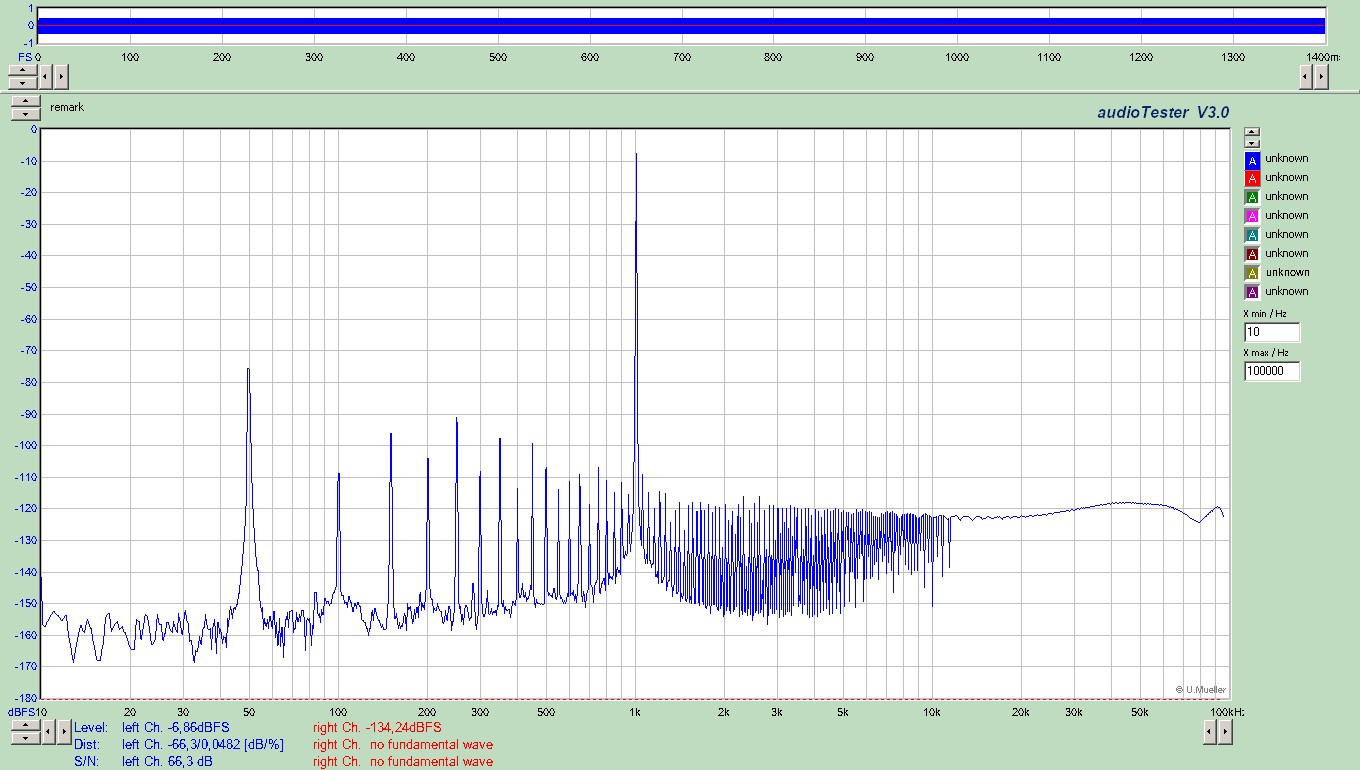

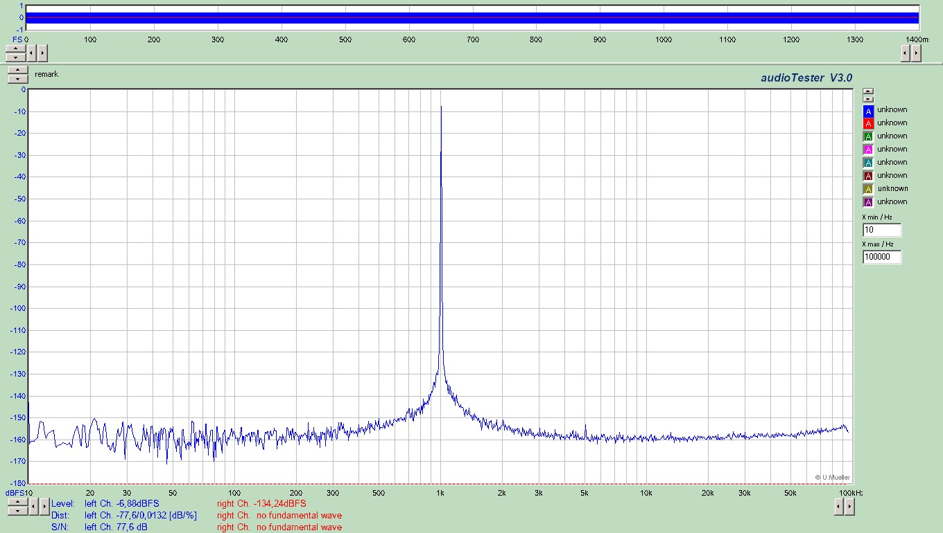

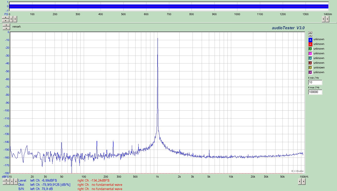

Here some pictures of measurements, with different cables, of the Victor generator, powered by an (two pin) plug in power supply - thus floating. This power supply is an older one with transformer and linear regulators.
The RTX6001 was set to 10dBV. AudioTester was set to van Hann window, FFT length 2^19, averaging 3. No averaging did not look much different.
First picture; differential connection (as the suggested no 17 of...) with a separate connection RTX ground connector, Victor ground connector.

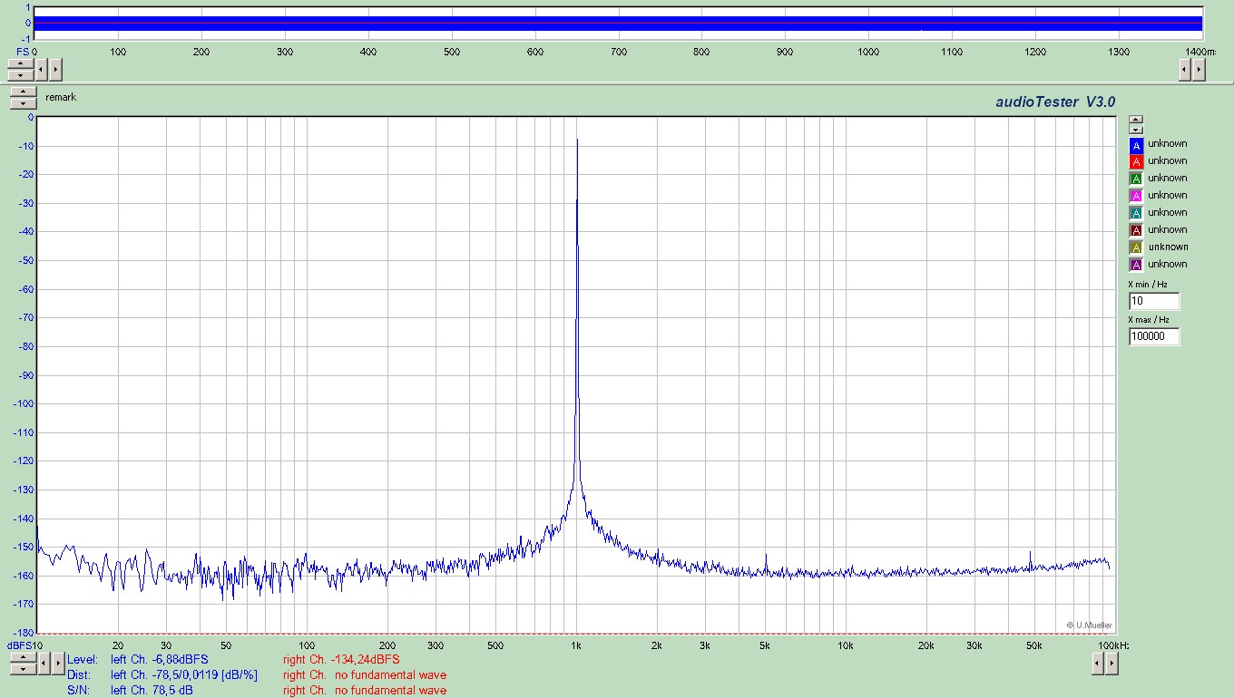

Second picture; The same as above, without the ground connection 😉
Third picture; Using a commercial XLR-BNC connector (XLR Pin 1 and 3 shorted), with the additional ground connection.
Fourth picture: The same as above without the additional ground connection - and no, I did not mixed up the pictures.
Fifth picture: A differential connection were pin 2,3 are connected with an 1k resistor to pin 1, as suggested by Demian here post5270704 (without the additional ground connection - as this would not make much sense, I think). The output power is slightly reduced due to the resistors.

Thanks for this! Number 1 and 4 are very clean overall, don't show any mains hum. Lesson learned: use exactly one GND connection, avoid ground loops 🙂
Avoiding ground loops is usually not too difficult if there is only one safety earth connection (usually the one at the RTX). I am currently messing around with situations where the DUT also has a safety earth connection, so there are two GND connections between the DUT and the RTX. It seems to me like it's sometimes easier to live with the ground loop than trying to beak it, and adding a third GND connection in the form of a thick, short wire between the DUT and RTX chassis sometimes actually reduces the hum+noise. Maybe I'll post a few measurements later.

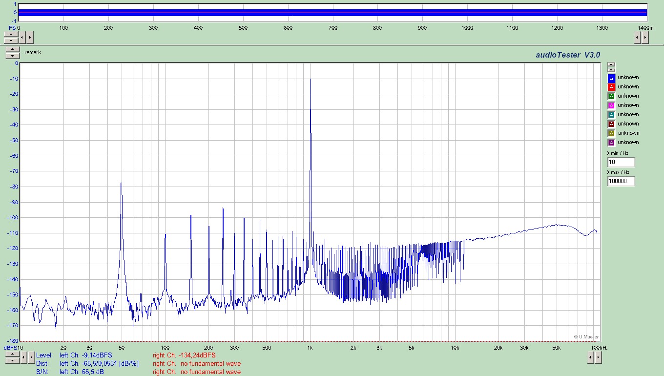

@zfe
The distortion numbers look strange. In the first measurement the distortion is shown as -78.5. The signal is at -6.88 dBFS, the second harmonic is around -150 dBFS, the 5th harmonic is slightly lower and the noise floor is close to -160 dBFS. So where did the -78.5 dB come from? Is there a problem with the window type or other settings?
For the moment I was only interested in the diagram.
As the distortion number is almost the same as the S/N almost all should come from noise.
With that FFT size we have 2^18 bins we have a total noise of about 54dB above the displayed floor, the signal is about -7dB. So over the thumb that would be about 90dB S/N. That is still better than the displayed value but not "enormously".
I check tomorrow the settings and see if I get reasonable values.

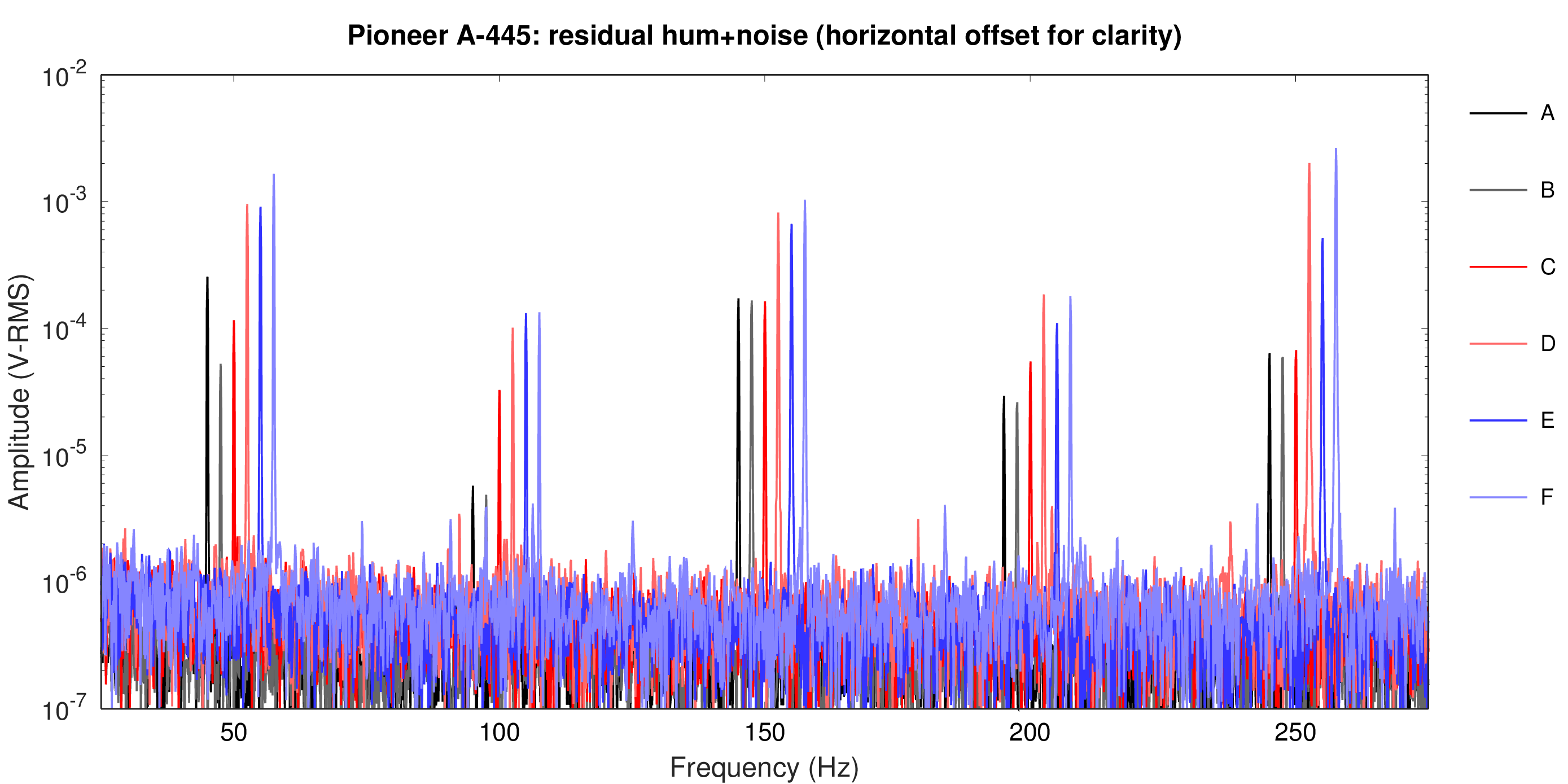

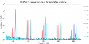

I made a few more measurements with two other amplifiers. One was a FirstWatt F5 (built on NP's kitchen table) and a Pioneer A-445 integrated. The F5 has a three-prong mains connector, the Pioneer a two-prong. The F5 has a ground loop breaker between the audio GND and chassis (12 Ohm or so).
The software was set to output "silence" at the RTX. The RTX output range was set to 1V, the input range was set to 10V.
All measurements were made with an 8 Ohm speaker dummy load, with the RTX input connected across this dummy (XLR pins 2 and 3, pin 1 not connected).
The amplifer RCA inputs were connected in different ways:
A: amplifier input shortened (not connected to RTX)
B: like A, but with an additional thick, short wire between the RTX and amplifier chassis
C: RTX BNC to amplifier RCA input at amplifier
D: like C, but with additional wire between RTX and amplifier chassis
E: RTX XLR-to-RCA adapter to RCA input at amplifier
F: like E, but with additional wire between RTX and amplifier chassis
G: RTX balanced to RCA input at amplifier (Rane No 6, or No 13 backwards)
H: like G, but with additional wire between RTX and amplifier chassis
The idea of the additional wire connecting the RTX and amp chassis was to provide a solid GND reference for the Pioneer amp (two prong) for the Rane No 6 setups. However, the G and H setups resulted in oscillations with the Pioneer amp, so I only measured the F5 in these setups.
In general, the BNC connection without the additional connection between the chassis (setup C) gave the best results after the shortened amp input (A or B).
Questions:
- These somewhat more systematic measurements show that the BNC connection (C) tends to give less noise than the XLR-to-BNC adapter (E). I thought the XLR-to-RCA adapter gives the same connections as the BNC out. Why are the results different (both with F5 and Pioneer)?
- Setup G avoids the ground loop with the F5 amp, so I expected this would give the lowest noise. The measurements show the opposite. Why?
- In setup H, the additional wire between the RTX and amp chassis basically defeats the ground loop breaker in the amp. Why does that give lower noise?
@zfe

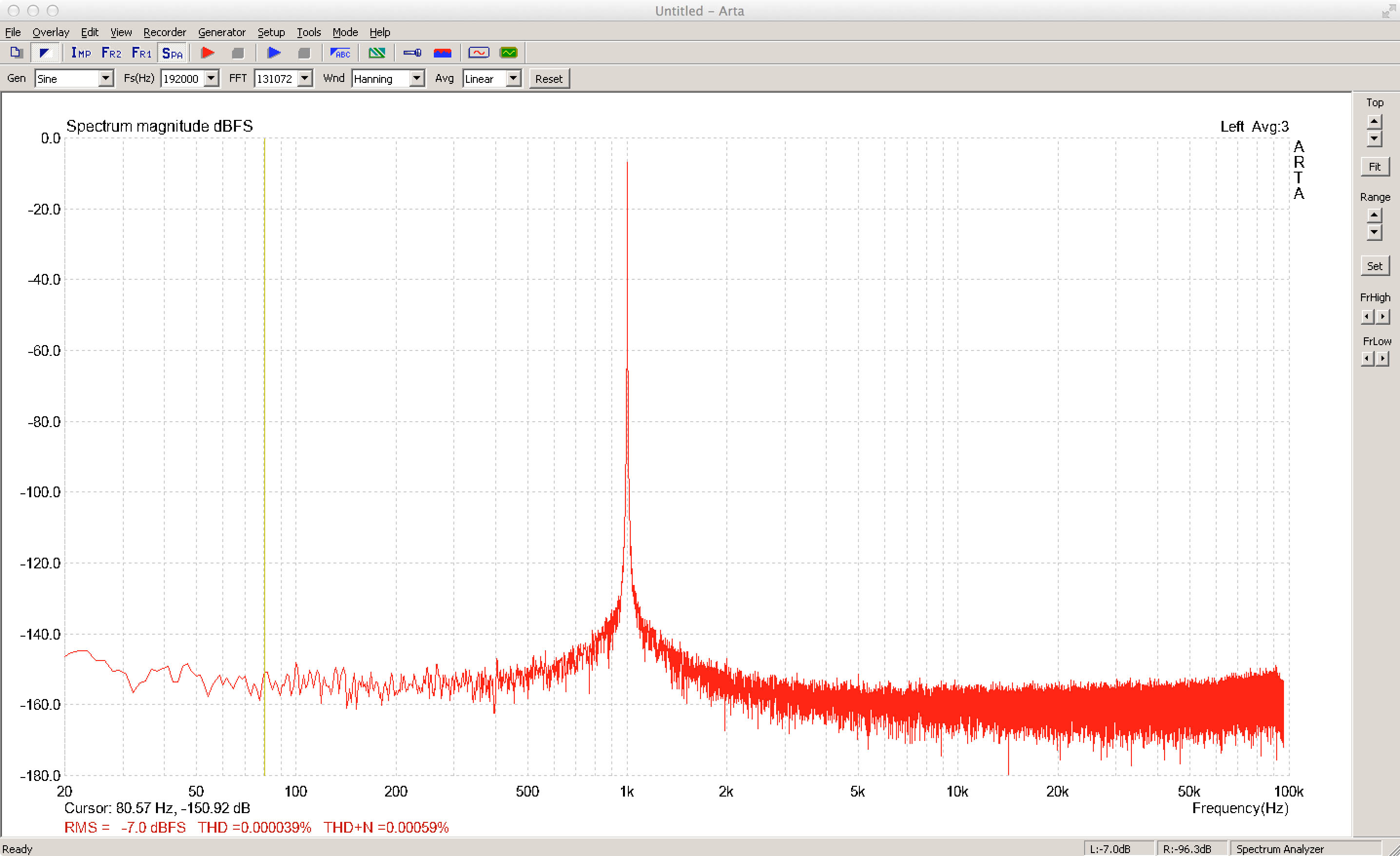

Here is the same measurement with Arta, which reports about 105dB THD+N.
Playing around with AudioTester I think the reason for the lower value is that the fundamental of the victor generator is quite wide and at some point the "fundamental" is counted as noise. Arta seems to have a different threshold. One indicator, with AudioTester, is that if I limit the bandwidth, taken into account for the distortion, is reduced to +- a few Hz around 1000Hz I get still a value around 70dB.
Is there some norm or setting where the fundamental ends an noise begins?

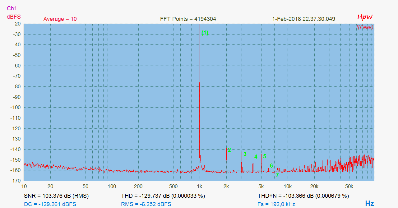

Here you deal with the various SW tools behavior or possible configurable settings of those. 😀
On LDO, you get a wide noise bell and would like to skip/get ride of the THD & SNR calculation. With the danger to ignore/skip any spurious/artifacts closed to the fundamental for the SFDR calculation.
I could happy setup such required setup using my licensed HpW Works SW.😎

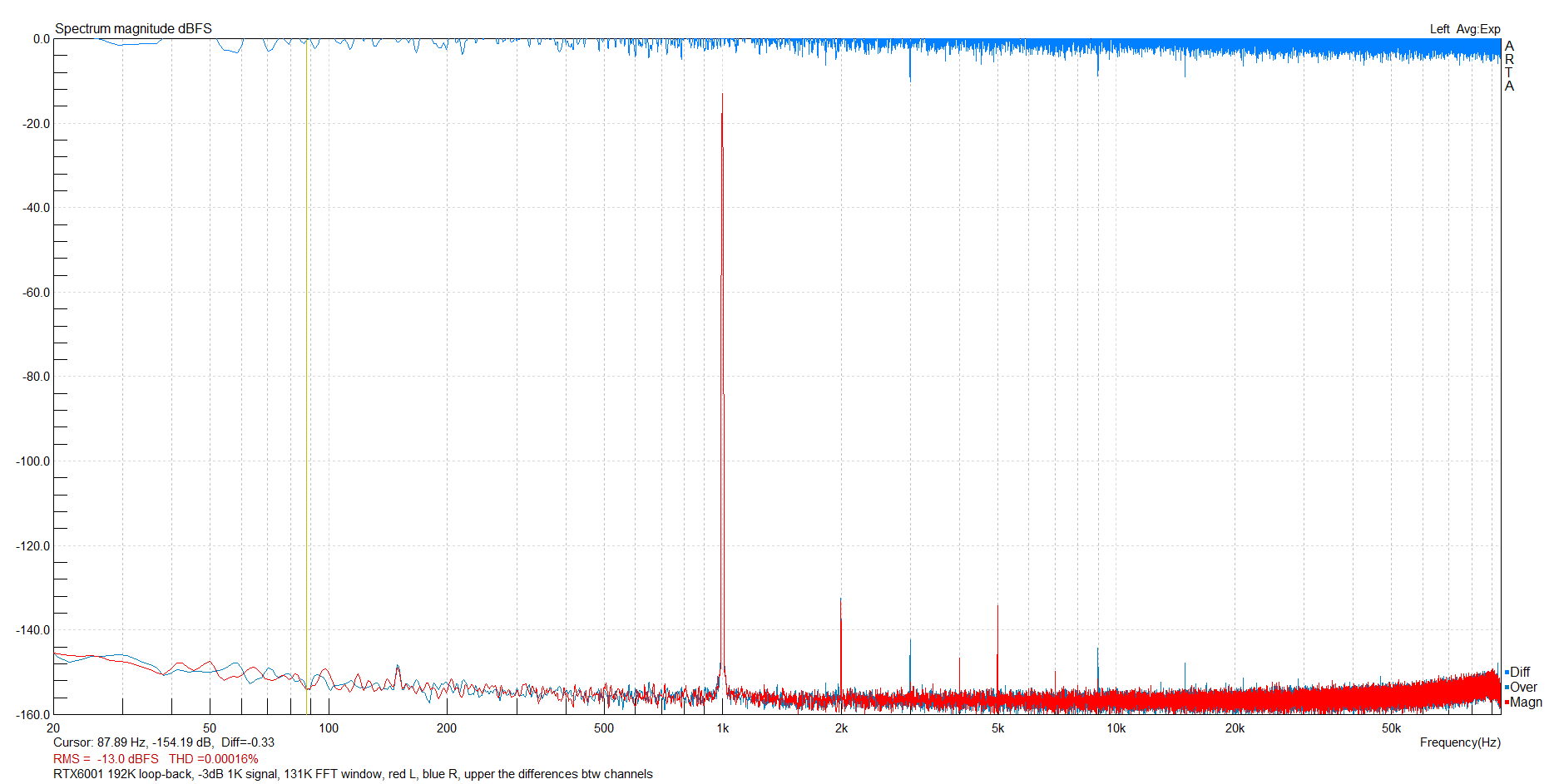

Here a loop-back 192K test in ARTA with 131K FFT window.
Red is left channel, Blue is right channel, the upper is the difference btw thw two channels.
The THD result is lower than Joseph K., perhaps due to different FFT Spectrum Software or FFT wnd (131K vs 530K).
Better results, I have with the 44K capture.
JensH, you have made a marvelous job with the RTX, my congrats.
