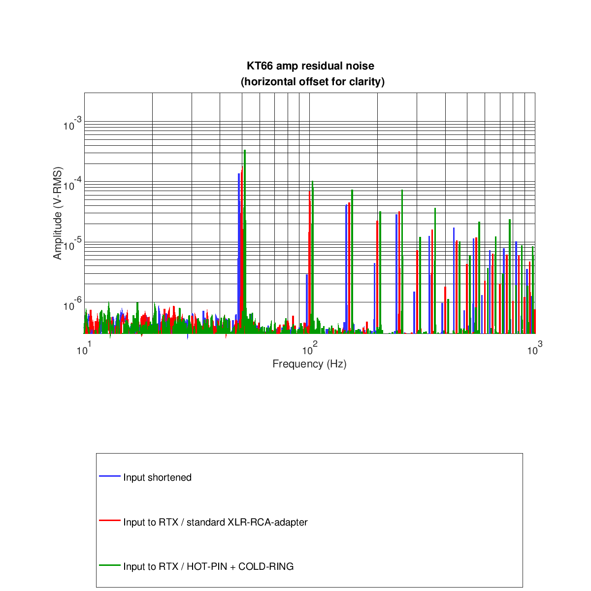

Ok, tried that. See attached plot.
The blue curve is with the amplifier input shortened (only connection between RTX and amp is via speaker output to RTX input).
The red curve is with a standard XLR-to-RCA converter, as described in my previous post 1675.
The green curve is using your setup (XLR-HOT to RCA-PIN, XLR-COLD to RCA-RING, no GND/chassis connection).
I thought your suggestion was a good one, because it avoids the additional connection of the chassis/GND of the RTX and the amplifier. I expected this would reduce the hum/noise in the measurement as compared to the setup using the standard XLR-to-RCA converter. However, it was the other way round. Why?
I'd really like to understand how the hum/noise creeps in, and how I can deal with it. With the amp input shortened (amp input not connected to the RTX output), there is much less hum/noise.

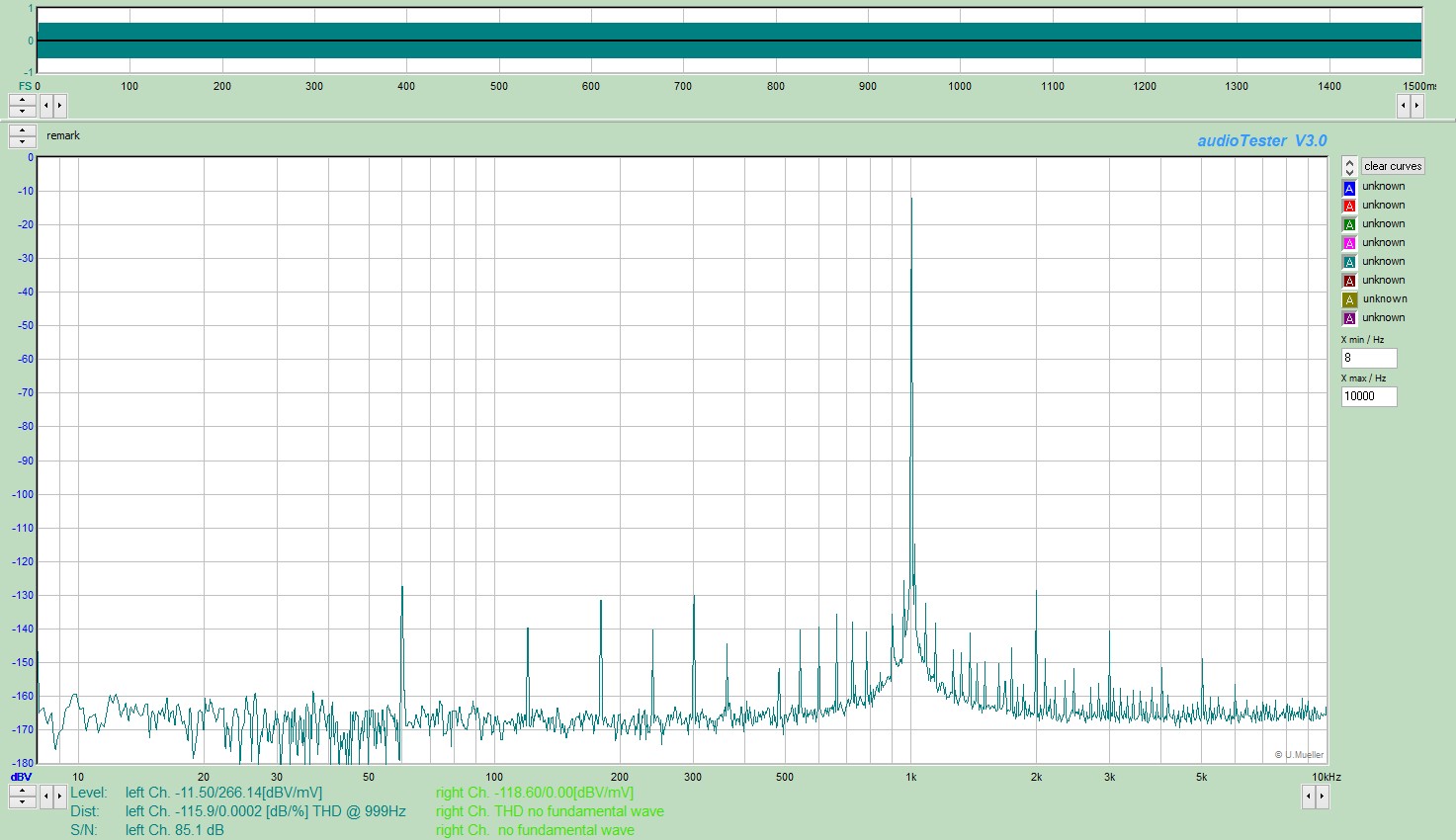

You are right - I had to keep the Pin 3 connction removed for ground loop. I had used mostly to tweak HP 239A distortion performance. Since the Noise floor is so low, we can see the 60Hz PSU harmonics below -120dBfs

Are you confirming that connecting the XLR chassis (pin1) to the RCA screen/shield measures quieter?
Yes, that measures a wee bit quieter than without the chassis connected.
How is the KT66 connected?
Do you get similar results with another amplifier?
What if the other amplifier is not directly connected to the mains Protective Earth? i.e. use a Disconnecting Network between Main Audio Ground and protected Chassis
The K66 amplifier input was either shortened or connected to the RTX output in one of the two ways as described in my previous post. The amp output was connected to an 8 Ohm dummy load. The RTX input (balanced / hot and cold) was connected across this dummy load, and the chassis pin of the RTX input XLR was left unconnected. The audio GND of the amp is connected to the chassis via a ground loop breaker (diodes/bridge rectifier plus 10 Ohm resistor). The chassis is connected to safety earth via a three-pronged mains cable.
I didn't have another amp with a three-pronged mains cable, but I'll go and find one.
What happens with the RTX output from the NEGATIVE/COLD pin?
If the standard XLR-to-RCA adapter is used, the NEG is grounded to the RTX chassis, which is directly connected to safety earth.
If the custom cable is used (XLR-POS to RCA-PIN and XLR-NEG to RCA-RING, no GND connection), the NEG output is connected to the audio GND of the amp, which connects to the safety earth via the ground loop breaker. What happens there? Could this somehow explain why the measurement with the custom adapter gives slightly more noise than with the standard XLR-to-RCA adapter?
Thinking a bit further, would an isolation transformer in the mains power line of either the RTX or the amp (or other DUT) help to break the ground loop via the safety earth connection?
Not at 50 Hz, but at low multiples of 2*50 Hz.
Could it be that the symmetry of a rectifier helps there?
Just speculation.
Yes, the difference with the input shortened is strongest for 100 Hz, 200 Hz, etc., which smells like PSU ripple from a rectifier. I don't see how this would arise just from connecting the RTX output to the amp. The only thing I can think of is maybe residual PSU ripple showing up at the RTX output, which is then amplified by the amp and then shows up at the speaker output... is this a possibility? What are the voltage amplitudes of the residual PSU ripple at the RTX outputs, if any?
