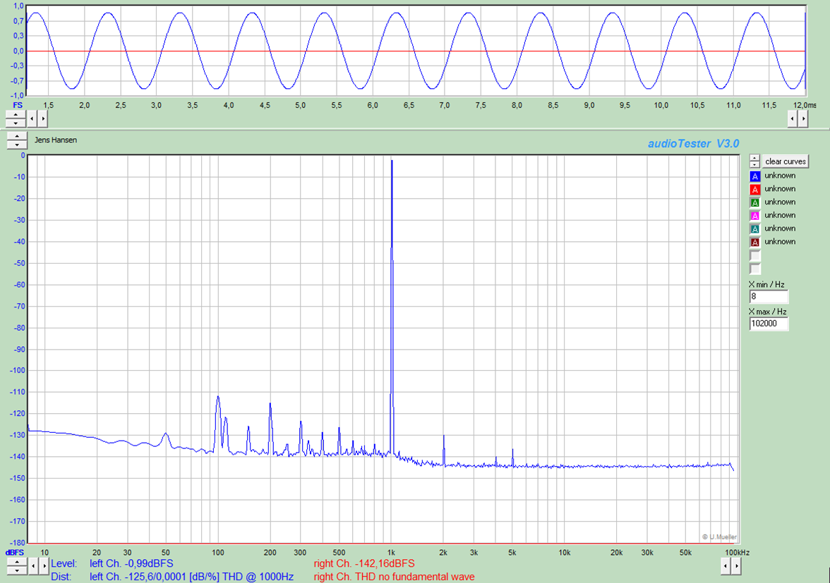

Are you looking for something like this?
I measured this with my Audio Analyzer some time ago. Input range = 10 dBV.
In this case I used a Stanford Research DS360 as the generator. Output level = 2.6 dBV. It was adjusted to give a level of -1 dBFS from the ADC. The noise below 1 kHz is from the DS360. The white noise is gradually disappearing between 1 and 2 kHz due to the low pass filter in the DS360.
As you can see the AK5394A is very clean all the way up to 90 kHz.
