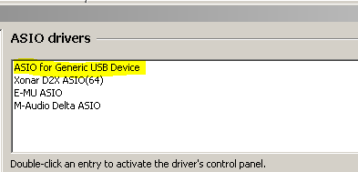

Yes, USB Audio Class 2.
1 is supported by default in Windows for some time now without an update/driver needed.
I may also be mistaken about ASIO, this is the Foobar Control Panel that still has the selection for the driver.
This means the driver probably also supports ASIO, but it would need someone to try it out for themselves as I no longer have the device with me.

I use the ASIO driver provided by MiniDSP, so I don't need a native Windows driver. With the ASIO driver you can bypass the Windows audio system, which is what counts here.
No, you can't; ASIO is a higher level driver it still needs a device driver. MiniDSP has paid for and provides the Thesycon USB Audio device driver for you which is why it works.
There is no UAC 2.0 driver for Windows so without the Thesycon driver for XMOS chips you can't exceed 2ch 24-bit 96 kHz. Windows only has a UAC 1.0 driver.
To answer others: I do not believe Windows 10 has UAC 2.0 support still.
Currently there is NO UAC 2.0 support within Windows 10! 🙁
Read on "Windows support for USB Audio 2.0?" link below:
