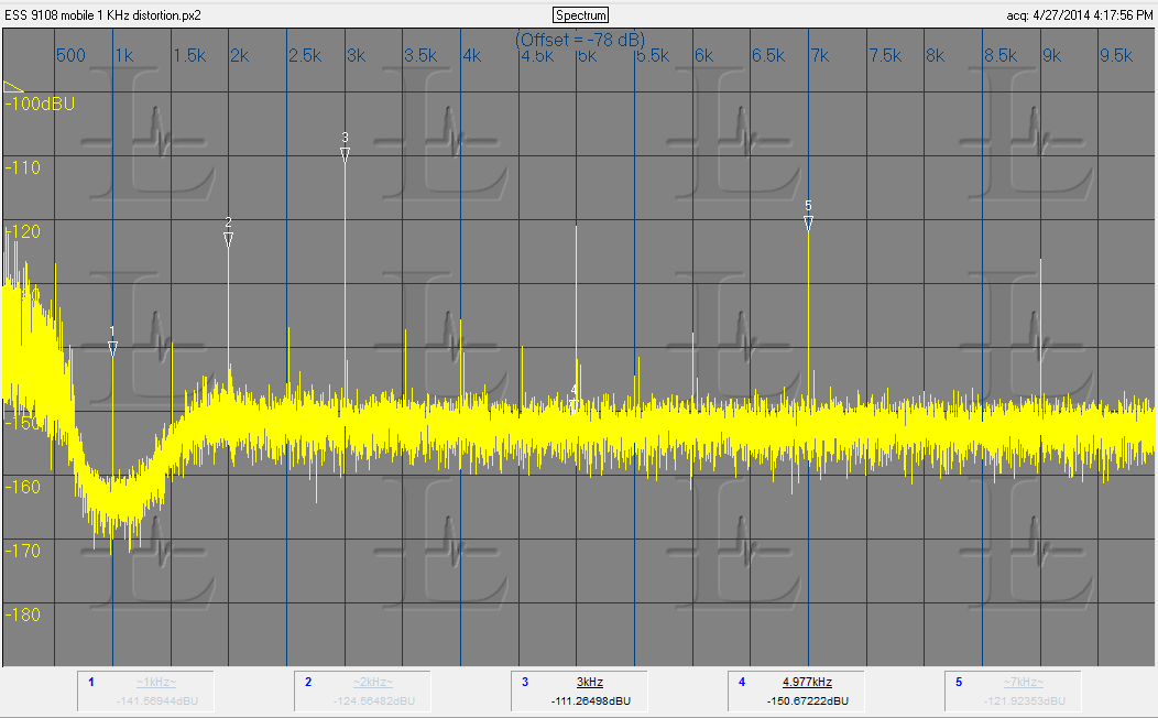

I measured the ES9018 some time ago and cannot find any saved results. I do have measurements of the mobile version of the ES9018-2m I made (below). Its good but not outstanding. The source was Alex's Altor generator. The full ES9018 is very good but you need to do a lot of tweaking and fiddling to get results.

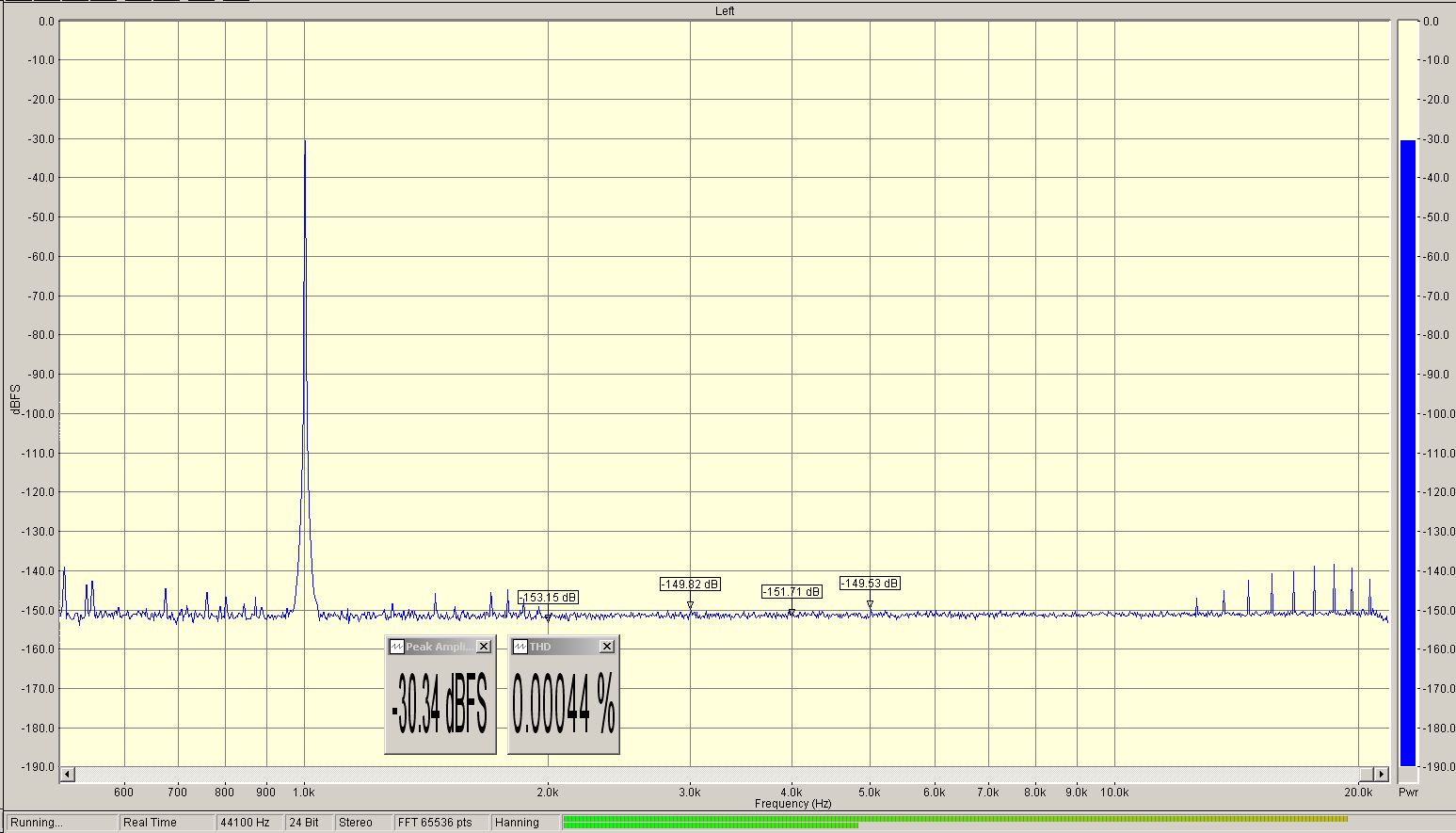

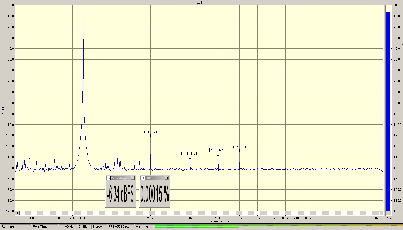

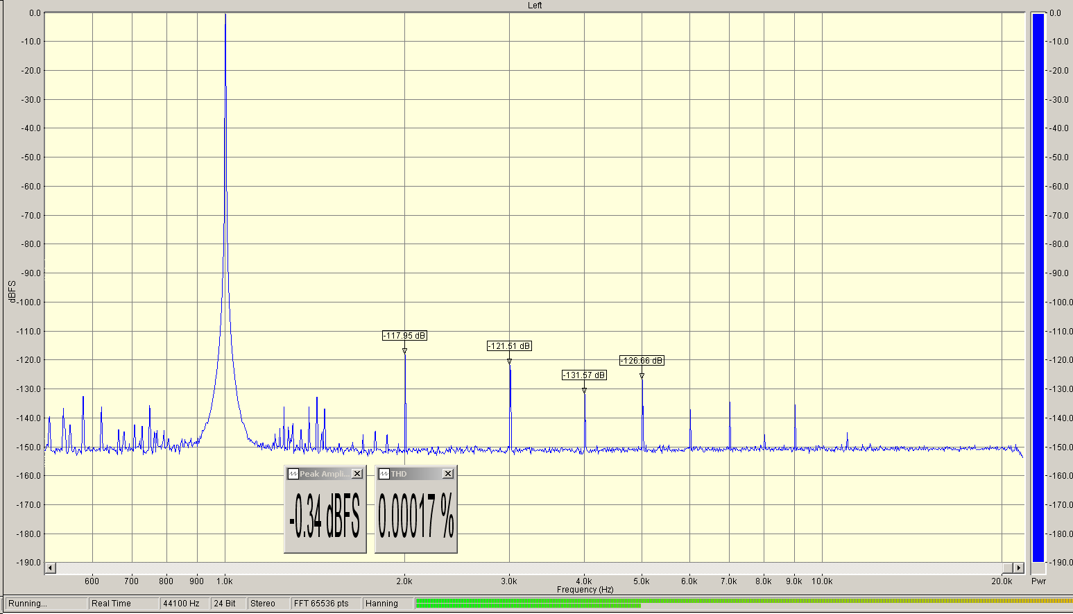

And finally for reference an AK4490. This was also using the Altor generator at 352 KHz sample rate. And I had not invested a lot of time sorting the grounding as should be obvious.
Hi Damien,
As I see - you use notch filter to avoid ADC problems at high level signals. But the result are very closed to what I get with AK4490 -> AK59394 without the notch:
