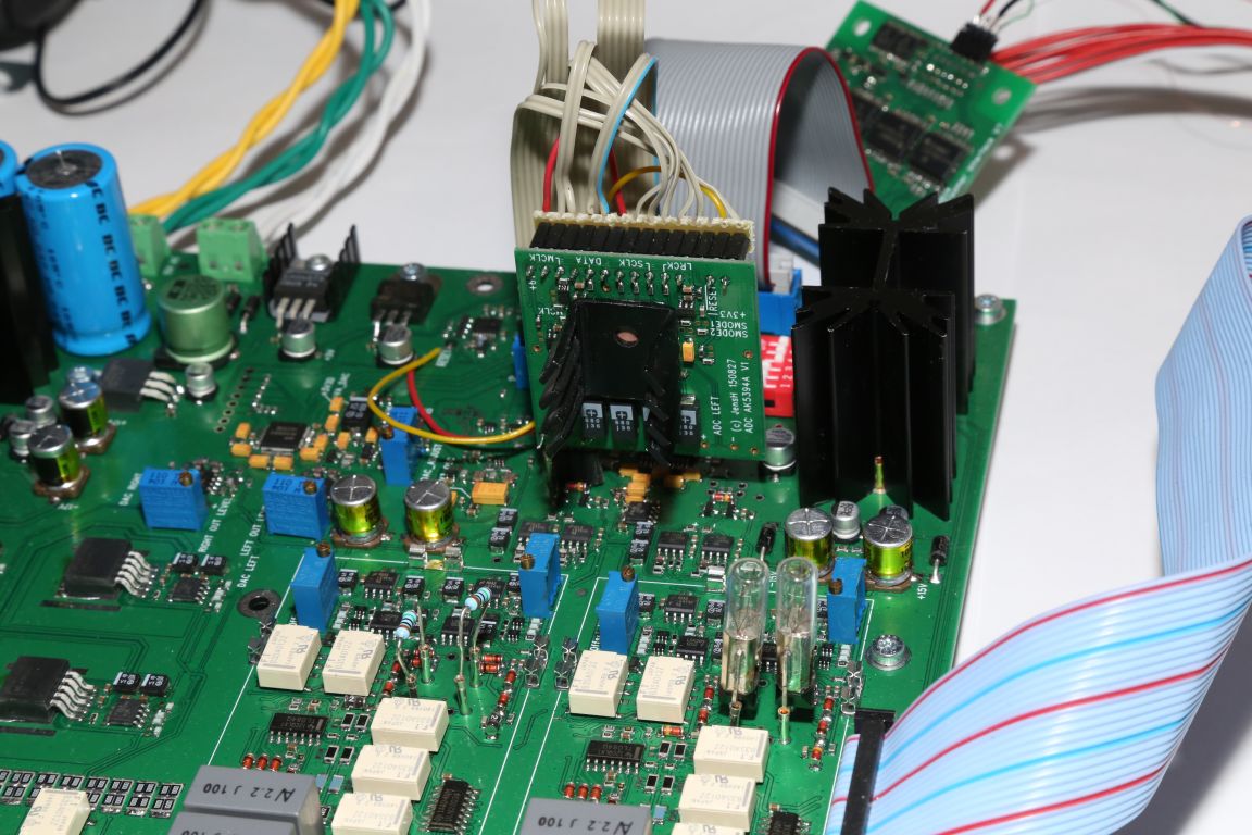

Jens,
The point of "Might be easier and better going for a "good but not so simple" approach" is exactly that.
- if you use separate boards for the ADC and DAC, then without fully differential inputs and outputs you will be killed by noise between the two different grounds (by this I mean that the ground on the ADC and DAC will have noise on it comprising digital hash and also signal related noise).
- In my mins single ended measurements will be limited to the -110 dBc region with such an approach.
- In a system integrating the ADC and DAC into a low impedance common ground, then you can avoid (a fair bit of) the problems that separate daughtercards will see between their grounds.
- A balance between the complexity of a fully differential system, and a larger more complex single PCB will need to be addressed.
- A fully isolated system is an option as noted above. Again, this increases complexity.
It might be doable to make it behave more like one ground plane with a very low impedance connection between boards. A high density board to board connector with a lot of pins dedicated to ground and ensuring there is at least one ground pin adjacent to a signal should help.

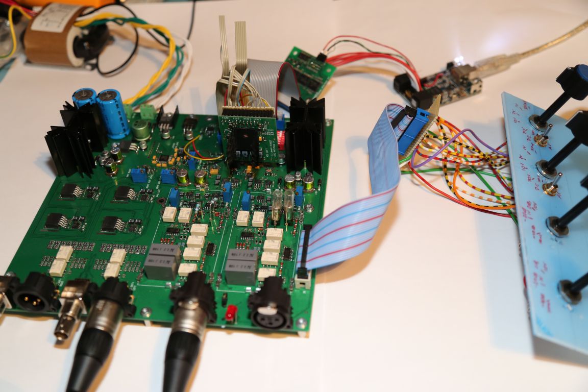

@googlyone
Thanks for the explanation.
The design is fully differential, so I think it will be possible to move the ADC and the DAC to separate boards without too much trouble. I have attached a couple of pictures, which show the present test setup. Notice the AK5394A board, which is mounted vertically. The analog signals and a couply of ground connections are mounted on the edge closest to the main PCB. The I2S, power supply and a few control signals are connected at the top, most of them through a flat cable, where each of the critical signals (I2S and MCLK) have a ground wire running in parallel.
Not exactly an ideal mounting method, but all the measurements using the AK5394A that I have shown previously were made using this setup.
You can also see the heat sink, which, with vertical mounting, is sufficient to improve the distortion considerably.
@altor,
Isolating e.g. the DAC and output circuits has been discussed before. I agree that for some use cases this would be preferable. I won't completely rule it out at this point in time, but it will complicate the design and introduce new risks. I think that with the balanced input a lot of ground noise problems can be eliminated. So it may not be needed in most cases.
@1audio
One of my goals from the outset was that it should be possible to use it with virtually any PC, including portable PC's. Using SPDIF would make this difficult. USB is almost always available. It must be a good USB port though, not one that has gone through a USB hub.
@chris719
Even if I move the ADC and DAC to separate boards they will still share the same master clock, which comes from the main board. Except for the addition of a couple of connectors, the clock system would be the same. Of course I have to be careful with the master clock routing, but I think it can be handled.
