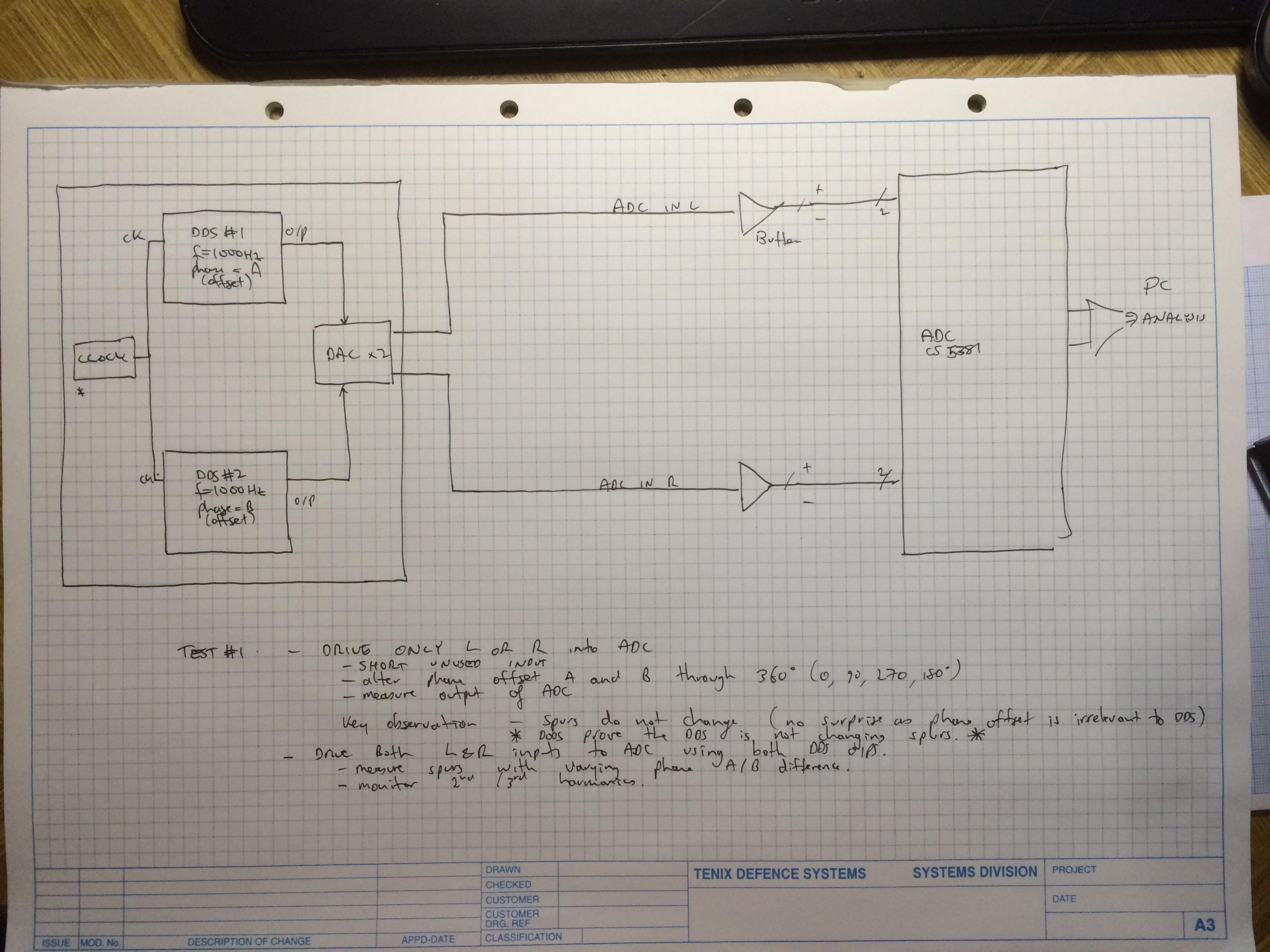

I could get the ADC suprs to shift by +/-3dB on a CS5381 by shifting the phase of two inputs (L and R).
This was achieved by driving a DAC as a two channel DDS, and shifting the phase of one output.
I know it was not the oscillator as driving one input to the ADC only, leaving the other disconnected, did not produce the shift in spurs as the relative phases of the DAC were shifted. I suspect I am looking at crosstalk between the ADC channels here, with the crosstalk at the appropriate phase cancelling harmonics. A 90 degree shift in one channel neatly pushed the second harmonic down - which makes sense.
The DAC I used comes nowhere near -130dBc, which is my biggest problem with optimising the measurement system I am playing with. I am currently rebuilding the DAC taking very particular care on the output filter...
The test was undertaken using the following setup and process.
The phase offset to the DDS is irrelevant in terms of its harmonics - at least the digital side.
- by testing one output and shifting the phase of the other output it is possible to see if the two DDS generators are changing harmonics as a result of the phase difference between them. In this case the answer was no - shifting the relative phases of the two outputs did not alter the harmonics on the DDS output.
- with both DDS outputs going to L and R input of the CS5381, it is possible to alter the measured harmonics of one channel by a significant amount.
Note that these levels are in the -110 to -120dBc region - but that is all it takes to make a very large difference in distortion.
I spent a fair bit of time looking for coupling of noise from the supply rails into the buffer amplifier, with no effect. On the CS5381 the primary effect was on one channel - I did not record which.
if you drive one channel and leave the second shorted you can see the crosstalk on the "shorted" channel at down around these levels, so to be frank, it is not surprising to be able to show that with the right phase shift you can produce these sorts of effects.
The original point being: at such low levels even very subtle and second / third order effects start becoming important.

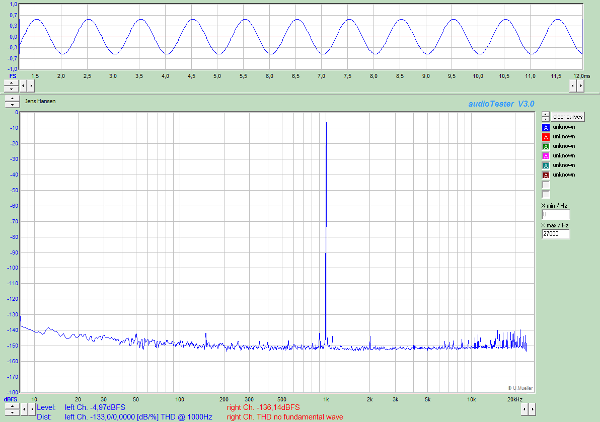

I made the attached measurement on Monday this week. It shows a loop-back measurement using the input channel, which has been modified with an AK5394A ADC. The levels chosen are probably close to where I can get the lowest distortion on DAC and ADC. To be honest there was a bit of fluctuation, so the measurement shown was one of the better ones 🙂 Most measurements were slightly worse, perhaps by 1-2 dB. But with a loop-back distortion of -133 dB I guess there is room for that!

  • 1kHz distortion_AK5394A channel_-15.4dBFS out from AK4490_input 3V range_128k FFT_average over 5.png
