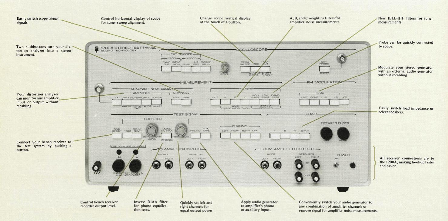

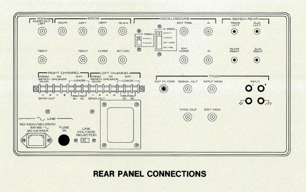

Maybe what we all need is something akin to this: http://www.cieri.net/Documenti/Misu...gy - Stereo Test Panel model 1200A (1978).pdf I have one and have found that is not that well suited to today's audio equipment. A revisit to the core features and adjusting to what is needed in terms of interfacing to a PC or audio analyzer and having the I/O for mobile and digital as well as traditional amps would be really nice. Today it could be much smaller and controled from USB or some simple front panel buttons. the scope interface would be pretty redundant as would the FM generator interface. Not a small project but really useful.
A project perfect for Arduino implementation with relays?
I'll think it through over the next few days and try a first pass at a spec. I'll post in a separate thread. I suspect it will be similar to Pete millet's with some additions and setup for external control. I would welcome input from anyone.
I think Jens enhancement to the input circuit will really address the harder parts. its interfacing all the different types of audio devices that is difficult today.
