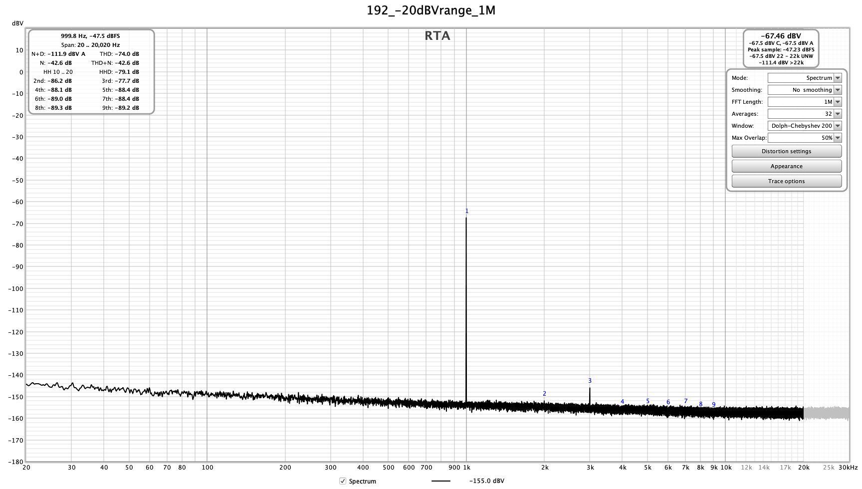

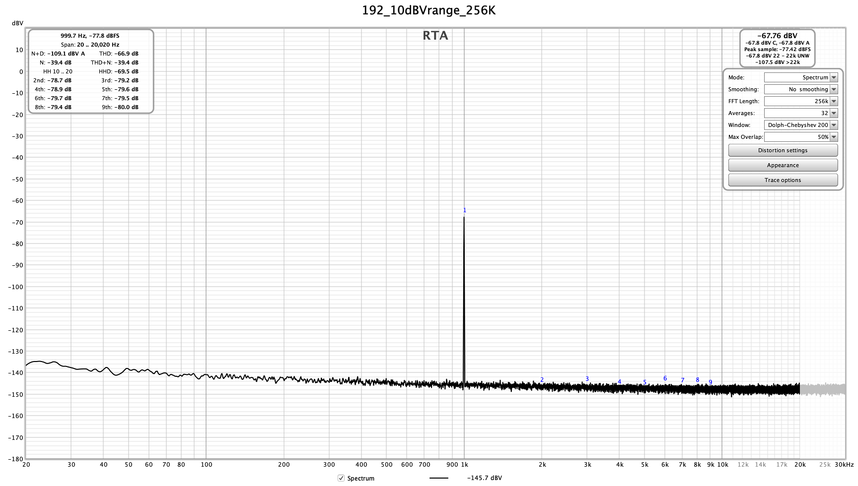

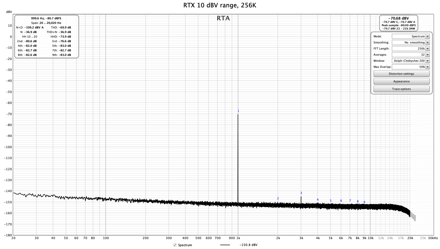

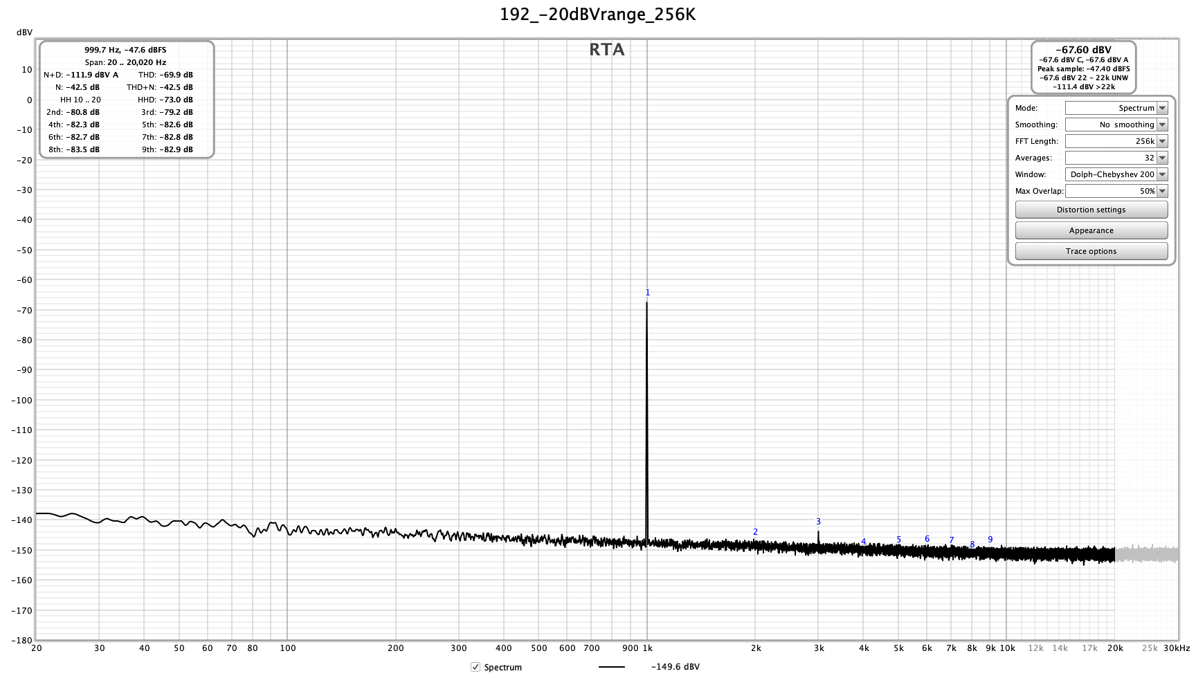

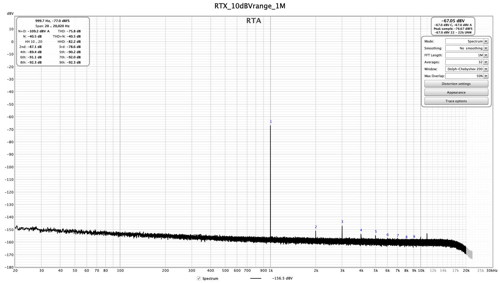

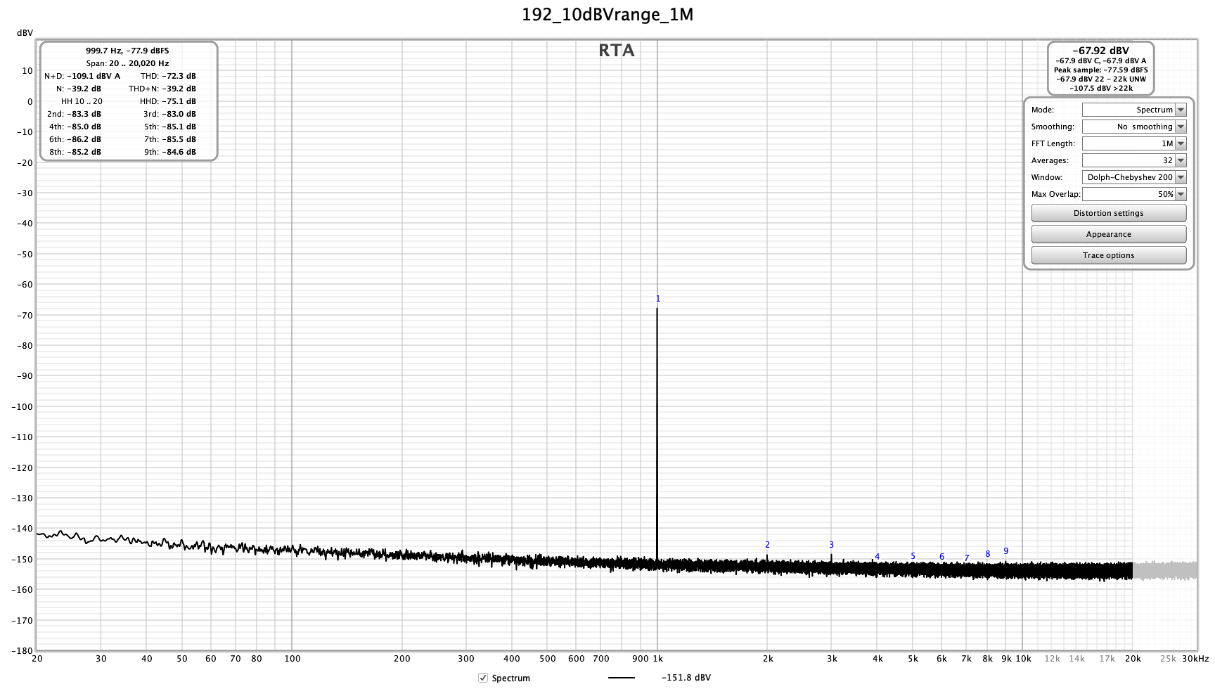

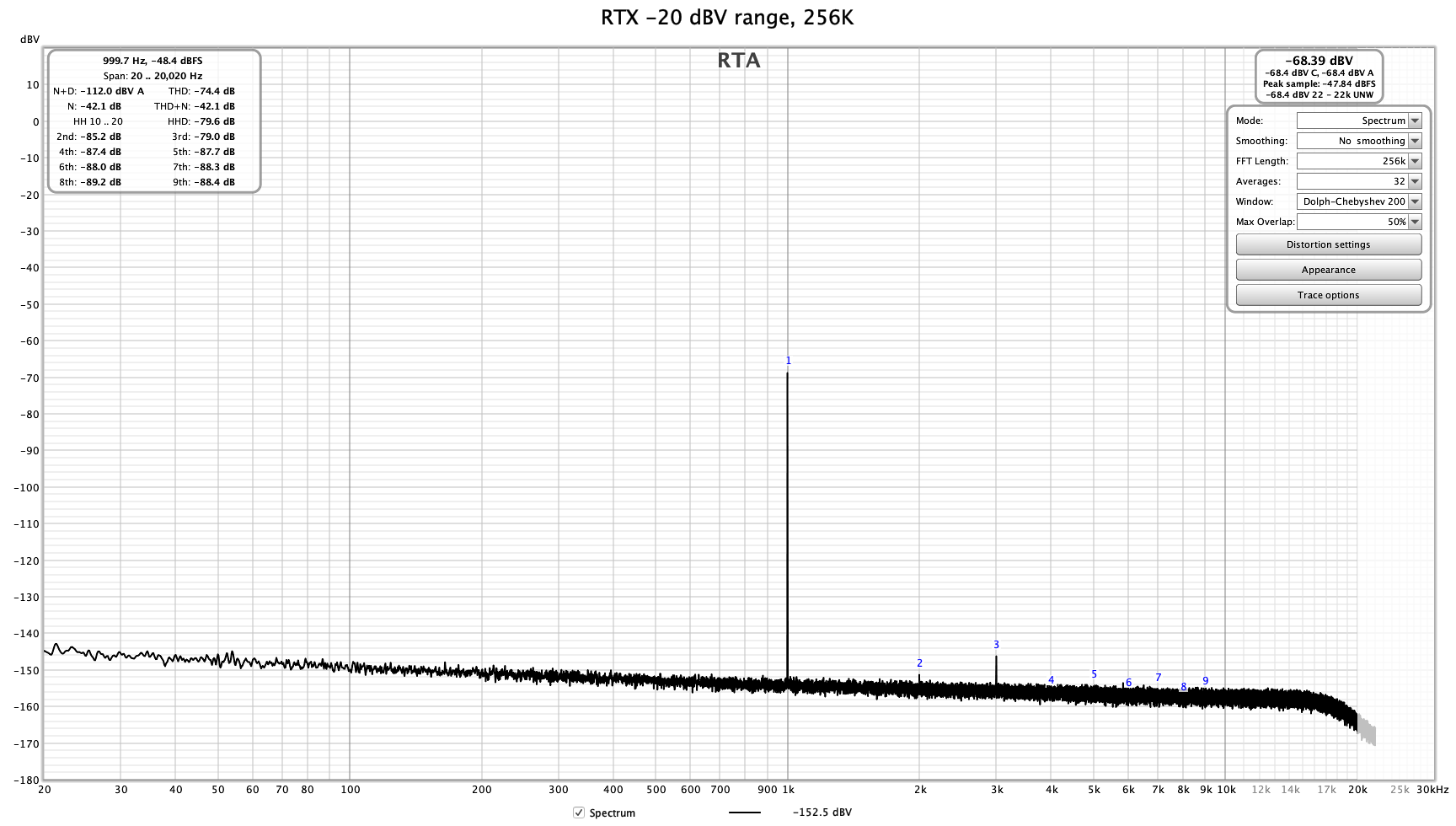

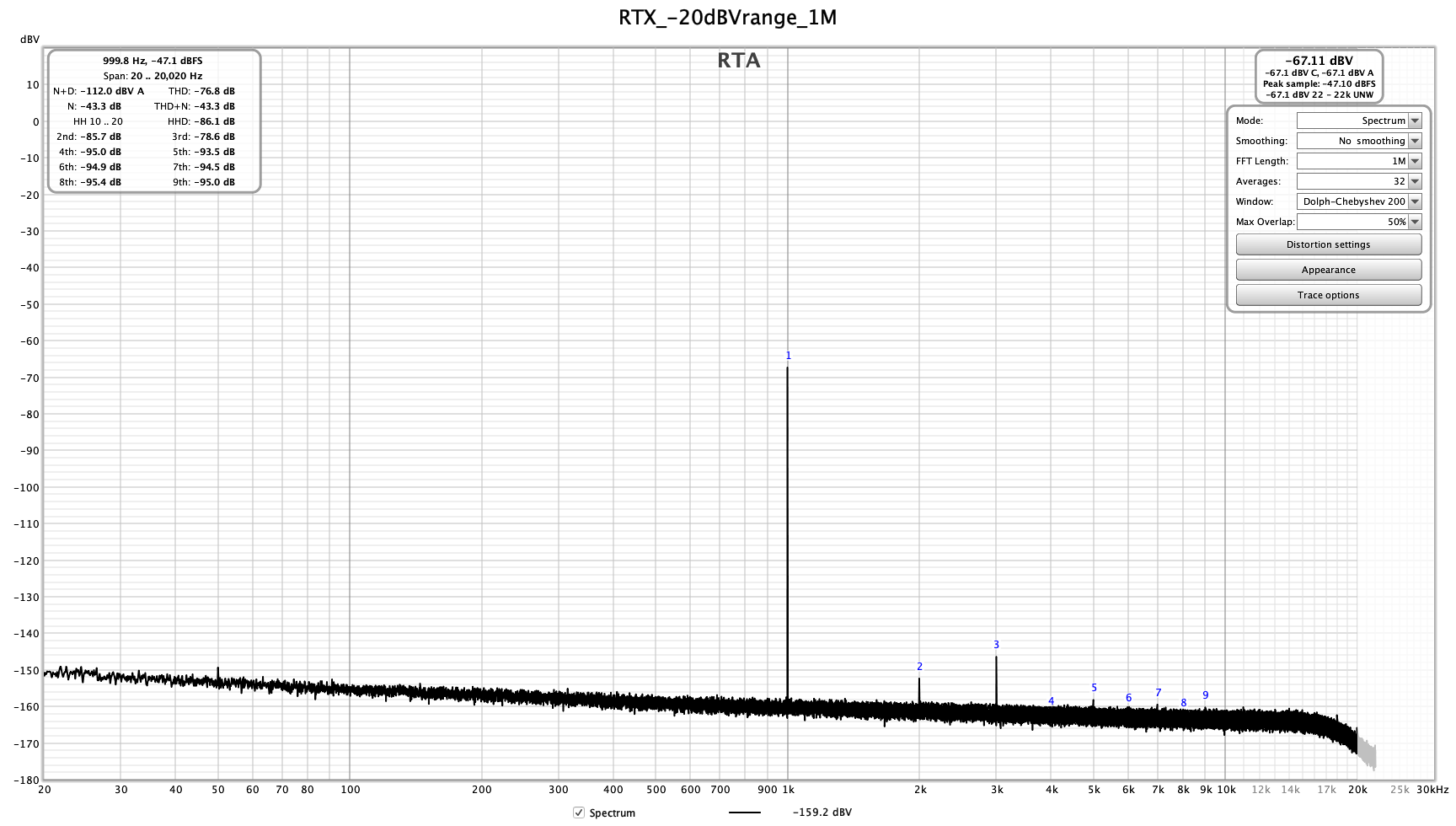

To understand better the best RTX setting for ultra-low distortion analysis I did a couple measurements using the Victor oscillator and a notch filter, also from Victor. Specifically, I addressed the difference between lowest noise (-20dBV) or lowest distortion (10dBV) setting on the RTX. I also tested the effect of different sampling rates (44.1 and 192 KHz) and FFT bin sizes (256K and 1M) as I understood from Jan that reducing the sample rate and increasing FFT bin size lowers the noise noise floor.
First up the FFTs recorded @ 44.1 KHz
After correction for the amplitude of the fundamental before the notch (14.6 dBV) and the notch attenuation of the harmonic (-9.4 dB), H2 computes as follows:
Sampling rate/RTX input range/FFT bin size
44.1KHz/10dBV/256K -156 dB
44.1KHz/-20dBV/256K -159 dB
44.1KHz/10dBV/1M -159 dB
44.1KHz/-20dBV/1M -158 dB
192kHz/10dBV/256K -152 dB
192kHz/-20dBV/256K -154 dB
192kHz/10dBV/1M -156 dB
192kHz/-20dBV/1M -159 dB
The data suggest:
I) Always better to use the RTX @ -20dBV input setting for this type of measurements.
II) Lowering the sample rate (from 192K to 44.1K) or increasing the FFT bin size (from 256K to 1M) both help in pulling up the harmonics by lowering the noise floor. The effect seems somewhat additive.
III) The measured distortion is essentially the same independently of the settings, as long as the harmonic can be readily identified above the noise floor.
Not really surprising, but still nice to know😉

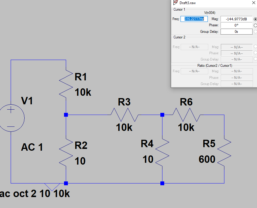

With the notch filter the necessary dynamic range is reduced and you could even add a 40 dB preamp. Since the range is reduced the harmonic contribution of the ADC will be way below the harmonics at the output of the filter. As long as the insertion loss is corrected the harmonic level should be the same. However to be sure of what you see you could add a marker at -120? dB to verify all the gains and losses. A resistive divider would to the task. Two cascaded dividers with shielding because even 120 dB isolation is difficult.
Attached is a simple circuit that can work to get -145 dB from a voltage at the input. The output of the Victor is 600 Ohms (at least on mine). These parts are pretty generic but the capacitance across the 10K resistors will reduce the attenuation at higher frequencies. Absolute precision will require some effort but the 1% parts will get you close and make sure you have all the losses and gains correct.

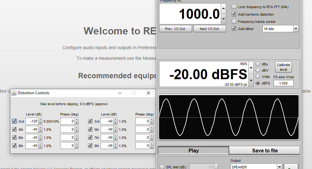

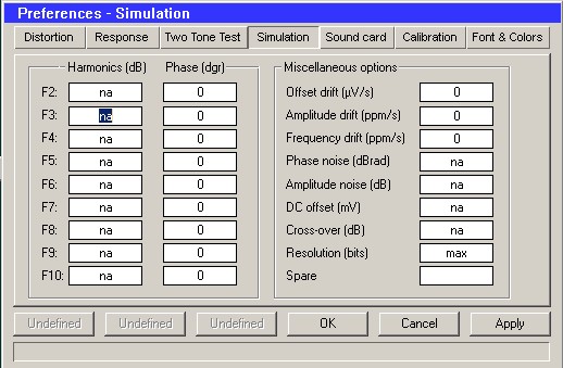

Should I implement this "nice thing" also into DiAna? (not that difficult, as there is already a simulation menu)Yes that is a good check. The nice thing with the REW is that it has a menu to add harmonics to the test signal, you can select any harmonic (also combined) from the 2nd to the 9th, at arbitrary magnitude and phase.

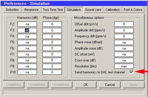

Hi Manolis,Edmond, it would be a nice future for the DiAna.
I'm working on it (see pic.)
E.
One caution about generating harmonics with a DAC- the uncertanty of the ADC is also an issue of the DAC. While a digital -120 dB harmonic of a certain phase can be created very precisely, the digital to analog conversion may (will) alter its accuracy. This is why it would need to be checked with any specific instance of a DAC. Especially if the DAC has a -130 dB distortion product and another is placed on top of it I think it would need to be at least 10 dB stronger to be reasonably close to the correct value. However this is the kind of thing Pavel's distortion correction effort has been approaching pretty successfully.
Maybe adding a non-harmonic tone would be better as a level pilot to verify level.
Fully agree Demian. In my experiments I have made a point of making sure the pilot is NOT harmonically related to the test tone.
So if the test tone itself generates harmonics above the floor they would be easy to identify and account for.

These are good points, but.... the THD spectrum of DiAna is insensitive to non-harmonic signals. So when adding a (magnitude) pilot signal, its amplitude must be well above the distortion level of the ADC and DAC. No problem, I would say, because it's not my intention to use this pilot in order to test the measurement floor, rather to check the attenuation of band-pass and band-stop filters.One caution about generating harmonics with a DAC- the uncertanty of the ADC is also an issue of the DAC. While a digital -120 dB harmonic of a certain phase can be created very precisely, the digital to analog conversion may (will) alter its accuracy. This is why it would need to be checked with any specific instance of a DAC. Especially if the DAC has a -130 dB distortion product and another is placed on top of it I think it would need to be at least 10 dB stronger to be reasonably close to the correct value. However this is the kind of thing Pavel's distortion correction effort has been approaching pretty successfully.
E.
Or you can directly generate the distortion sines at requested amplitudes and phases (time offsets) relative to the fundamental and sum them with the generated fundamental.
