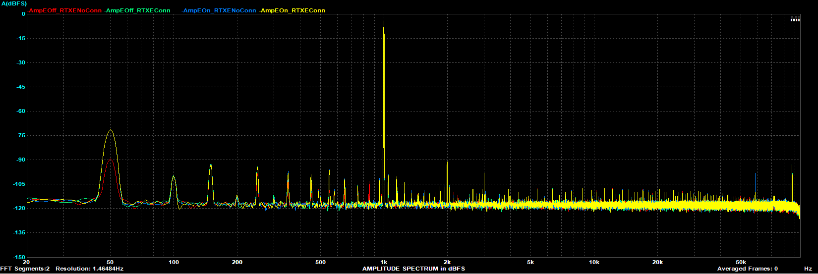

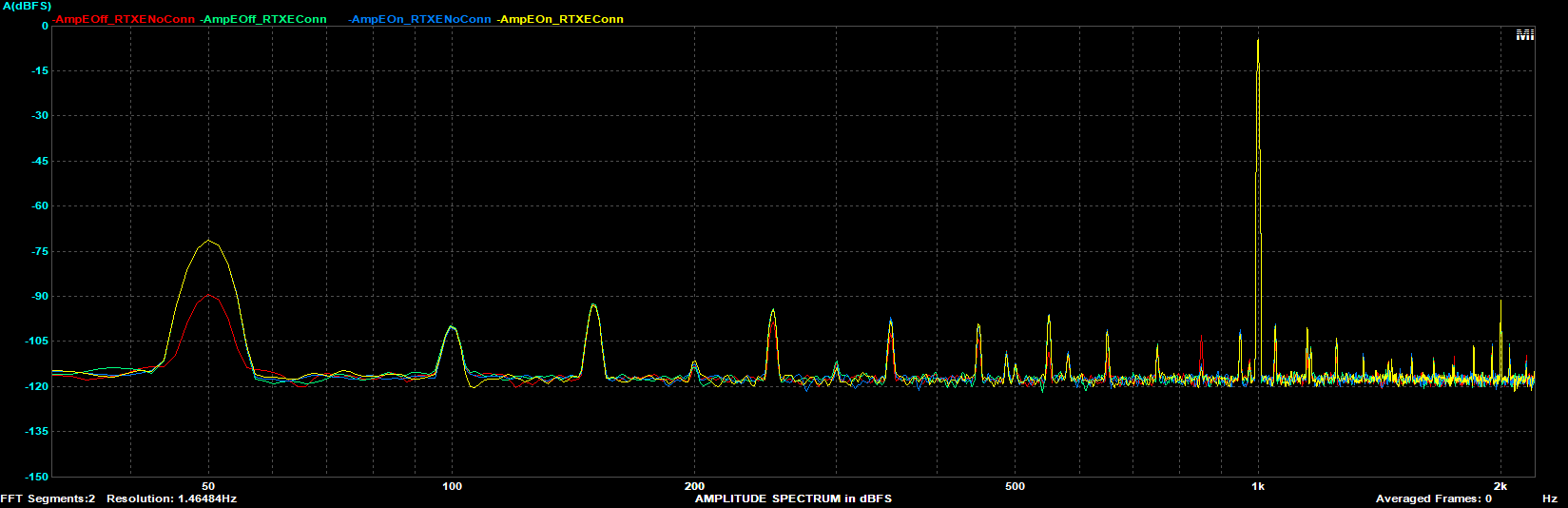

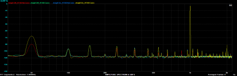

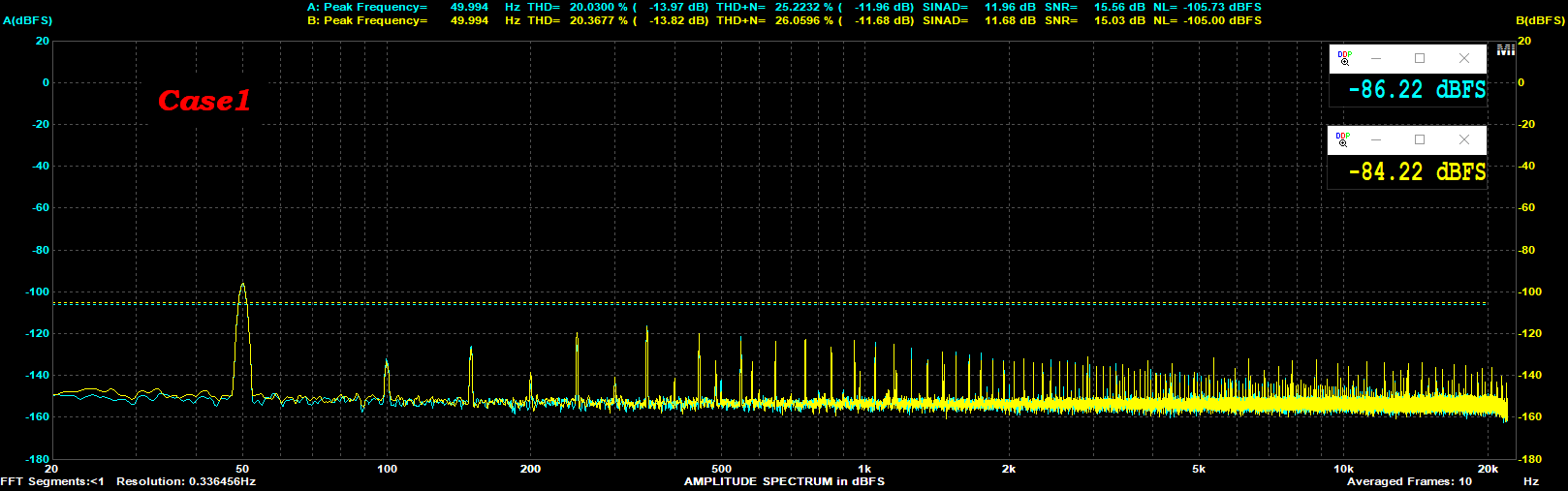

I done some experiments with that, today.
Four cases examined
AmpEOff_RTXENoConn.= that means I removed the Earth from the Amp chassis and I haven't any connection between RTX Earth and Amp.
AmpEOff_RTXEConn.= that means I removed the Earth from the Amp chassis and I have a connection between RTX Earth and Amp.
AmpEOn_RTXENoConn.= that means I have joined the Earth from the Amp chassis and I haven't any connection between RTX Earth and Amp.
AmpEOn_RTXEConn.= that means I have joined the Earth from the Amp chassis and I have a connection between RTX Earth and Amp.
As you can see at the attachement photos, only at the (1) situation, I had an improvement with 50Hz hum by the 18-20dB. But the rest of pattern still the same.
The first was a 192KHz capture, the second is the zoom from 20Hz-2K

First step disconnect the connection between the amp and the RTX and short it to get a baseline. That 50 Hz will be a baseline. If its high you need to address that first. Moving that cable around will show local hum fields to avoid. To check for radiation from the amp transformer etc. you can start with no power to the amp and see how much 50Hz you get. Then disconnect the power cord and see which way the hum goes. Also with the amp connected to power, both grounded and not grounded measure the voltage between the amp chassis and the RTX. You can also measure across a 1K Ohm resistor between the two chassis to see how much leakage current there is. leakage current is the most insidious since it will go through the RTX and 'pollute' all the ground connections.
Demian, thanks for all your suggestion.

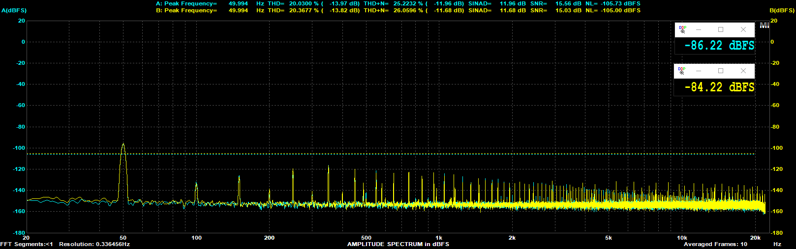

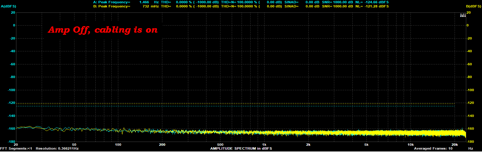

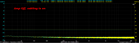

- For the first, I take a Noise Baseline capture without amp on, all the cabling is on.

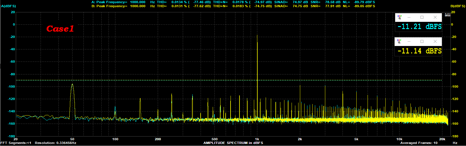

- This amp has a ground loop braker at the relay input, with a series of 47.5R and 220nF btw gnd signal and earth safety (case1).
With this setup without signal and no connection btw RTX and Amp I take a shot of Noise Baseline with the Amp on.

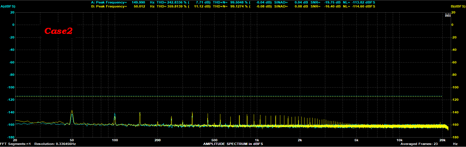

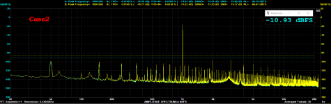

Then I removed this ground loop braker and put a parallel 10R with 100nF capacitor (case2).
With this new ground loop braker, without signal (input bridged) I had the best results on Noise Baseline.
But the things are strange when I give a signal from RTX.
Compare the THD@1KHz at the 1W@8 Ohm, btw case1 and case2. I feel that the case1 has better pattern.
THD @44.1KHz, 1W, 8 Ohm, new grnd loop braker - Case2.png30.4 KB · Views: 487
Noise Floor Amp On, Input bridged old ground loop braker - Case1 diy.png31.7 KB · Views: 488

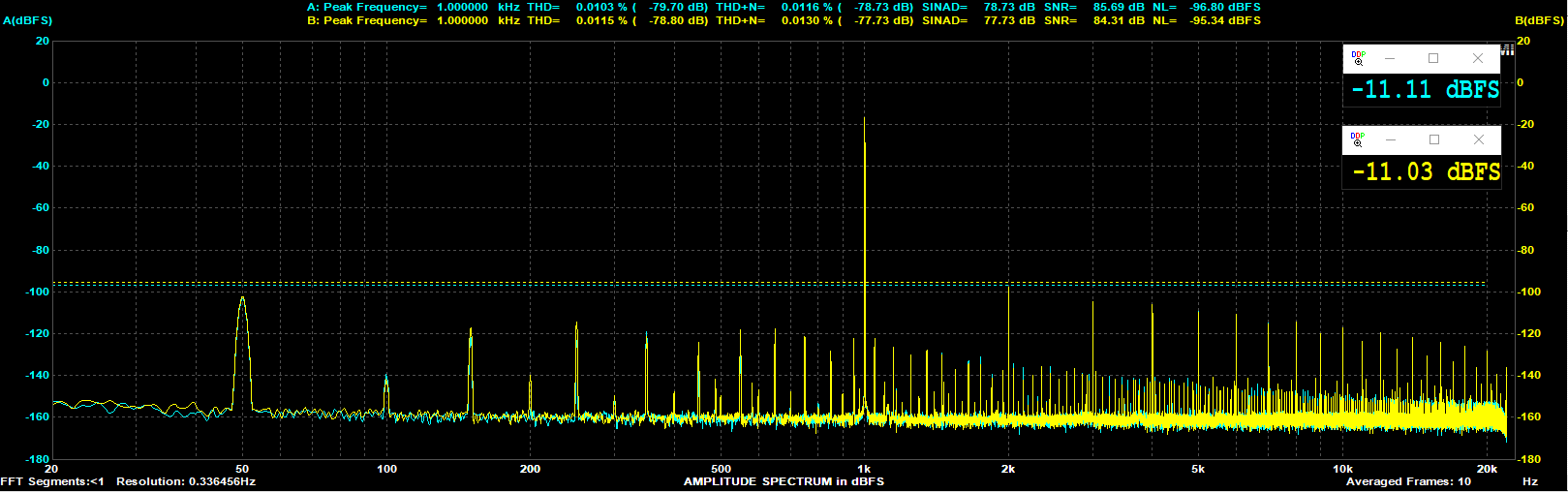

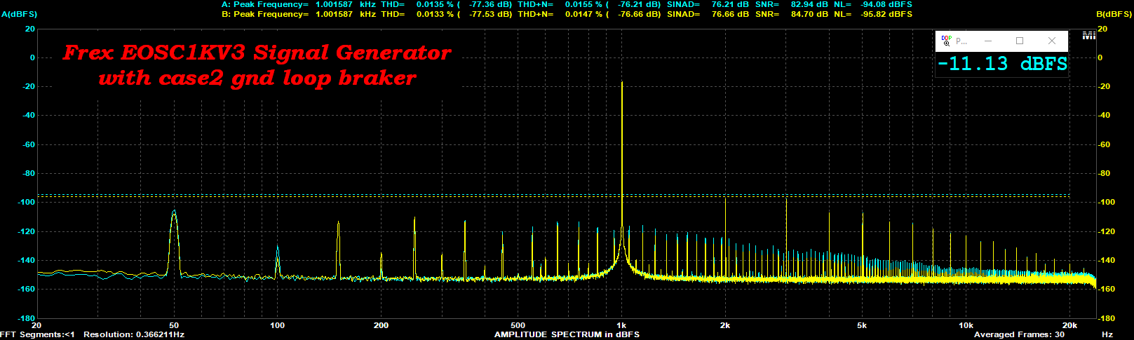

Also, I connected the Frex EOSC1KV3 Signal Oscillator and took a shot at 1W@8 Ohm.
The Noise Pattern is more smoothing in case2 like at the case1 of ground loop braker.

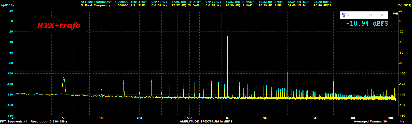

I done and this measurement, a trafo SE->SE on RTX output.
There is no any improvement on Noise Pattern and I am thinking your thought at the "Tutorial: How to use the RTX6001 audio analyzer in real world audio tests", that you said :
"There are also a number of peaks at 50 Hz, 100 Hz, 150 Hz, etc. This might point to pickup of mains power noise in the amplifier or by the measurement setup (although there should be no ground loop in the test setup). Some of these peaks are higher with lower dummy loads. This might point to increased ripple in the linear power supply of the power amplifier when the output current is higher with lower dummy loads."
