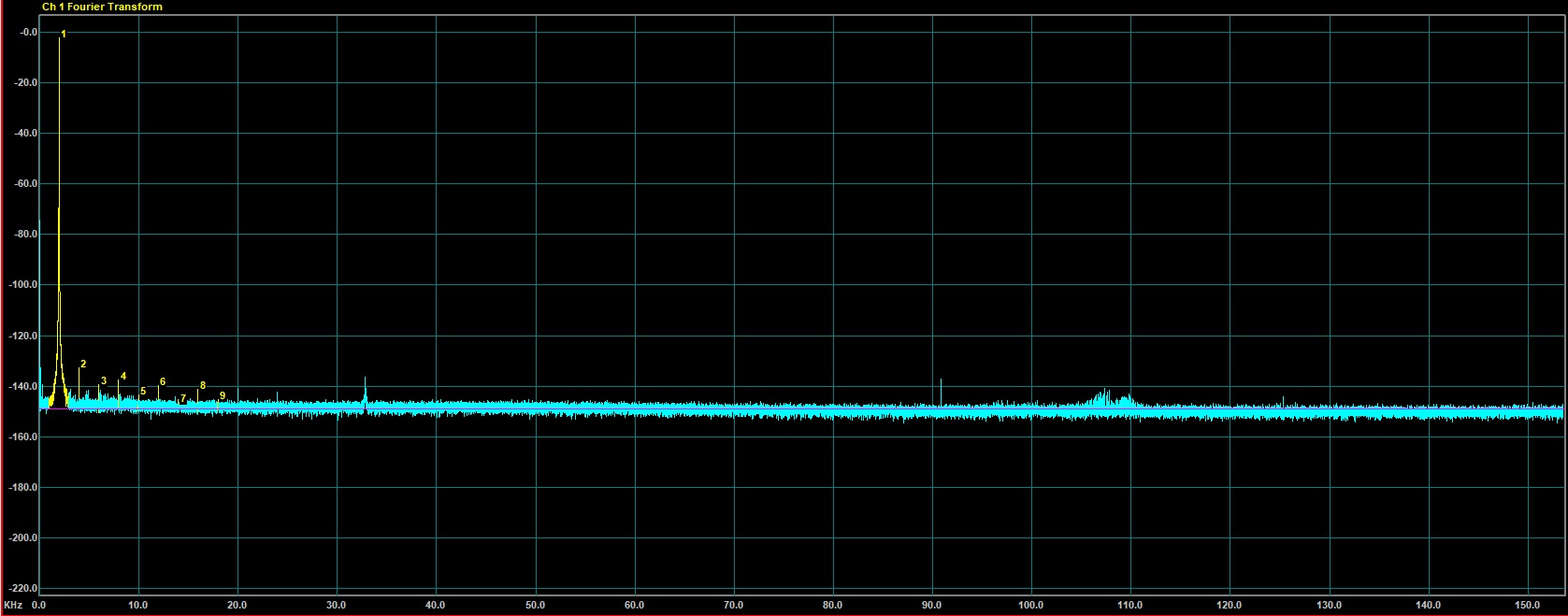

I evaluated a couple of industrial grade 20bit SAR ADCs (LTC2378-20, ADS8900B) and definitely the audio grade ADCs are not worth fighting with. According to my testing, the LTC2378-20 from Analog Devices/Linear Technology gets the first prize with:
SNR 102dB
THD -128dB
SFDR 130dB
ENOB 16.45bit
Noise Floor -149dB
All up to and very close to FS (0.03dBFS) which is 10Vpp, BCLK=24.576MHz, Fs=BCLK/80=307.2KHz. Signal fo=2KHz, bin width below is 2.344Hz, about 20 averages.
The TI ADS8900B is close, but slightly worse (THD is -124dB, with the same OPA1602 op amps). I am myself also put off a little by the TI part datasheet, it is not as straightforward to use as the AD/LT part (although the multi SDO mode is interesting). For both, interfacing with I2S is, if not trivial, rather easy, at least for the LTC2378-20 for which I looked closely. A dual channel implementation (the part is single channel) appears also very easy.

The ENOB is not what it could be.
Any comments?
Best wishes
David
Any comments?
That's what the measurement is telling me. Theoretically,
ENOB=(SINAD-1.76)/6.02
SINAD=(Psignal+Pnoise+Pdist)/(Pnoise+Pdist)=100.7dB (reported as measured)
So ENOB should come as 17.02 bit. I can live with the 0.57bit difference, though. My guess is the tool has a slight error in evaluating the SINAD, it is reported as exactly the same value as the S/N which is incorrect, S/N=Psignal/Pnoise.

... the SINAD, it is reported as exactly the same value as the S/N which is incorrect...
Should be very close because the THD is so low that the SNR will dominate.
I am just a bit surprised SNR is only ~17 bits in a 20 bit chip.
I do understand that an industrial SAR chip won't match an audio chip optimised for SNR but haven't studied SAR sufficiently to appreciate the details.
Best wishes
David
I think you are confusing the DAC ENOB with the DAC Effective Resolution.
The Effective Resolution is defined as
ER=Noise free code resolution+2.7bit
where
NFCR=log2(2^N/Vpp_input_referred_noise_counts)
Therefore, when calculating SINAD and ENOB, the noise and distortion include not only the input referred noise of the ADC, but also the quantization noise and the distortion. Hence, the SINAD and ENOB are a measure of the dynamic performance. Effective Resolution is used to measure the noise of the ADC under DC input conditions; in this case, quantization noise is absent, so ER is always larger than ENOB.
In this case, from measurements, I get Vpp-noise (input shorted) about about 14 ADC counts (which is about 70uV given the 5V FS), therefore NFCR is about 16.2 and ER=18.9bit, much closer that what you would expect, correct?
