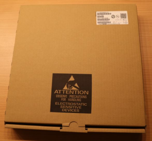

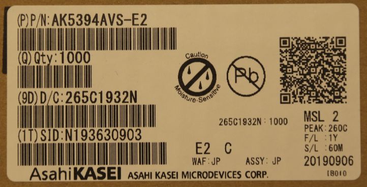

This landed on my desk the other day 🙂
Was sourcing these one of the reasons to stop the production? If so it is a pitty indeed if they now turned up "by thousand" - literally.
These probably also don't gain much value with age as some older small signal J-FETs do. So quite a conundrum indeed.
No, it was not related to the decision to stop the production.
I have continued the development of the analyzer in my spare time and if it ends up being a product I would hate to be held back by the lack of components.
The LME49990 becoming obsolete was bad enough, but it can be managed and I also have some of those in stock. The ADC was a much more critical component, so I decided to buy a reel of them, which was the minimum order quantity for the last time buy.

How much did you pay for 1000 pcs?
I got a resonable price, but still in the double digits in USD, so I could have bought a fairly nice car instead of the box with the 1k pieces 😱
