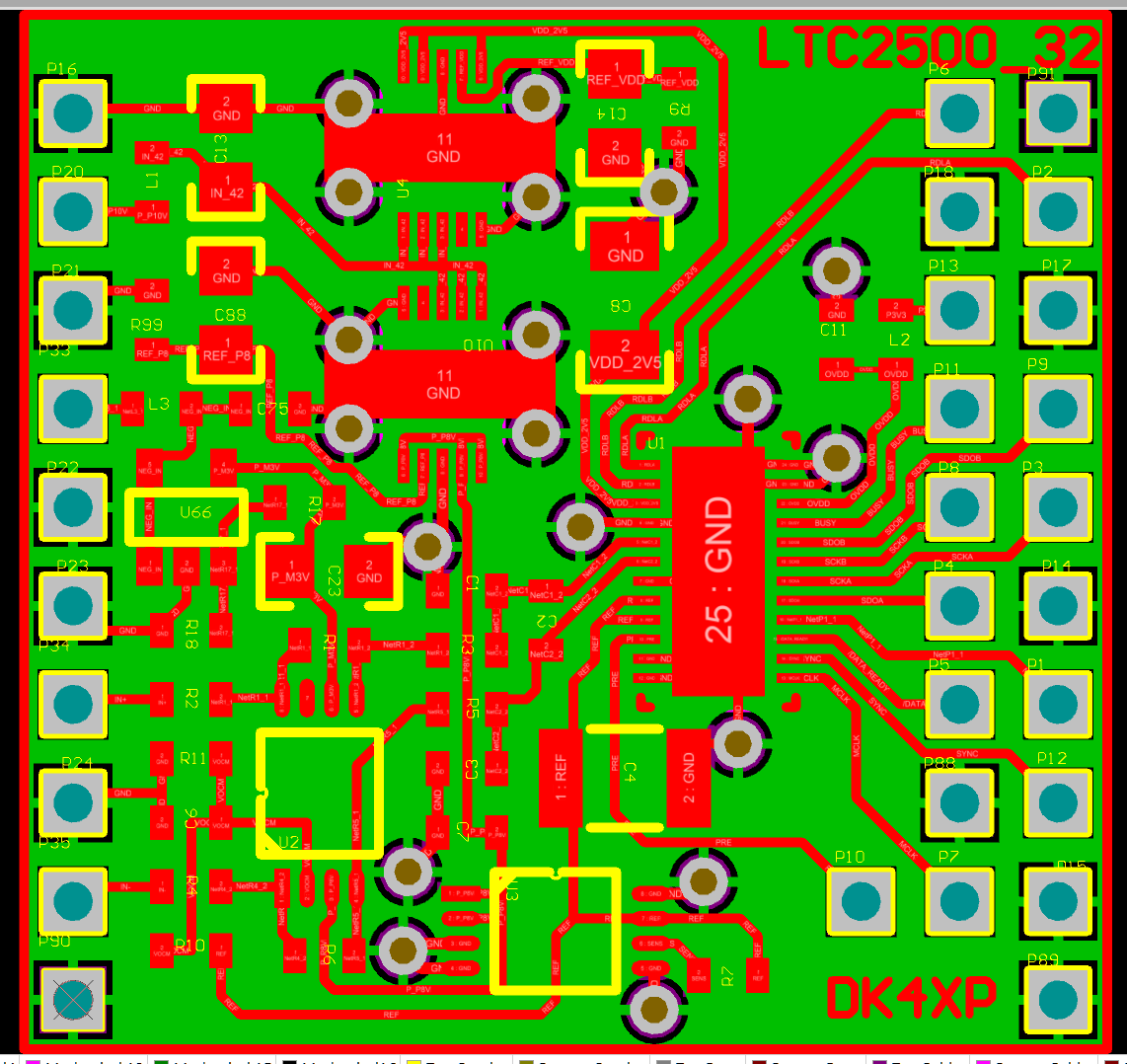

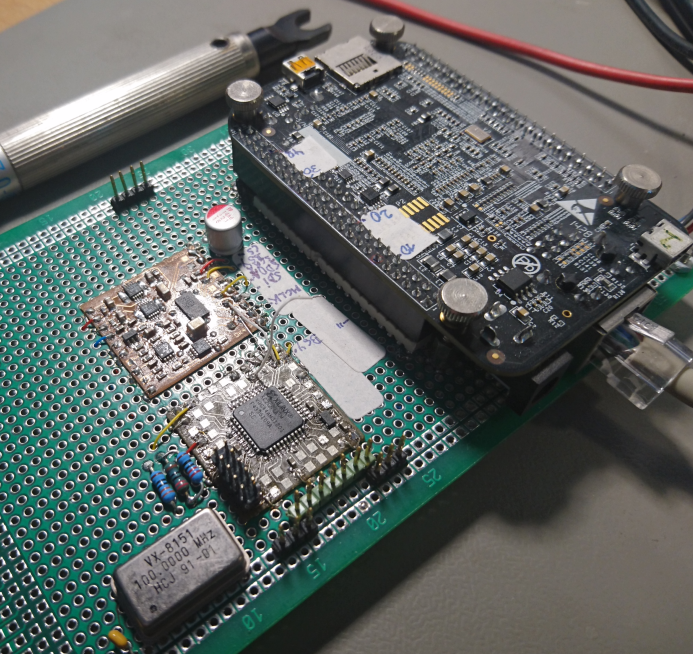

I have started something similar, really as the baseband implementation of a
phase noise test set, but for that I have found a fully digital solution that works
at the expense of $$$.
It is centered around a BeagleBoneBlack, a 1 GHz ARM RISC with floating point
and running Debian Linux. All software editing & compilation can be done
on the BBB, you simply ssh into it from your laptop. I could compile fftw,
the fastest FFT in the west on the ARM.
There is a mutation of my control program for the 89441A FFT analyzer
that runs on a PC and can do GPIB / IEEE488-like conversation over the LAN.
The LAN interface of the BBB is isolated via transformers.
No ground loops. WLAN should be possible also, but I did not explore that.
The ADC is a LTC2500-32. It delivers up to 1 MSPS @ 24+ bits. Sample rate is
programmable in steps of 2 and derived currently from a 100 MHz oscillator.
It uses 100 MHz SPI for data transfer. Smaller sample rate delivers more bits.
Digital filters and decimation are inside the LTC2500-32.
In addition to the BBB, one currently needs 2 1-square-inch boards, home-etched
in my case. One is a Coolrunner2 CPLD that creates the sample rate and
converts the 100 MHz SPI to a slower byte-wide interface.
The other is the ADC board. It has the ADC, LT3042 regulators for analog and
digital VCC, the recommended differential driver for the ADC and another
regulator for the negative driver supply. Reference voltage is provided by
a LT6655.
The BBB can handle upto 3 ADCs at full sample rate. That was important for me
so I can calculate the 3-cornered hat. (A cross correlation that can separate
signals/noise from 3 sources. Allows to dig deeper into the noise.)
The BBB has 2 on-chip IO processors with 5 nsec predictable instruction rate.
They are programmable in C , the necessary compiler is included on the BBB.
One of these IO processors fetches the ADC data bytewise from the CPLD
and deposits them as samples in a 16 Kword shared on-chip static RAM, where
ARM can fetch them away. I have implemented a ping-pong buffer. Time series
can be megabyte-large.
The shared ram serves also for command handshaking. The control program
on the laptop can set for example the decimation factor, pass it as GPIB-like
string over the LAN to the ARM in the BBB. The ARM deposits it in a command
register in the shared RAM and the PRU IO-Processor then sets up the ADC.
That works already. I cannot yet transfer ADC buffers larger than the shared
RAM, that still needs to be programmed. Project overload.
I would create a repository on github or sth. like that with the Altium files,
PC, ARM + PRU programs and the boot image if there is real interest.
That thing would be a nice self-contained FFT analyzer without USB drivers
and such. Just open port 5010 on 192.168.178.38 and write ascii commands
or read time samples or spectra. A BBB costs $50 or so.
regards, Gerhard
