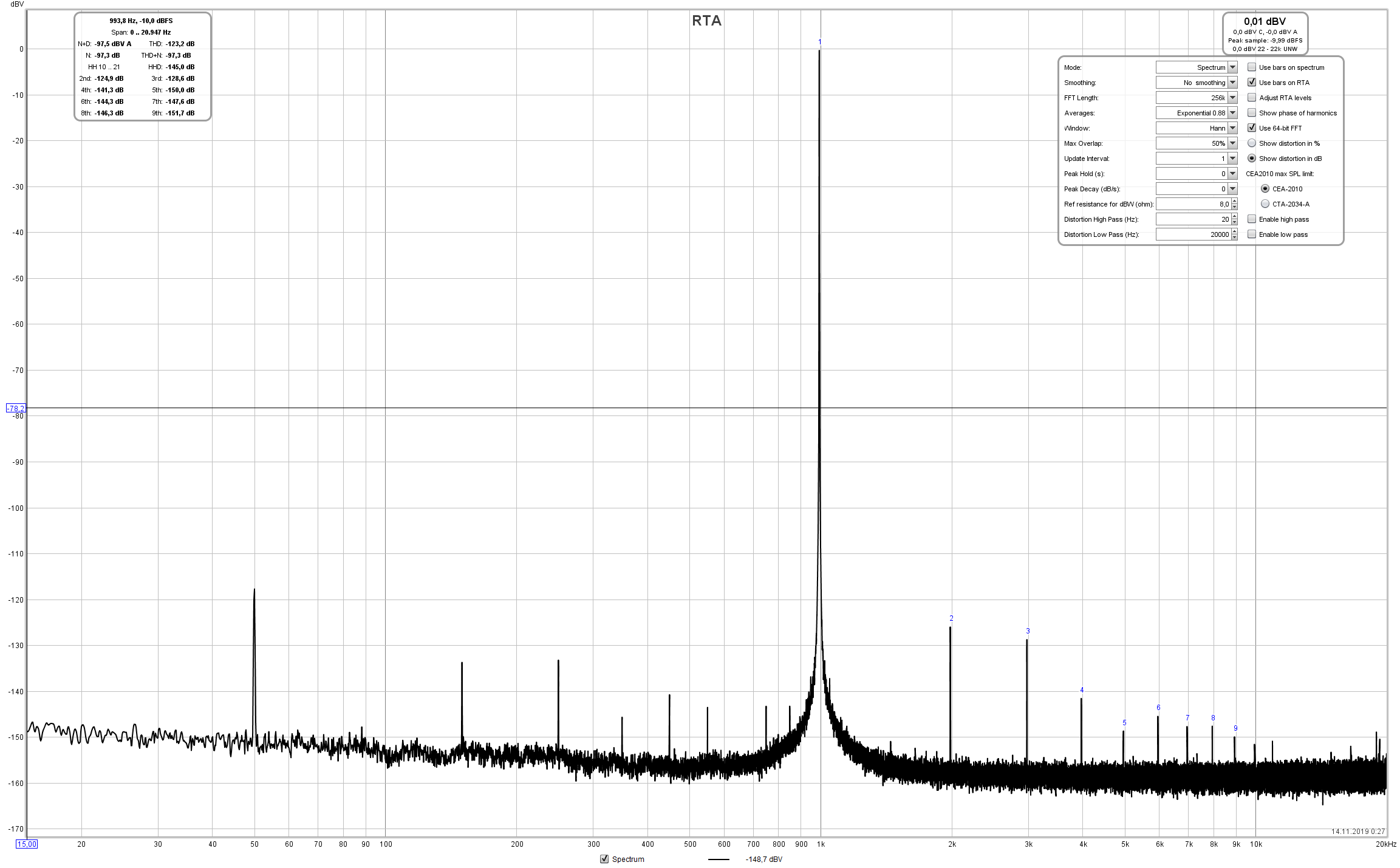

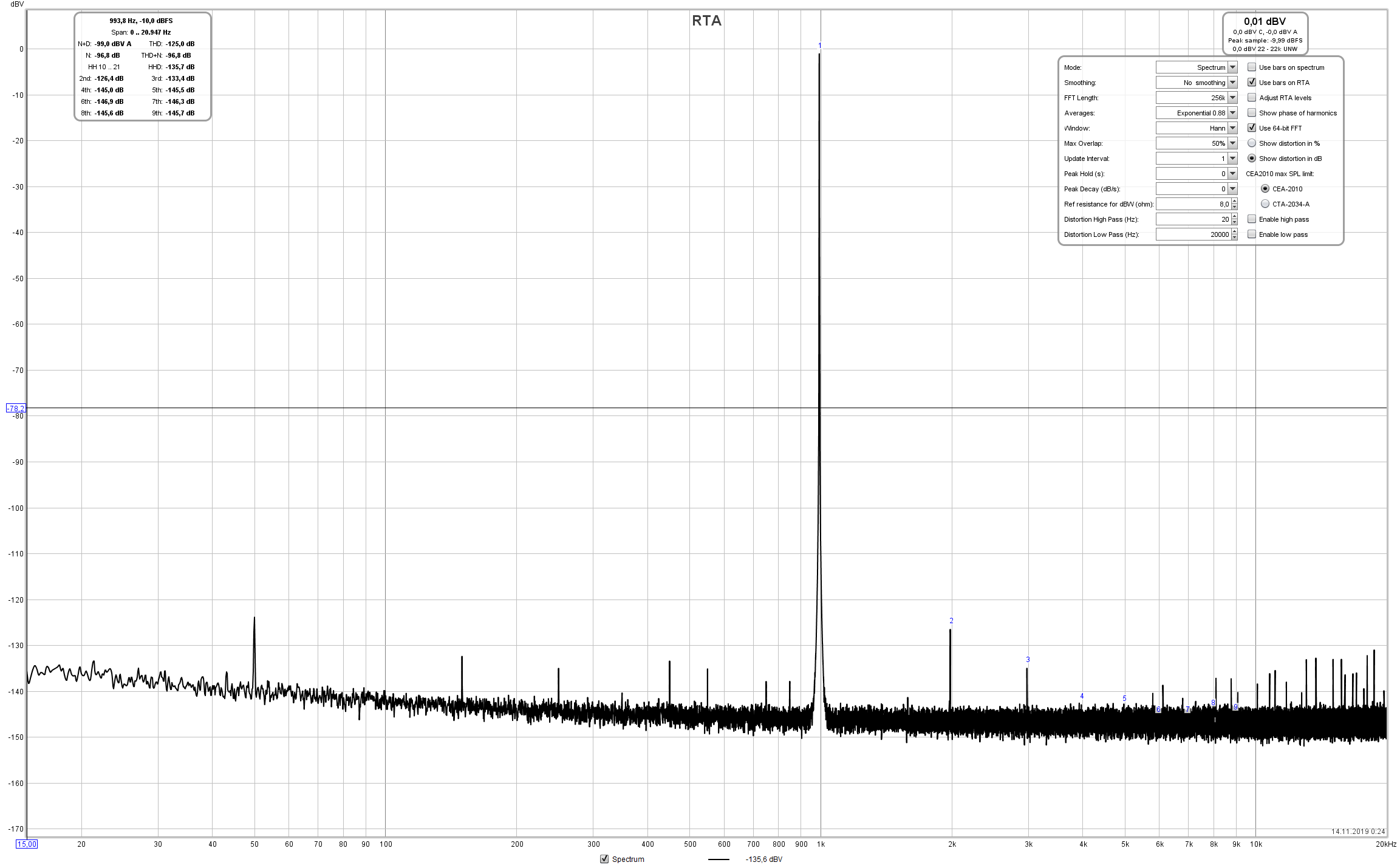

Unfortunately not - att settings was sett correct (100mV, 316mV and 1V) on analyzer and on RAW, corresponding to level of measured signal.
Also, everything is in dBV and not in dBFs!
But beside that, is evident the difference in noise floor.

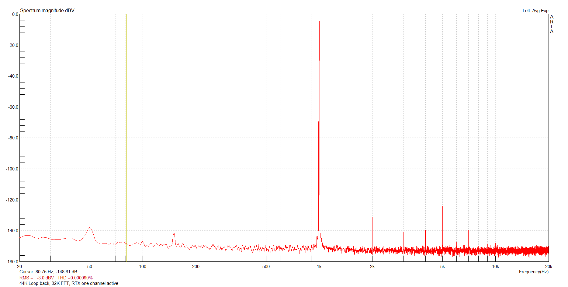

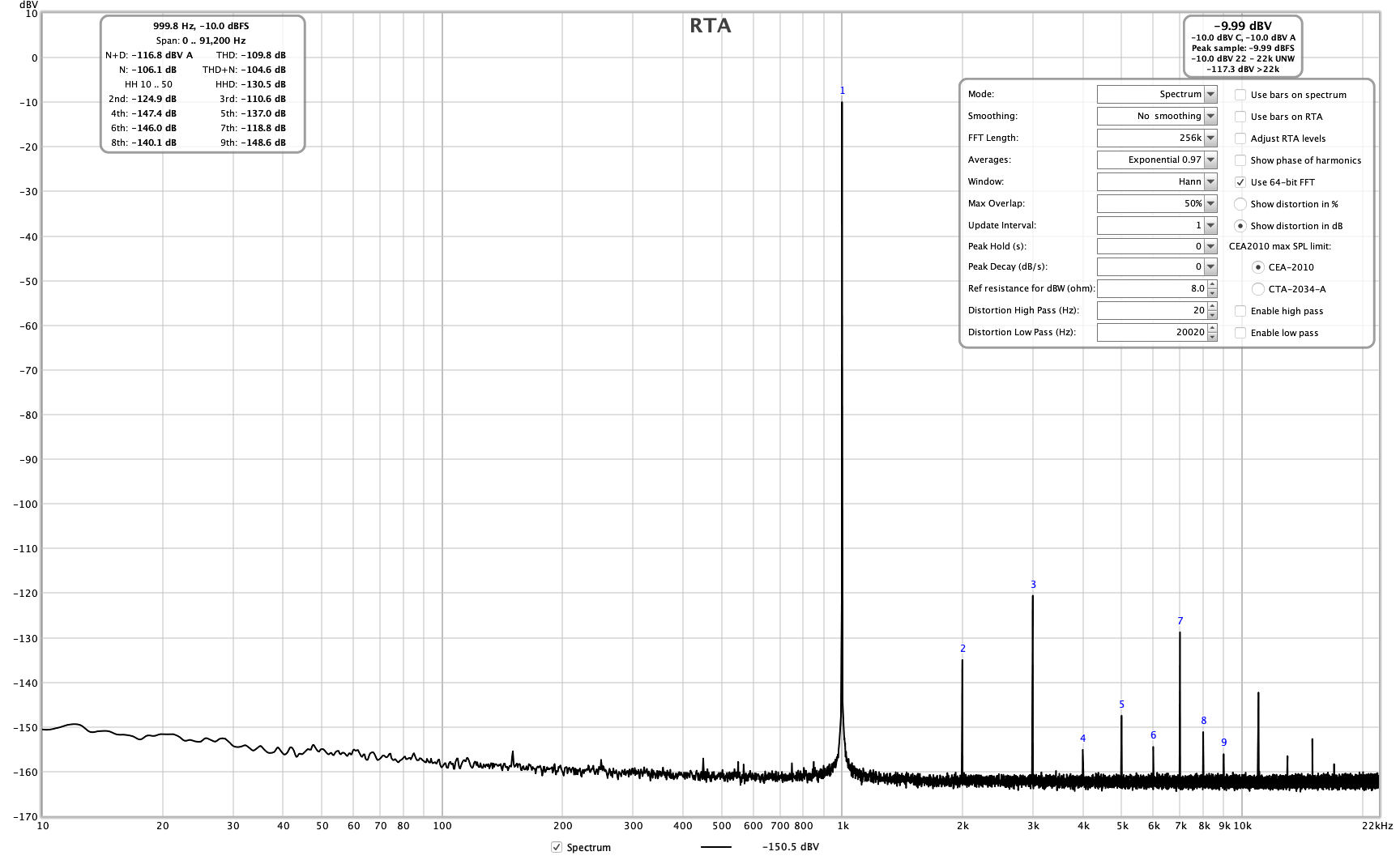

Unfortunately I am on the road.. had to dig up other people's graphs..
Here it is one from lemon, I hope he don't mind..
Post 1773
The cursor snows -148dBV noise floor - at 80Hz.. at 10 kHz it is < -150dBV..
He used 44kHz , very probably proper 24bit resolution, 32ksamples FFT.
I used to use much higher FFT resolution, so deeper noise floor..
Post 1773
Now with 256k FFT - 339A still almost 10dBV better noise floor.
The first series of measurements was with 32k FFT.

@bozidarms: take look here. Scroll down and you'll find a loopback spectrum that was measured with your device (i.e., the one you bought from me). The noise floor is at about 10 nV, or about -160 dB below the fundamental. Maybe your (not-so) "bad" noise floor is just a simple matter of how you set up your software, or maybe the loopback wiring.

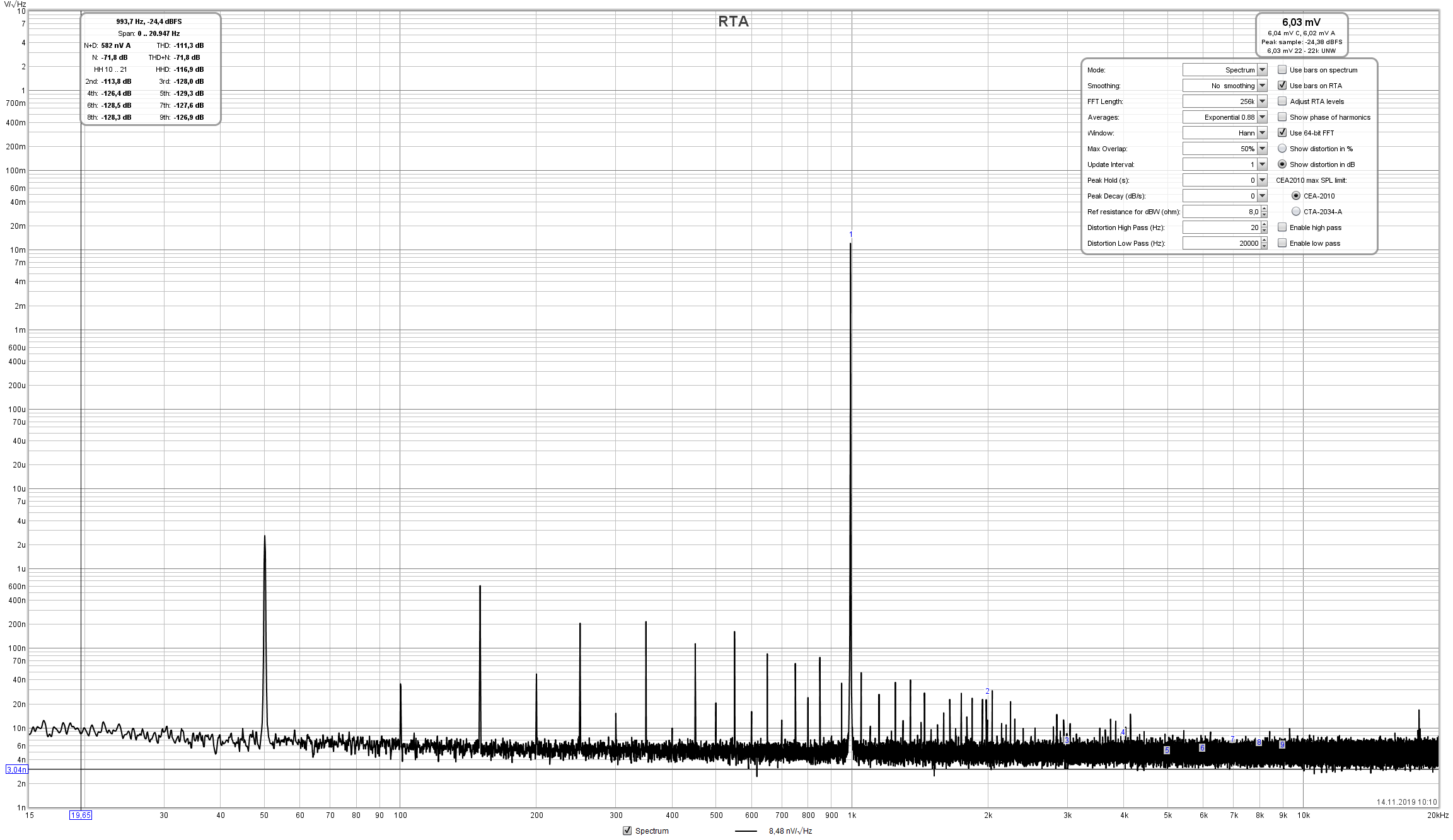

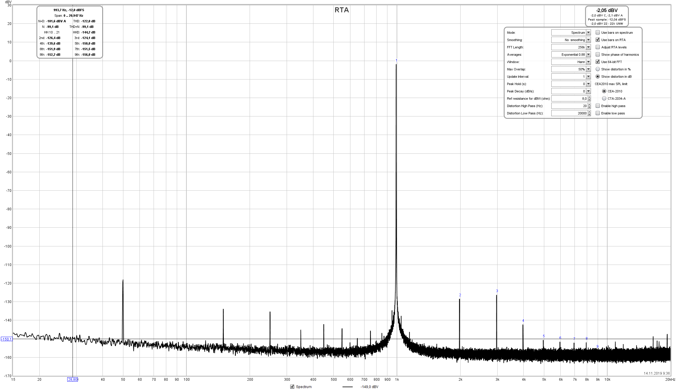

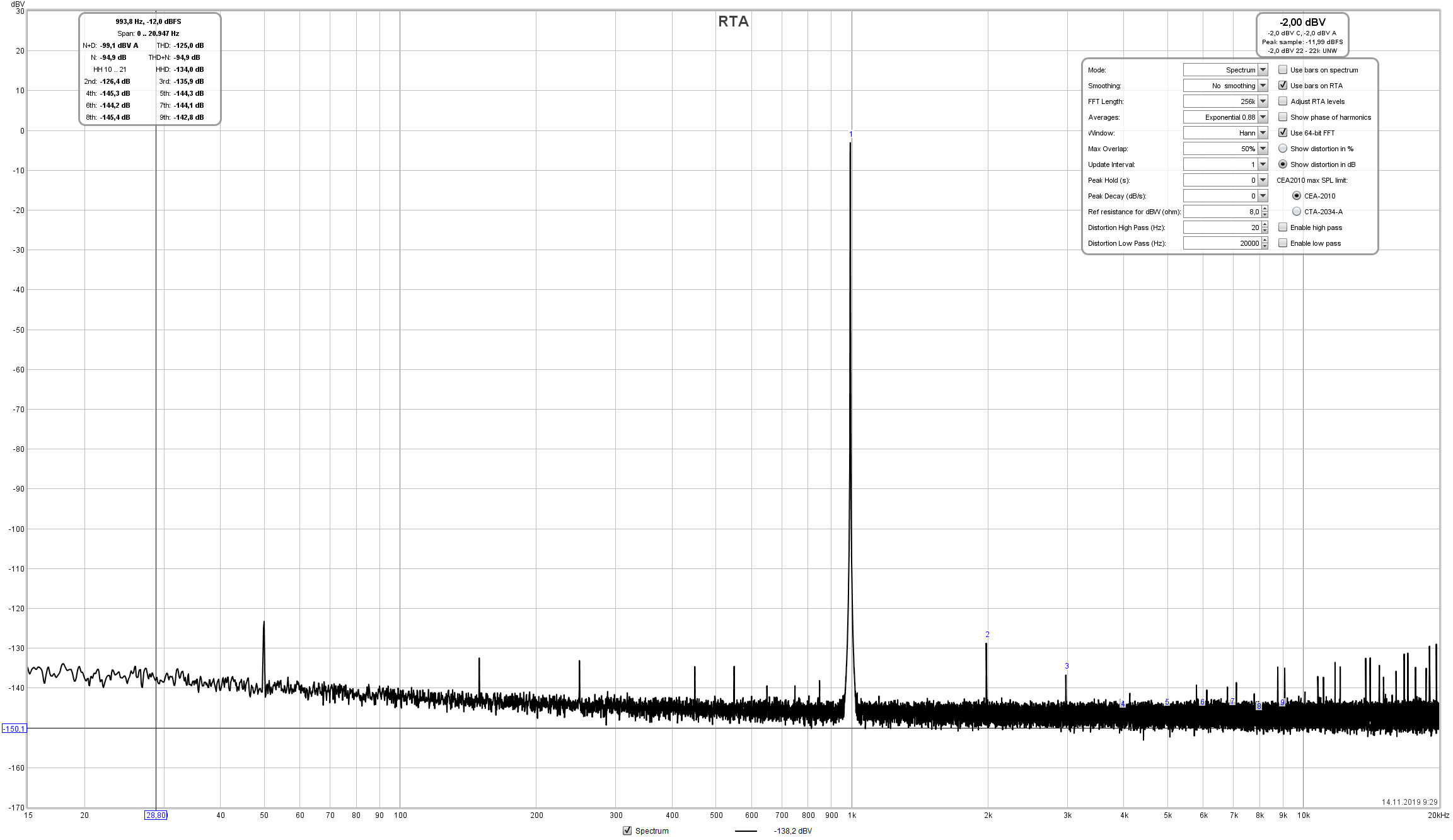

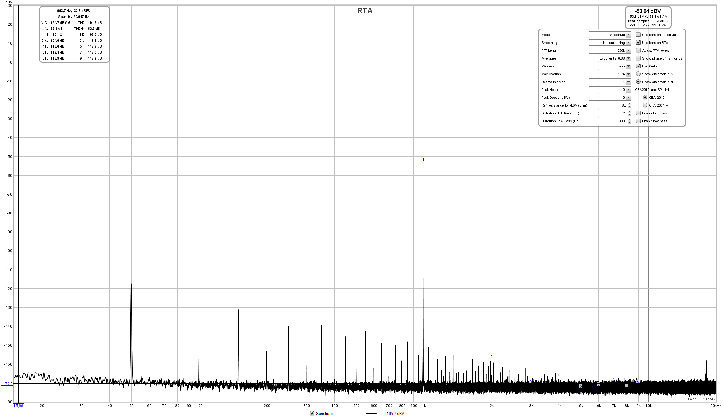

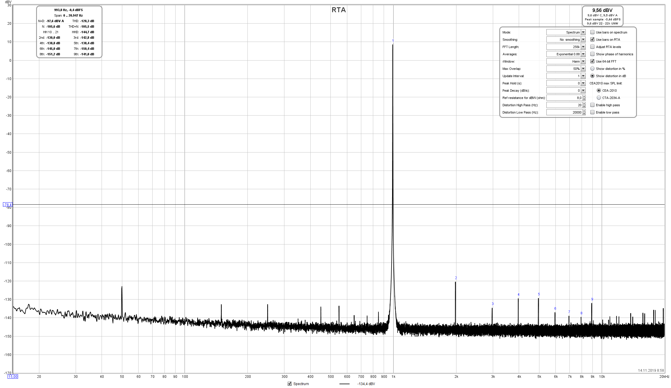

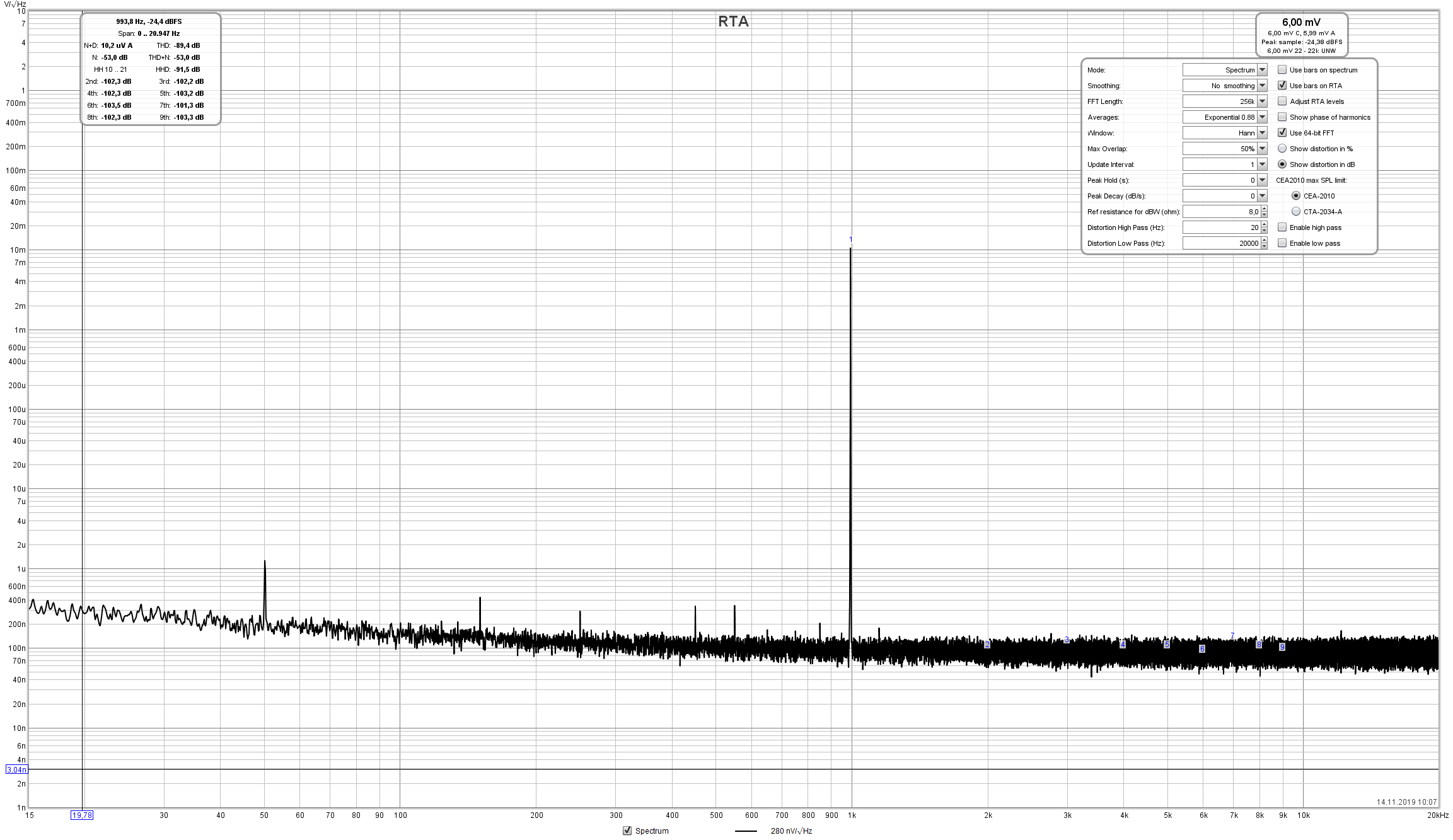

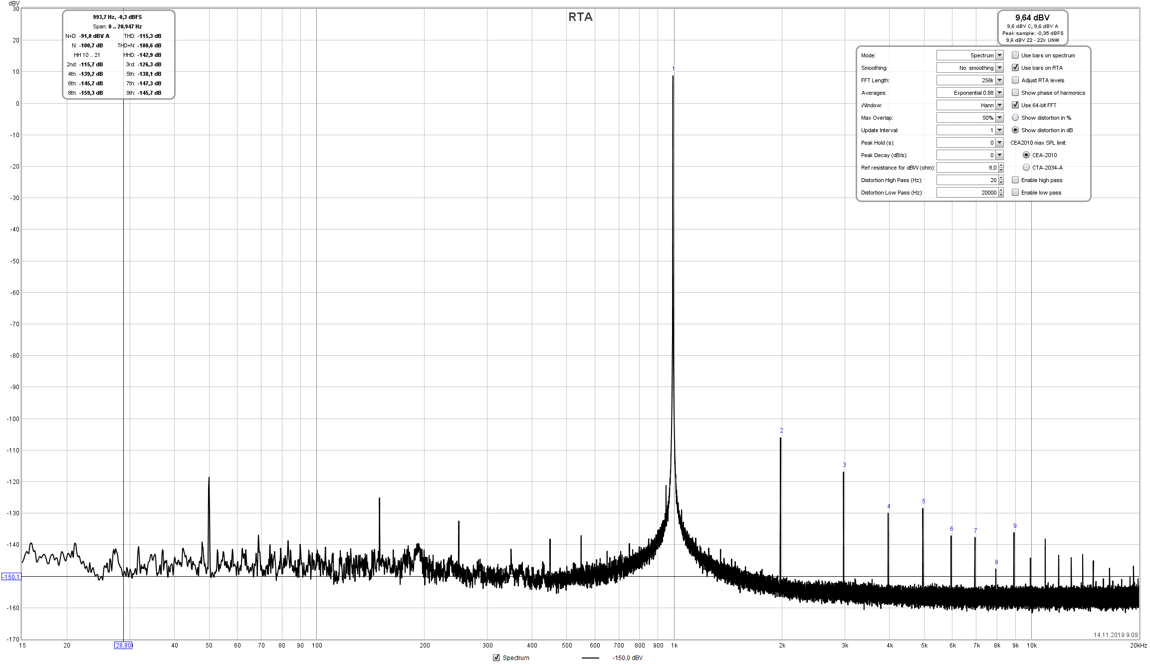

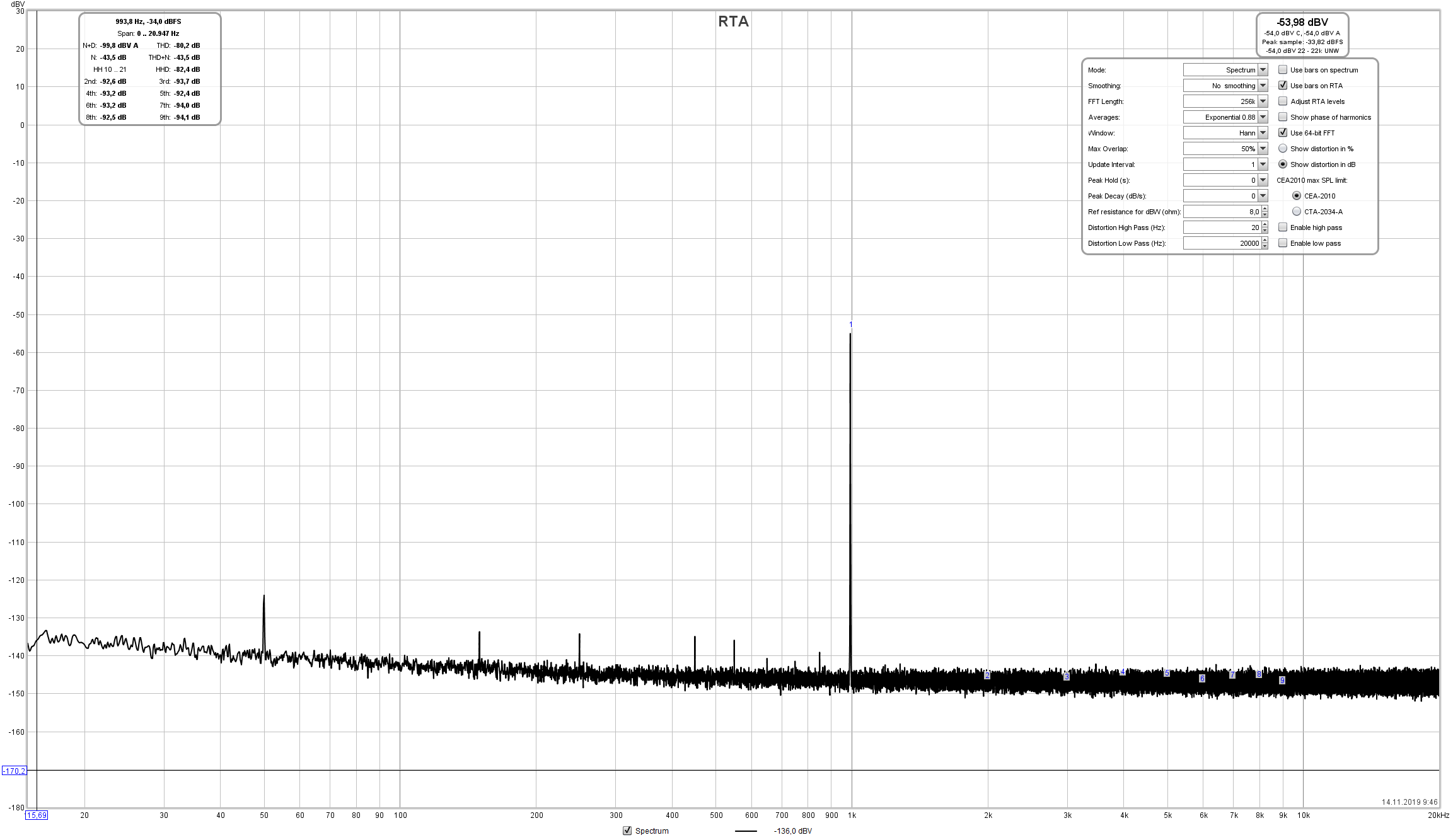

Sure, all signals was the same and measured under same circumstances (levels, scales...).For signals over 1V the difference is not so evident, but for low level signals the difference is enormous - look at curves for 6mV input signal.
THD+N 71:53, THD 111:89
There is one difference over 20dB in noise floor - conditions in measurements was the same!
This low noise floor and ability to measure low levels is that what wonder me at most, not a competition between the two oscillators.
Or to say that other way - the noise floor and SNR of 339A is always better, specially on signals under 1V. Simply i haven't expect that, have tough undoubtedly that RTX oscillator is superb in every way.😱

339A signal 3V, 9,54dBV, -0,44dbFS on 3,16V RTX analyzer scale.png152.2 KB · Views: 306
RTX signal 3V, 9,54dBV, -0,44dbFS on 3,16V RTX analyzer scale.png139.6 KB · Views: 322
339A signal 0,8V, -2dBV, -12dbFS on 3,16V RTX analyzer scale.png140.8 KB · Views: 305
RTX signal 0,8V, -2dBV, -12dbFS on 3,16V RTX analyzer scale.png142.1 KB · Views: 303
339A signal 2mV, -53,9dBV, -33,98dbFS on 0,1V RTX analyzer scale.png137.3 KB · Views: 291
RTX signal 2mV, -53,9dBV, -33,98dbFS on 0,1V RTX analyzer scale.png134.8 KB · Views: 90
