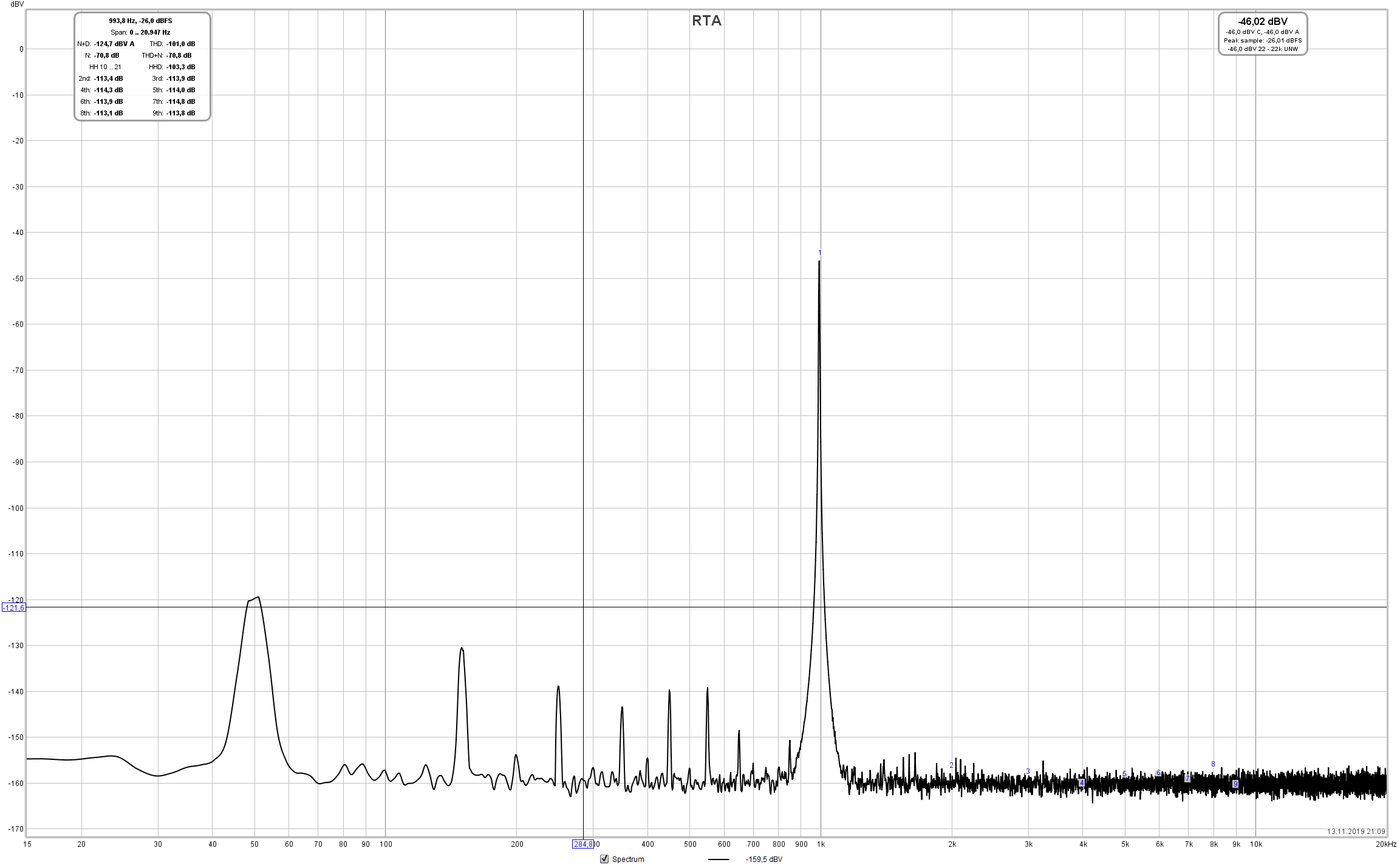

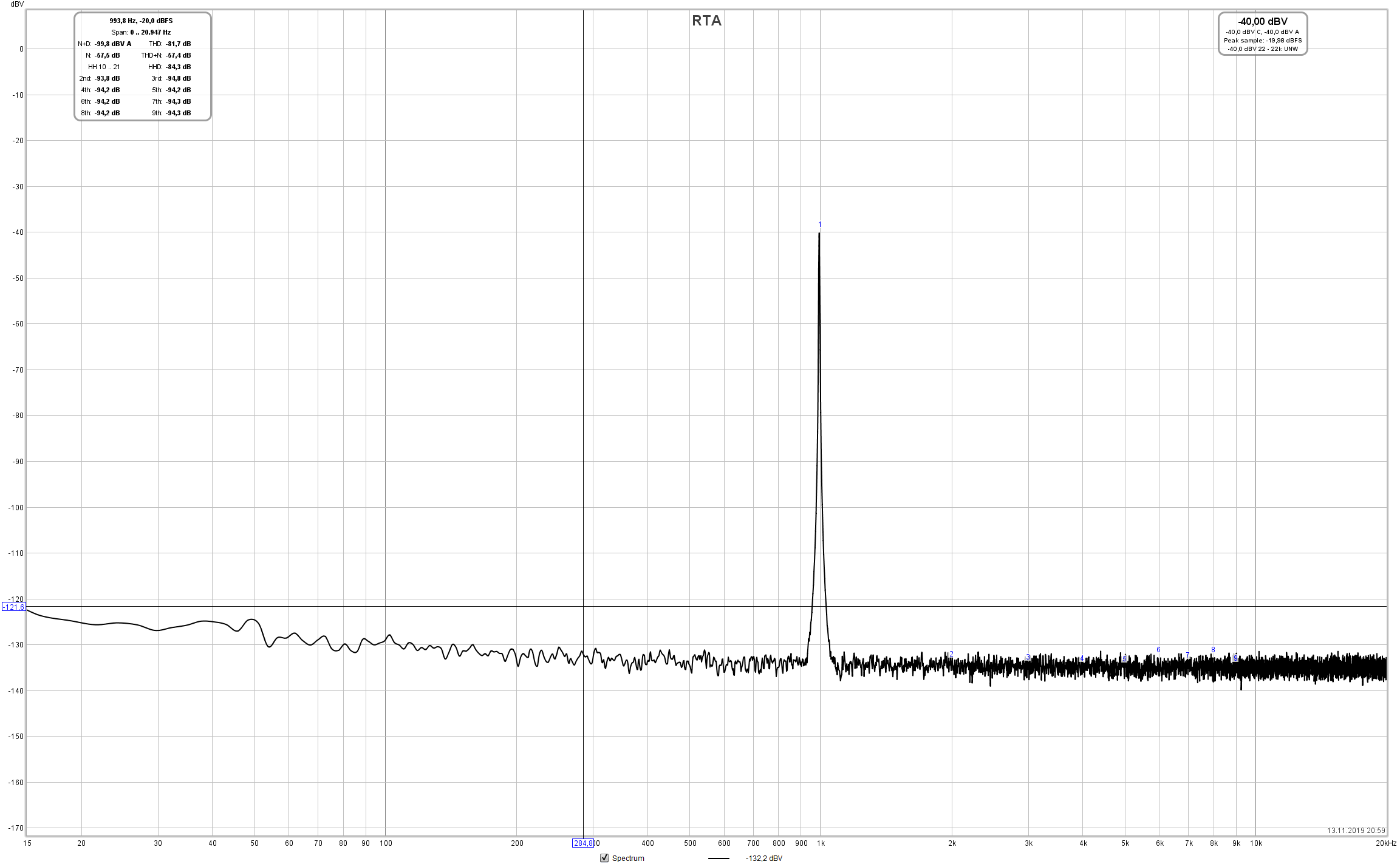

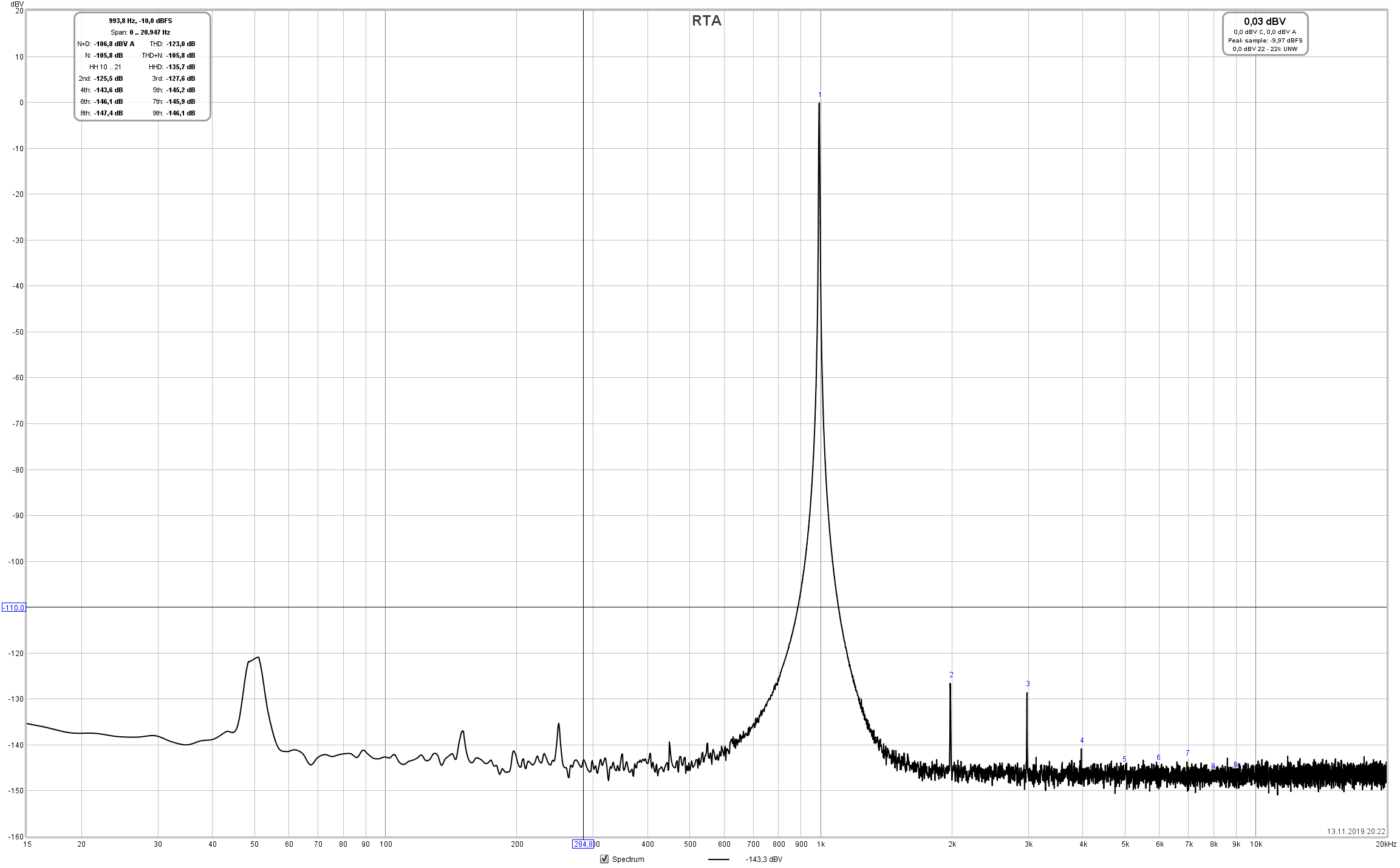

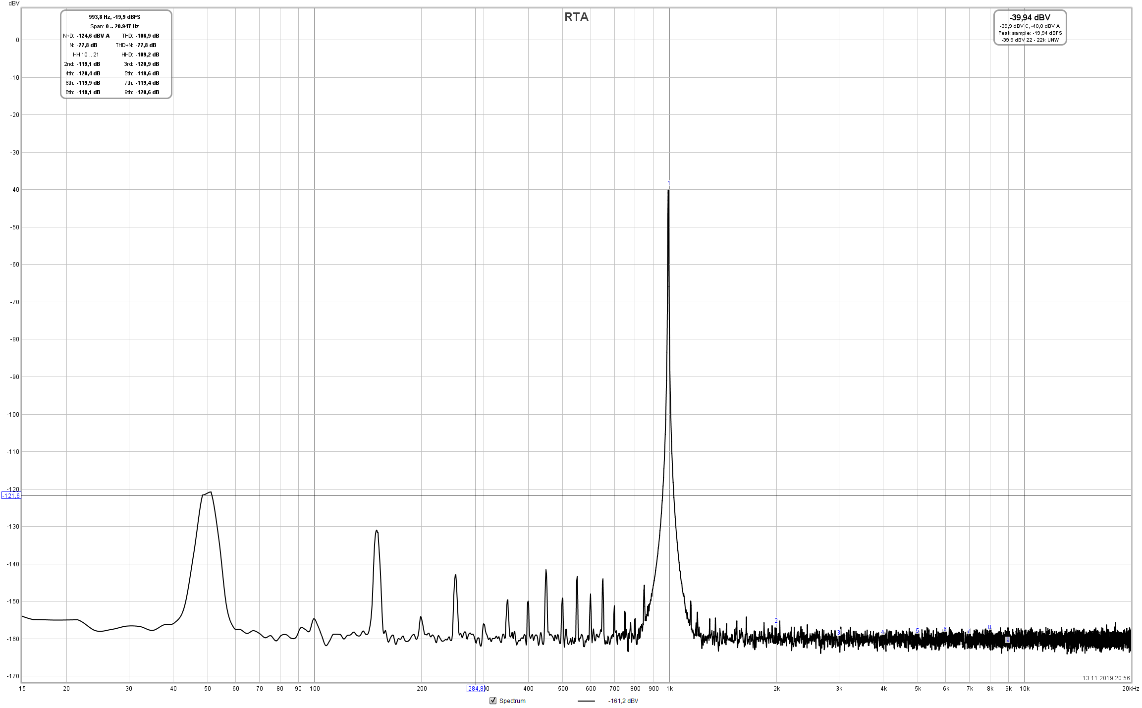

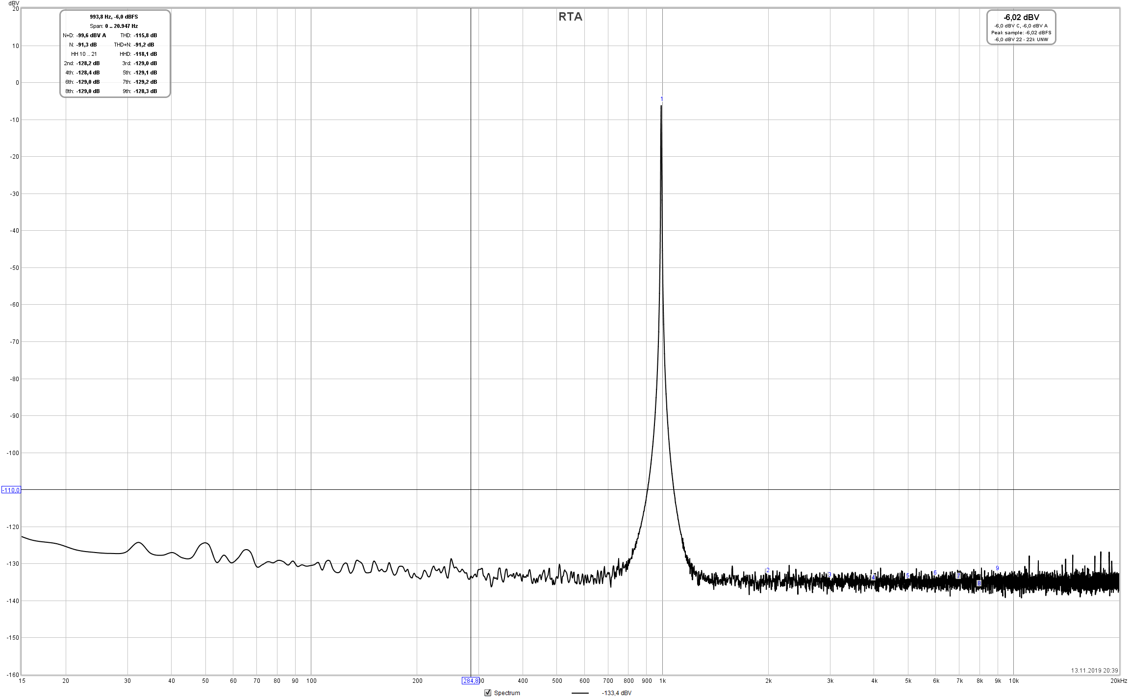

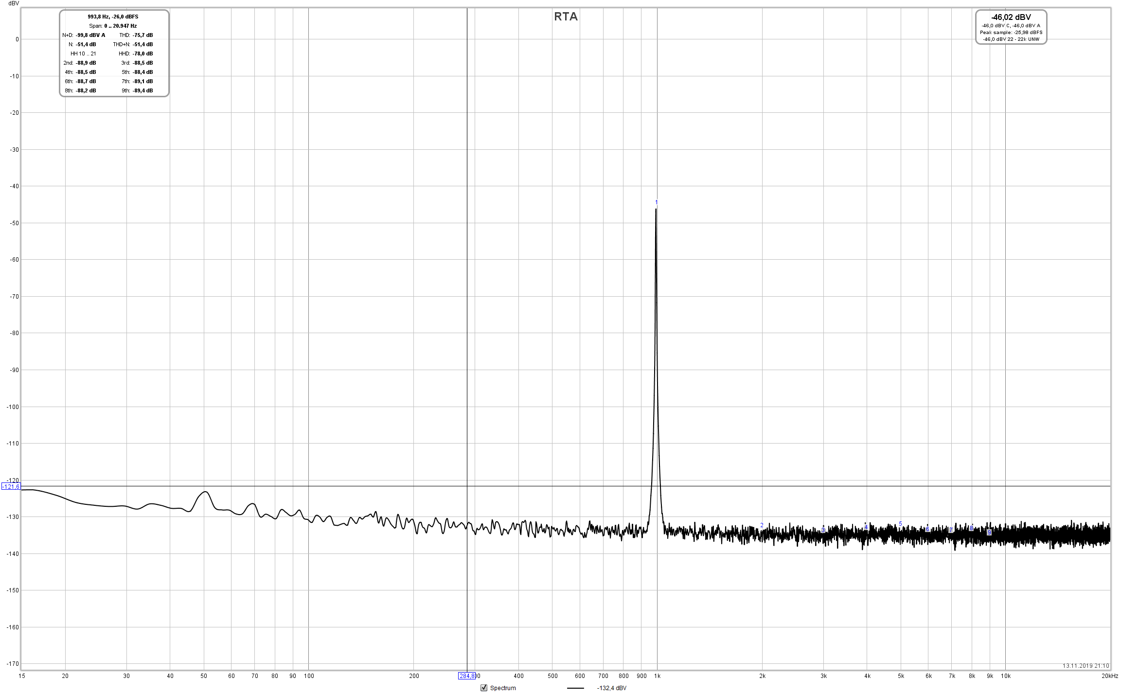

Just for fun, i have measured (with RTX6001 analyzer, under same conditions) two oscillators:
1. - oscillator in HP339A and
2. - oscillator in RTX6001.
RTX was measured in loopback with xlr Neutrik cable. Signal from 339A is feed thru RG58 coax and Neutrik chinch to xlr adapter-far from ideal!
At first, I couldn't believe but it is evident - 339A oscillator has lower noise floor, partially over 25dBV better than RTX😱 specially by low level signals!
How could be that one over 40 years old design so superior is😕
I have only changed one old OpAmp for LT1468 in oscillator part of 339A, nothing else, and this 339A is pretty old, from the first ones.
This change was the reason for measurements, but I haven't expect so one difference.
Could it be that something is wrong with RTX?

Those pictures with mains 50 Hz impurity are from 339A
