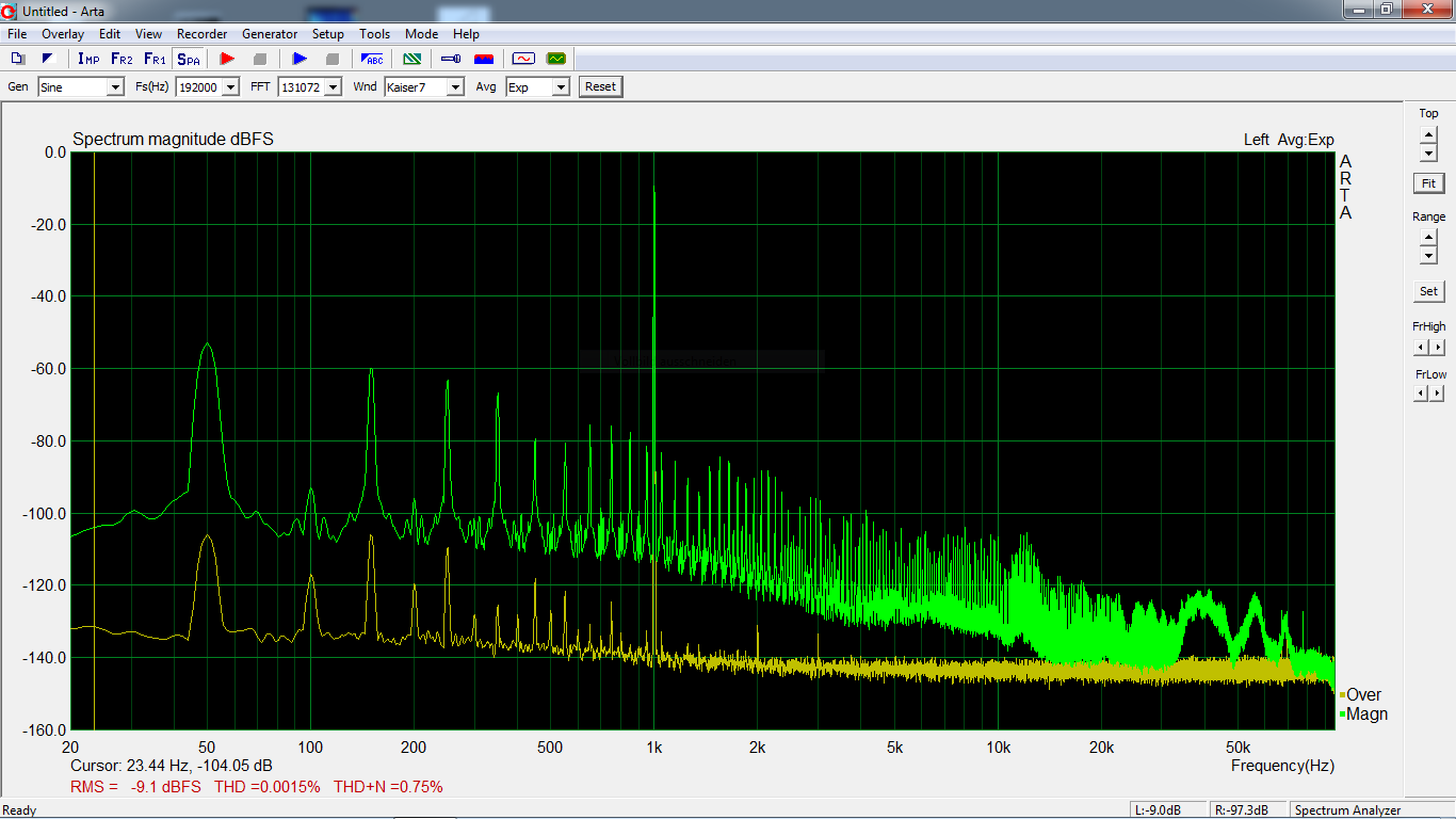

I run into an issue where the line artefacts totally covered the interesting info from the DUT (pre-amp). I experimented with signal cabling and separate grounding cable, things got better but from a certain amplification level on things were just too bad ... until I switched to battery powering of the RTX.
Interestingly the issues did not vanish with battery power and power switch off (so transformer unpowered) until I unplugged the mains cable of the RTX.
One particular thing to mention here is that the RTX and the DUT were plugged in quite distant wall outlets (I could not change that).
Here the overlay of battery powered with and without mains cable plunged in.

Coming back to the line artefacts, power supply issue. Perhaps there is an additional source apart from the transformer stray.

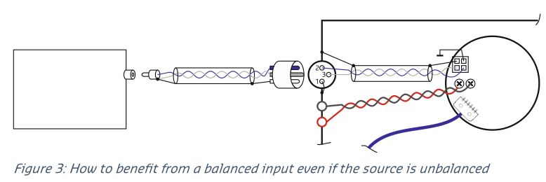

In hindsight I should probably have added an unbalanced input option, with a circuit similar to the one in the Hypex app. note. But a simple adapter cable can be used to achieve the same function. Not quite as convenient, but hopefully not a huge problem either.

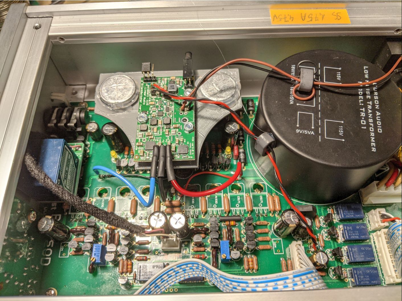

I modified a Burson Soloist Headphone amp to use one of Jan Didden's SilentSwitchers. So now it can be powered from power-bank if one wants and get total ground isolation.

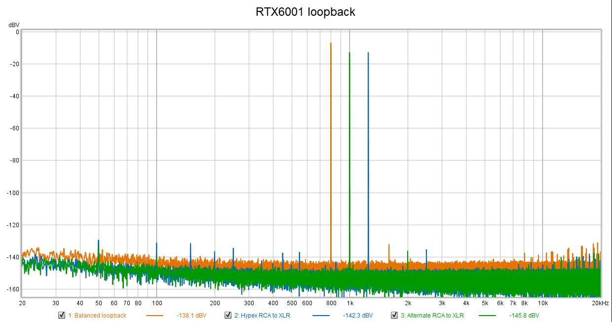

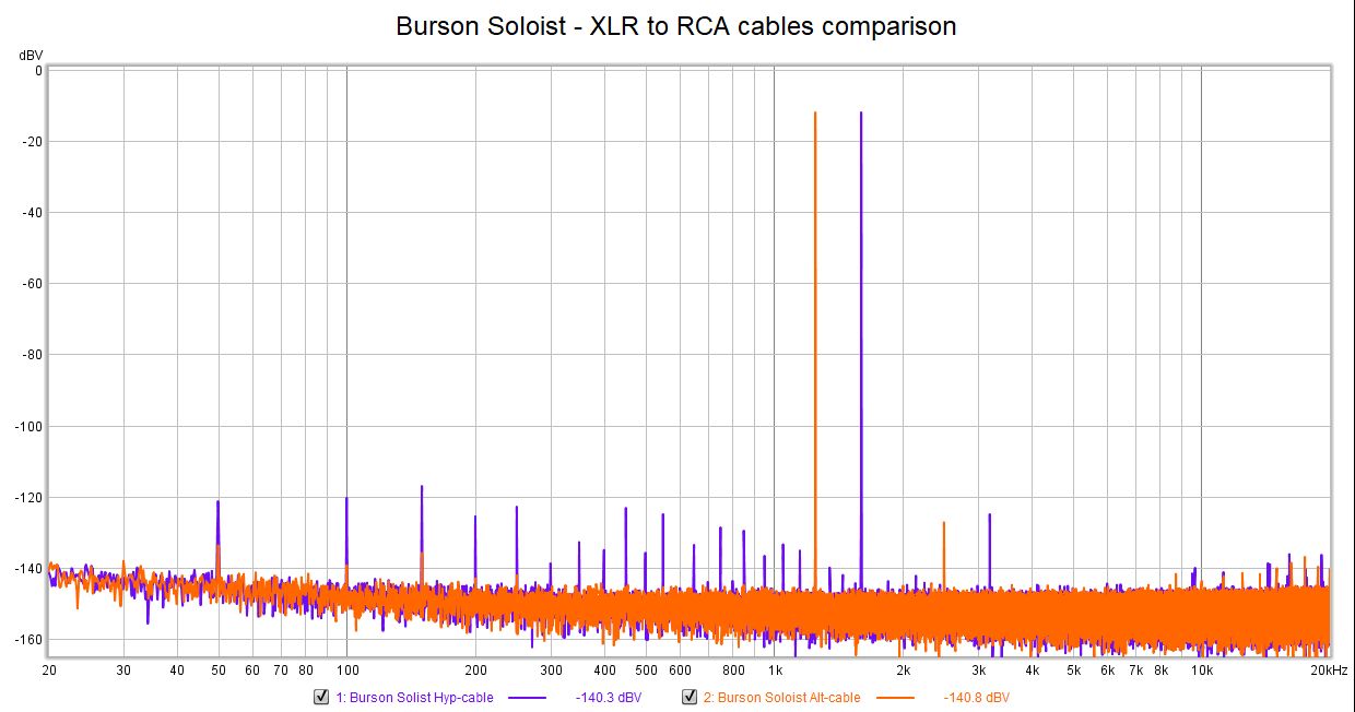

Yet when measuring I saw some 50Hz harmonics in spectrum... I was puzzled at first - how do I get those when the DUT device is powered from battery and thus it should not have ground loops.

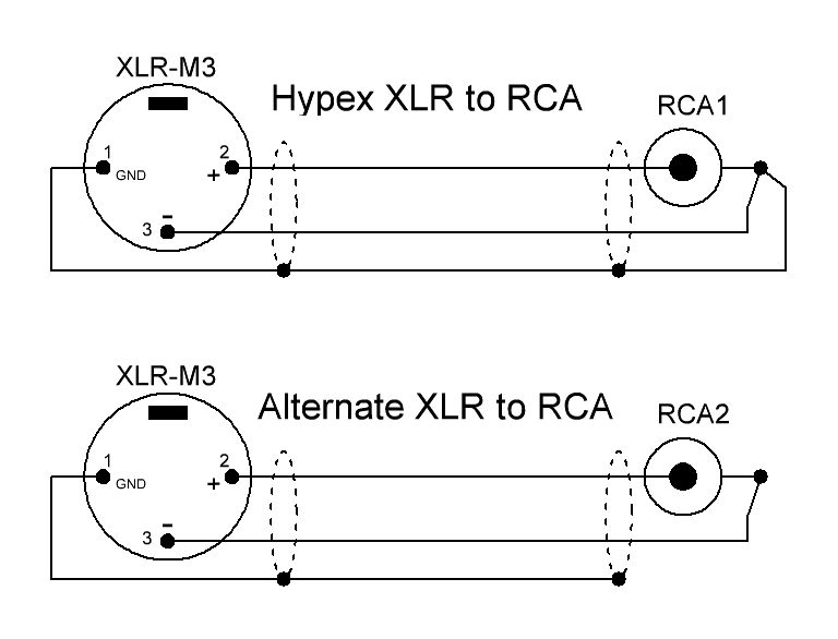

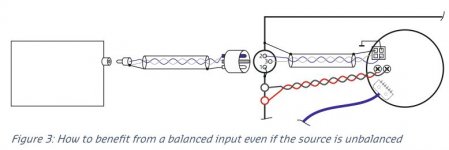

After some experimentation I figured that I had been using a recommended wiring suggested in Hypex NC400 datasheet for XLR to RCA cable going into RTX6001 input, but one could wire the cable also differently as the second diagram shows below. In alternate case I've left the ground/screen of the cable unconnected on RCA end.
The difference it makes is clear... so depending on your DUT device and if it is unbalanced in/out then it might be worth to try both cable types.
Yes, in the top level cabling there's a current running through the screen, that invites hum etc.
But you could also have made this change inside the enclosure shown with the Hypex round circuit, connect the screen One End Only, since the Hypex apparently already is connected to the chassis separately.
Jan

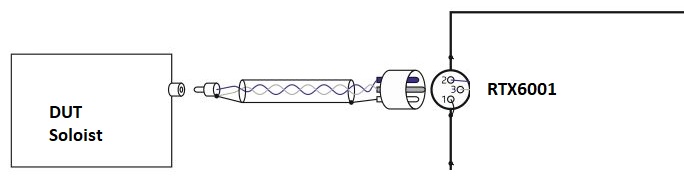

The Hypex diagram was just an extract from NC400 datasheet.

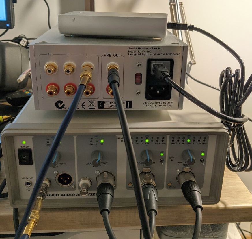

My setup was a loop measurement of the Burson Soloist like so.
PS. Other pic is how your SS lives inside the Soloist 😉
