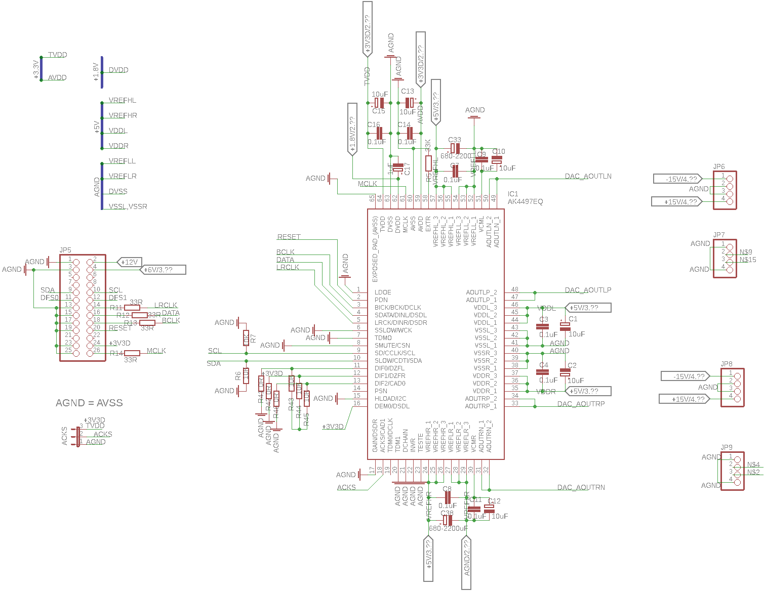

DAC Section with AK4497
From the presentation of RTX new DAC were presented, such as AK4493 & AK4497.

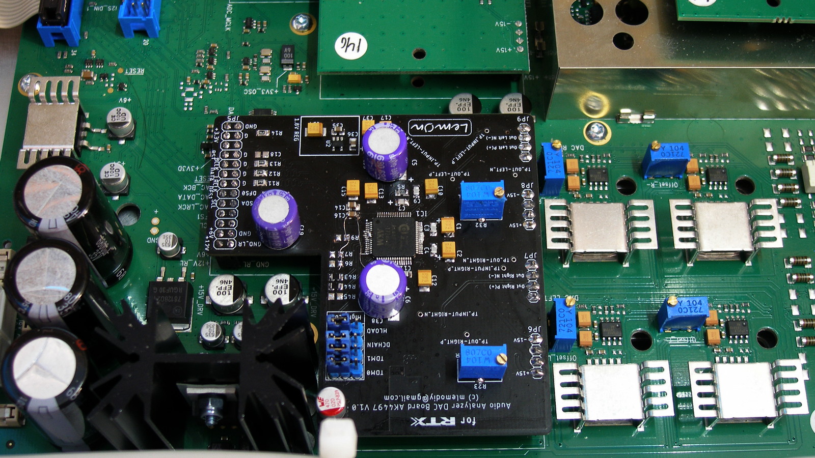

So I thought of making a reverse enginneered on Jen's DAC pcb with AK4497.

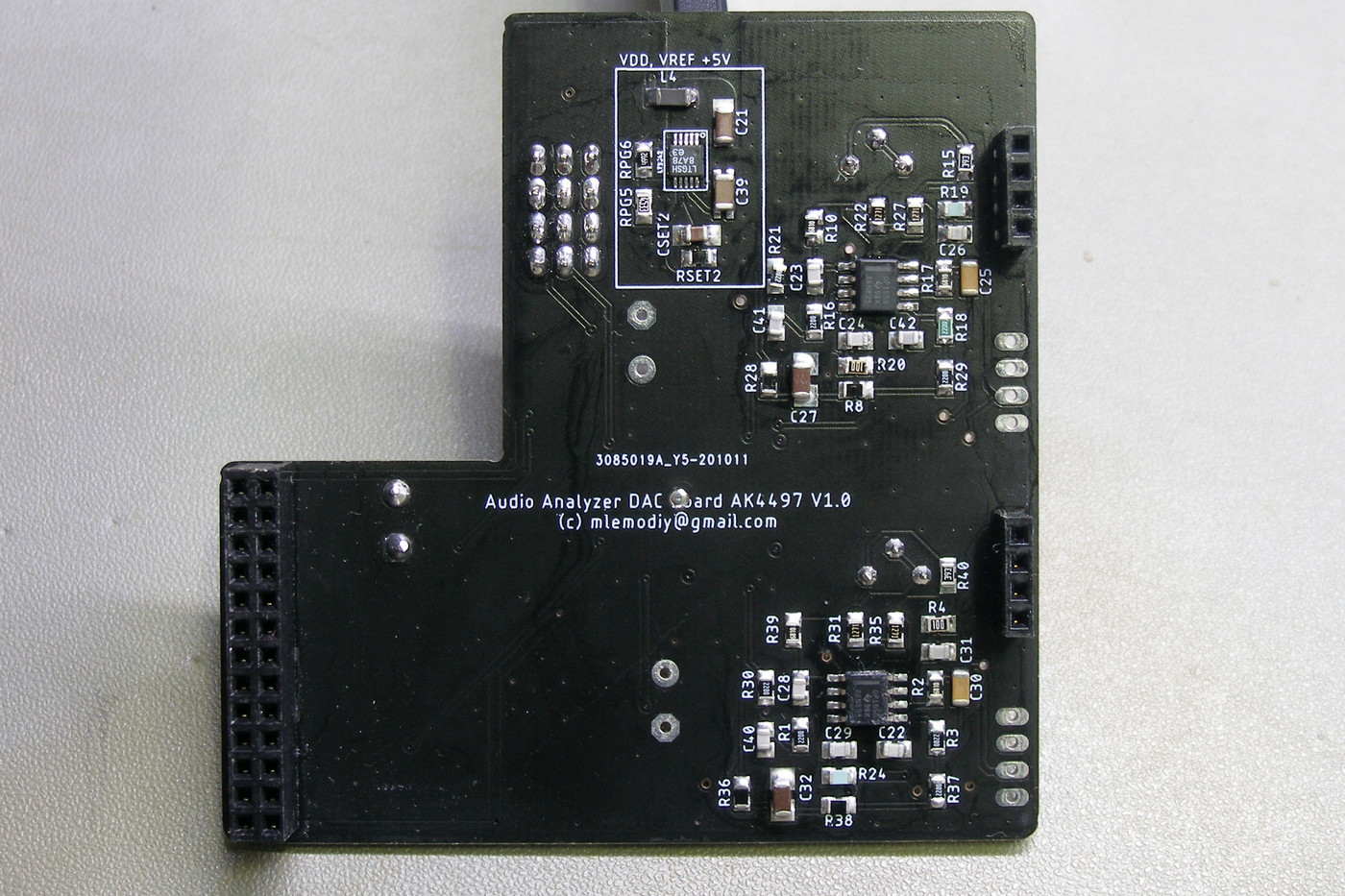

As you can see at the attachments, a prototype pcb has made with the upper part of pcb include the dac chip and the two trimmer resistors of the LPF outputs.
At the bottom there are 5V reg and the LPF sections with OPA1656.
The voltages that AK4497 needs are 5V, 3.3V and 1.8V (via external reg or internal AK4497 LDO).
For the 5V reg, I used a LT3042 configuration.
The 3.3V voltage comes from the 26pins direct and give the input voltage to the 1.8reg (ADP-150).

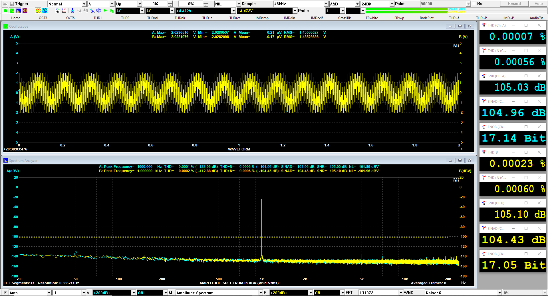

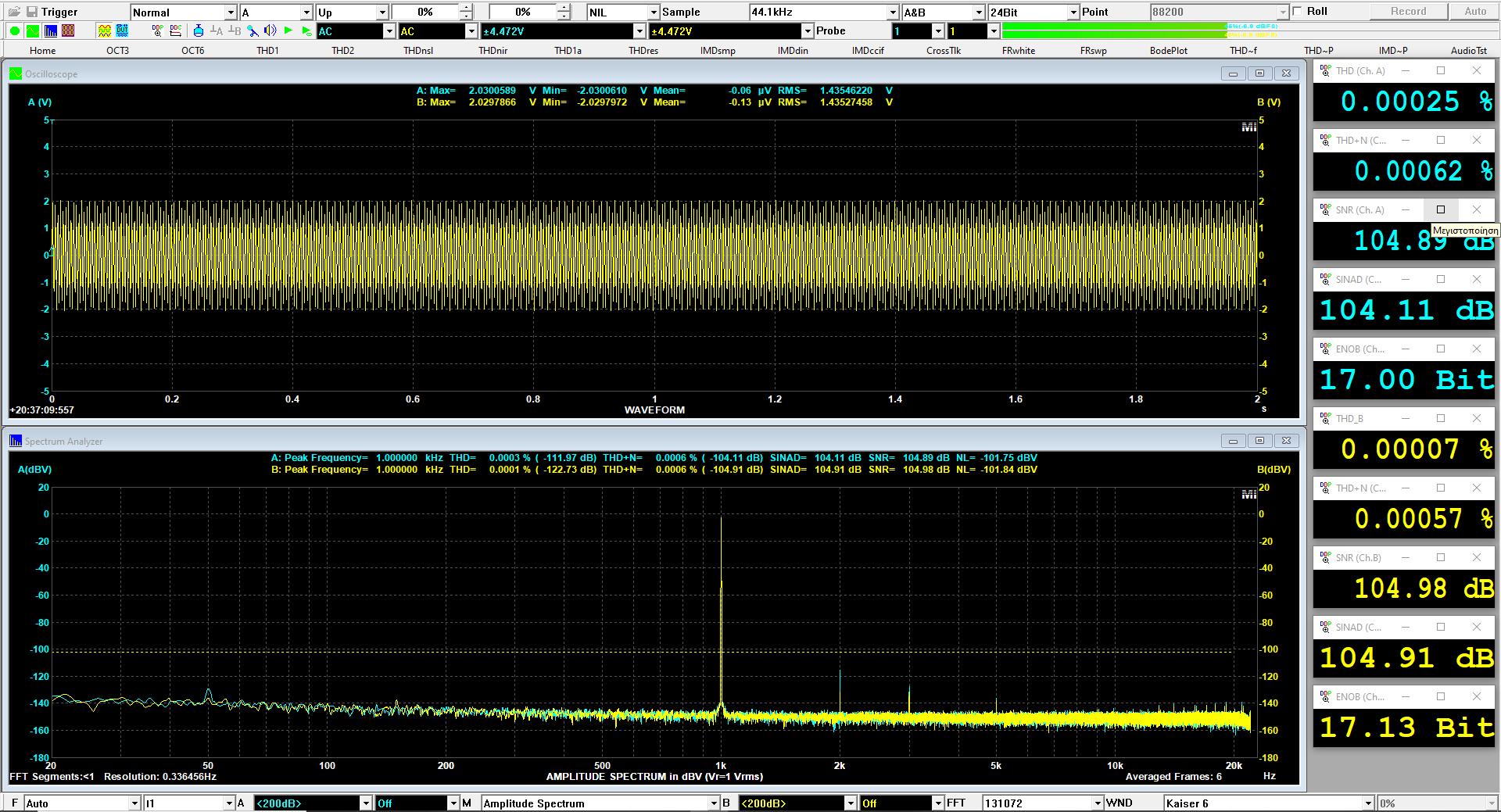

Unfortunately, I have a problem with the THD on L/R channels, that depends with the clock family.
For example, If I set the gen with 44.1K, 2V output (balanced), the THD is 0.00025%/0.00007% (L/R), if the sampling change to the 48K with the same amplitude, the THD is 0.00007%/0.00023% (L/R).
Another problem that I saw yesterday, is the low voltage output of the DAC at high levels. At low dac output levels, the differential output is almost the same between 4490 and 4497, for example with -17dB signal the 4490 has 137mV almost and the 4497 has 140mV.
But, if the level is 0dB, then the 4497 gives a much less voltage, I took almost 1.38Vrms on 4490 and 0.99 only on 4497!
Both of them have the same voltage reference (5V).
I have done some experiments for these issues, like ACKS (H/L set), HLOAD (H/L set), (DIF0-DIF1-DIF2 in combination with TDM0) but with no success.
I am quite sure that the problem is held on digital part, I took a THD measurement on DAC differential outputs and the THD had the same issue.
