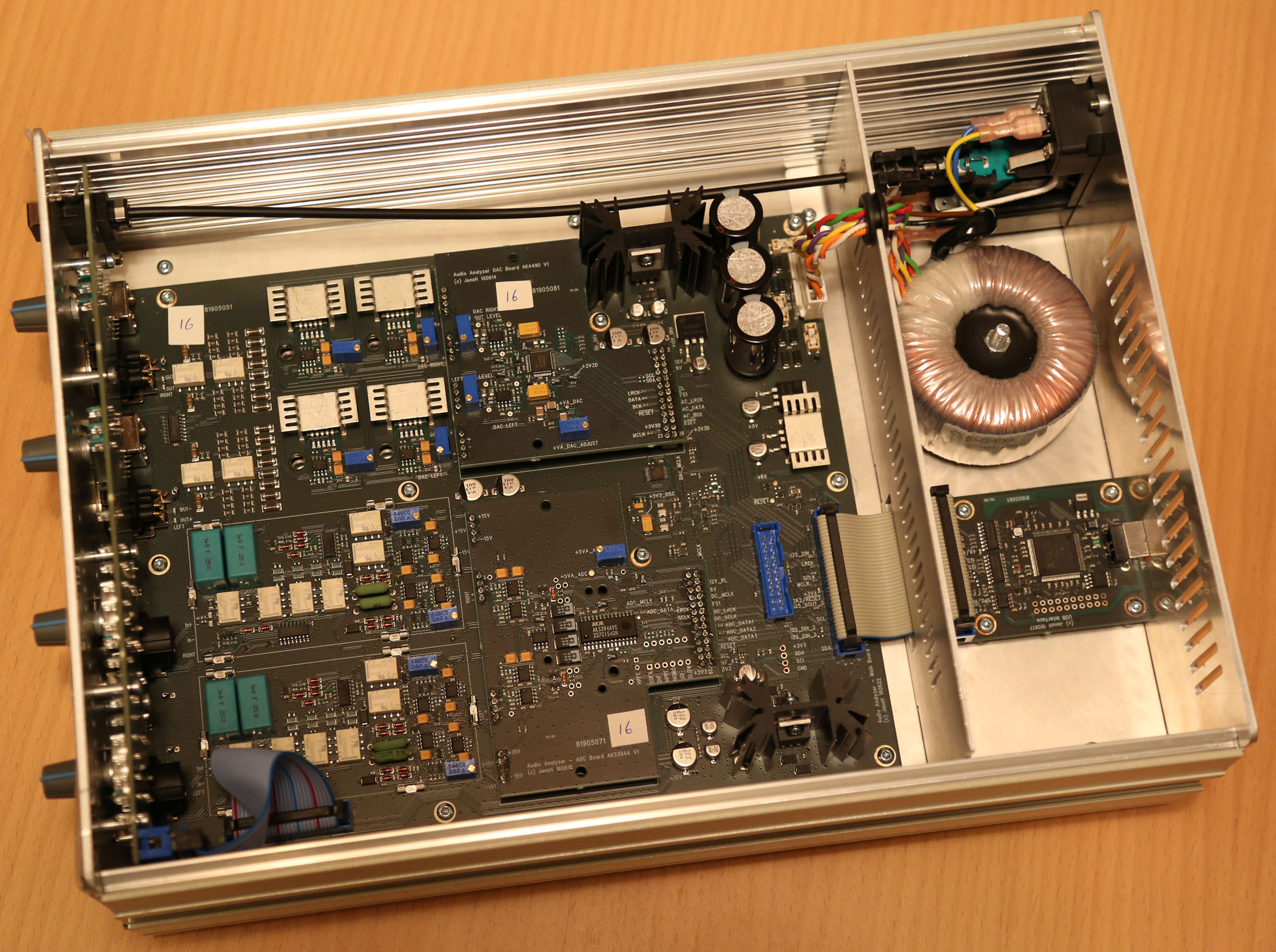

Actually I don’t use simple switchers at all. I don’t know where you get that impression. On the other hand, there would be no problem in using them, as long as it is done right. The QA401 uses 4 x SN6501 for the isolated supplies.

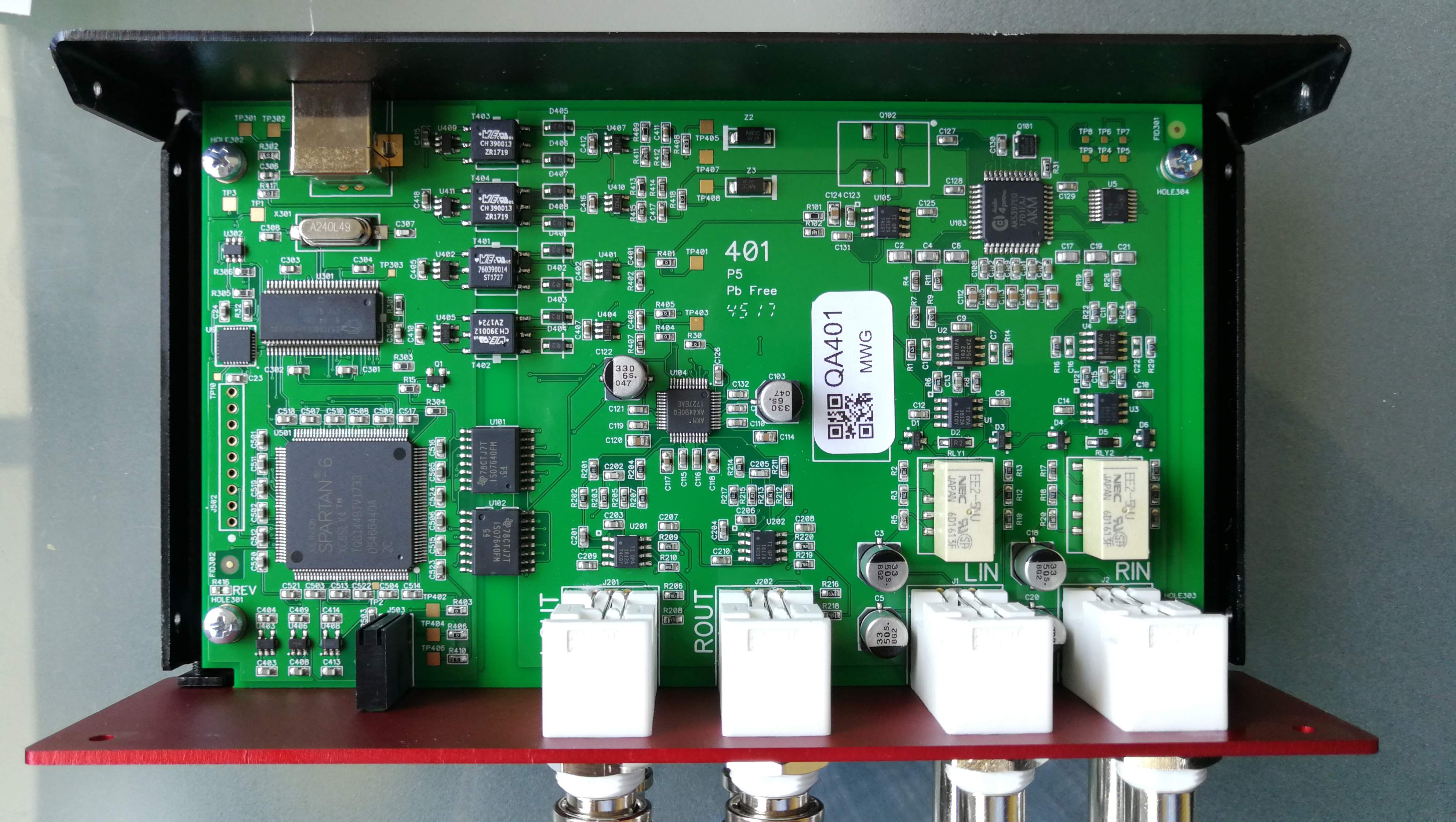

In the following I will assume that you are talking about the QA401.
Regarding the cost. You claim that your “mystery product” (QA401) is “VERY similar, (same converters…” to the RTX6001. Please take a look at the pictures below and tell me again that they are “VERY similar”. (The Picture of the RTX6001 is from the prototype version. Minor changes have been made later on, e.g. added shields over the input stages and heat sink bracket for the ADC).
The converters are not the same! The DAC is the same, but the ADC is not. In my initial design I used the AK5397 (as the QA401), but I changed to the AK5394A, because the distortion of the AK5397 was much higher. If you had followed the thread, or even had read the first post, you would have known this.
Yes, the RTX6001 is a more expensive product than the QA401. This is because better (and more expensive) solutions were chosen. That’s a choice really. I could have designed a lower cost product, but decided to aim for a higher performance, knowing very well that it would increase the cost.
The input stages were one focus area. I use 2 x LSK389 per input, to get a very low noise and low distortion (also with high source impedances), even though they cost in the range of USD 5 each. And 0.1% metal film resistors. And a bunch of relays for range switching, AC/DC selection and overvoltage protection.
The input amplifier and the protection circuit allow me to get a typical noise floor around 0.55 uV over 20 kHz bandwidth. The QA401 has a noise level of 1.8 uV by the way. And AP typically state 1 uV.

To return to actual technical discussion...
You use a toroid and take some care to shield it.
Perhaps your experience in very low noise means you can answer a question about stray field emission from toroids that I have had for a while.
If the primary is simply wrapped about the toroidal core then there are two components of the current.
One is the loop around the cross section of the core.
There is a second loop around the "plan" of the core.
(Think of the core cross section reduced to an infinitesimally thin circle and it is clear there is still a loop around the diameter of the toroid)
This second component radiates a field that is not captured by the core permeability.
Are there any steps taken in commercial toroid transformers to cancel this field, do "low stray field" transformers eliminate the problem or just add a shield or strap?
