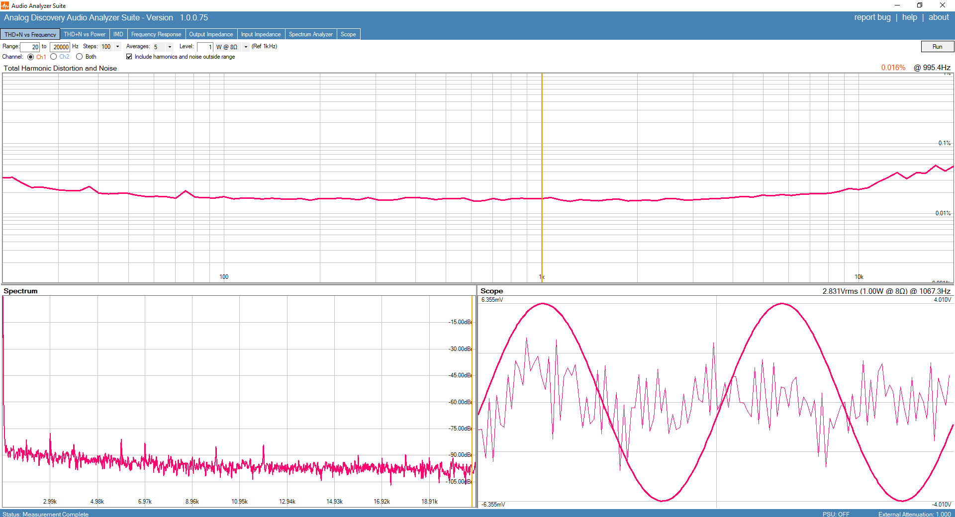

I can’t seem to grow accustomed to using the RTX6001 for the simple reason of not being able to find software that’s not cumbersome to set up and use. I am a long time Analog Discovery with Audio Analyzer suite package user and I absolutely love it for its ease of use and simplicity, it is what I use on a day to day basis for quick analysis and measurements.
Is a similar software suite available for the RTX6001? I don’t mind spending a bit of money on software that allows me to operate my RTX6001 in similar fashion as I’m familiar with with the Analog Discovery.

I want to be able to simply generate graphs as per the attached image, without having to spend an hour clicking in different menus to set this up. In that regard the Audio Analyzer suite for the Analog Discovery 2 is a godsend!
Are you familiar with GNU Octave (Matlab)? If yes, take a look at MATAA, which will allow you to do all of this (and much more). It also allows automatic scaling of the signal levels according to the level switches at the RTX 6001.
I'll take a look, thanks for the suggestion!

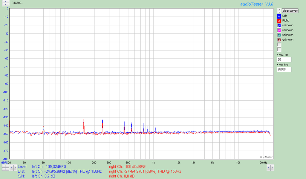

I have received some new transformers, with shield and reduced flux. I replaced the existing transformer by the new one and measured the magnetic radiation directly above the transformer as well as the input noise level with shorted inputs.
Unfortunately I didn't get the improvement I had hoped to see. Perhaps a few dB, but not a major improvement.

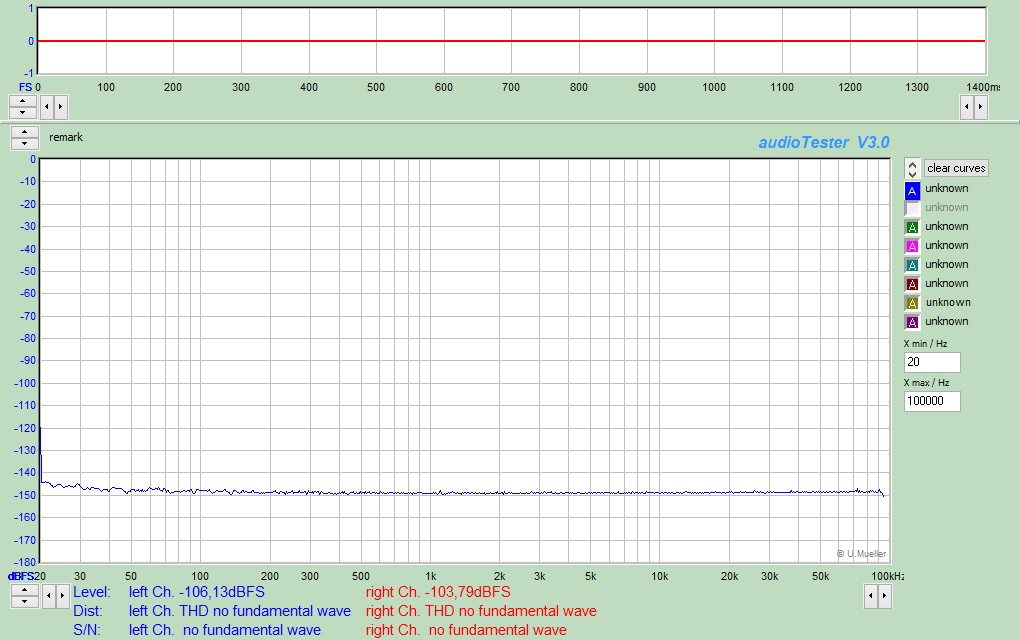

In parallel I have made a small board with a couple of DC/DC converters. With an input voltage of 18 V the DC/DC converters deliver +9 V and -18 V. The +/- 18 V and 9 V can be used to supply the RTX6001 instead of the transformer when connected to the 6-pin power connector on the Main Board. So no changes to the Main Board.
I have shown the measured noise with the shielded transformer and the DC/DC converter solution below. It is fairly easy to pick the winner 🙂
The external PSU switches at around 65 kHz.

Jens, not too surprised re the lack of improvement with shielded XFR. After my previous mails on the topic I spent quite a lot of effort umetal screening the production XFR as fitted in its production location with little improvement. Whatever is going on is quite subtle. I would experiment more but cant risk damaging what is a pretty expensive bit of DIY kit.
