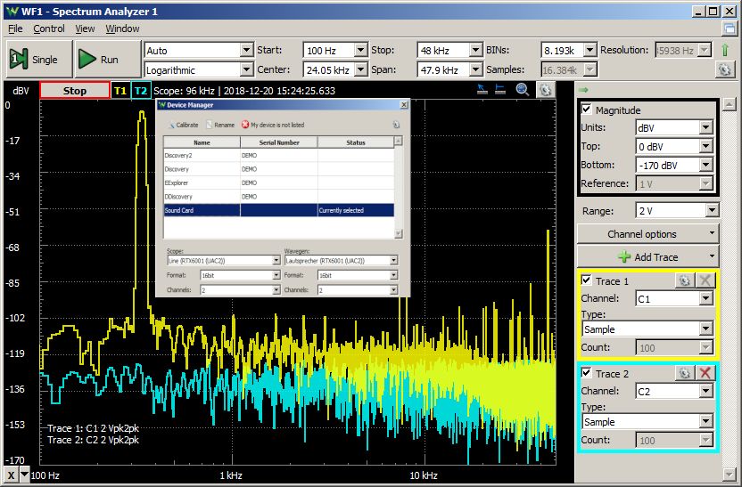

RTX6001 doesn't work with Digilent WaveForms
Digilent has a nice software for free: WaveForms.
WaveForms was originally made to work with Analog Discovery. Using a soundcard is also supported.
WaveForms works nicely with eg. Lynx L22.
While RTX6001 works fine with software like Arta, AudioTester, SpectraPlus, REW, it doesn't work with WaveForms.
Would be just great to have this option, too.
Any chance?

RTX6001 input is read by WaveForms (see attached picture; left: signal from an external function generator, right: from RTX6001 output while generator is running).
=> there is no signal generated by the generator... why?
Ulli
Ulli
It isn't problem of RTX but it is problem of WaveForms.
What driver have you setup on WaveForms?
Do you tried the asio4all?
WaveForms seems to use a standard windows audio device.
See analog-discovery-digilent-post5640700.html
asio4all would be an option when an ASIO interface is addressed. Issues caused by Windows would most likely remain.
