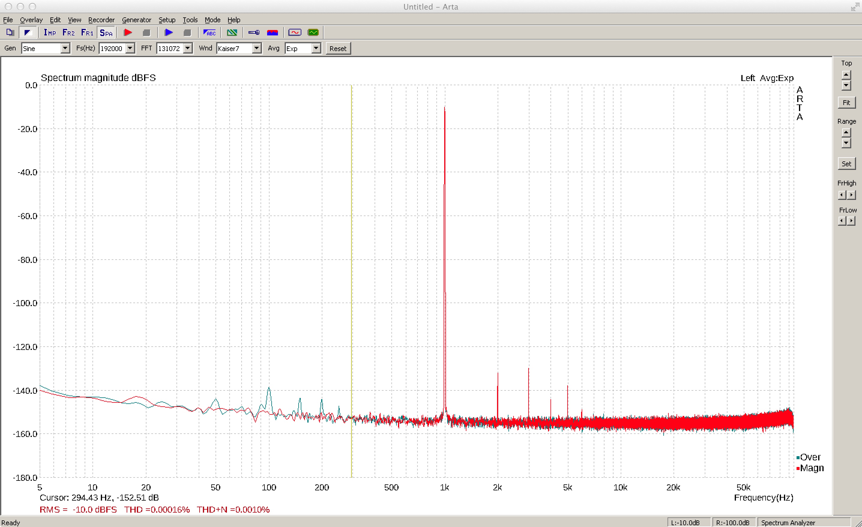

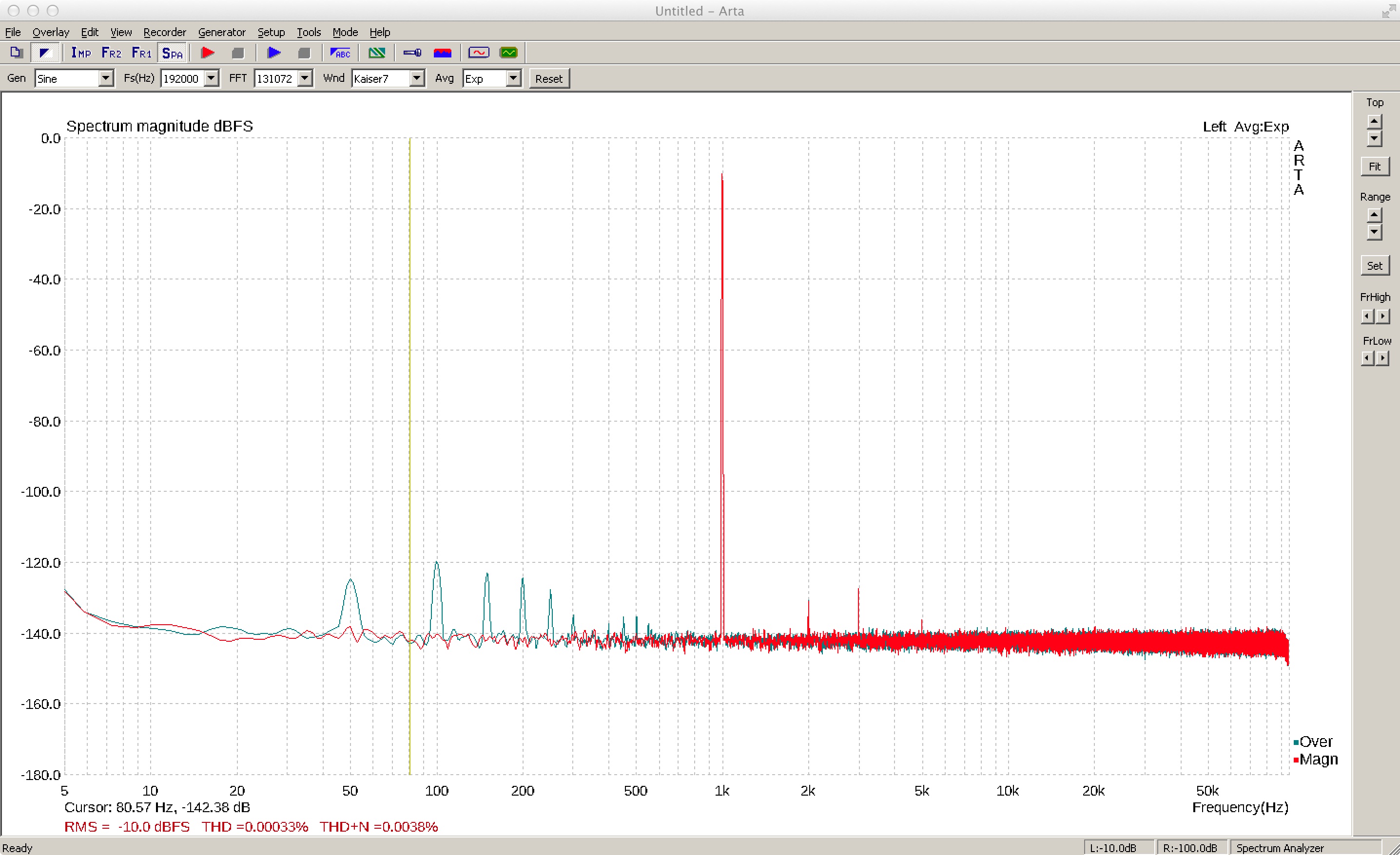

Before anyone thinks I only stubbornly refuse to choose the correct wiring for unbalanced measurement 😉
The effect is, to a smaller extend, also present with the recommended "figure 17" wiring for unbalanced measurement.
Here a loopback with 0dBV in- and output setting
and with -20dBV in- and output setting.
I leave it to you to guess which color is line powered and which battery powered.
@NicMac: No I did no new current measurement, but I see no reason why it should have changed from the 0.3A on each rail with the SMPS.
