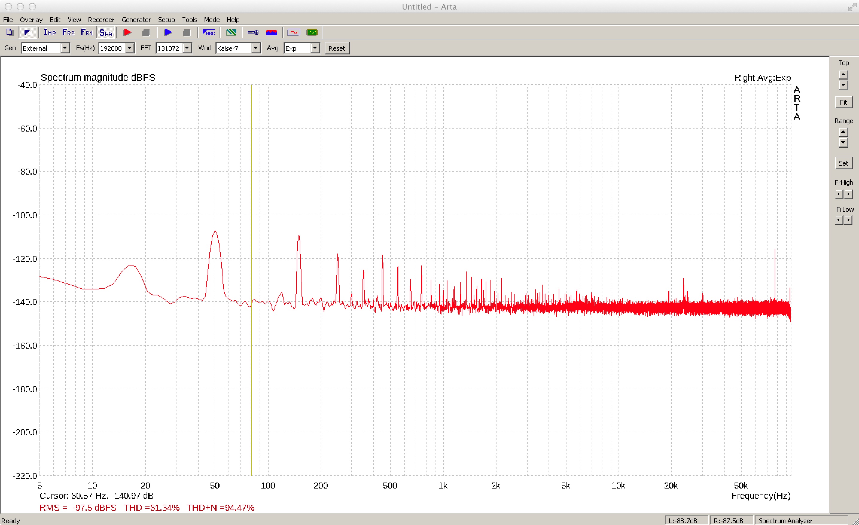

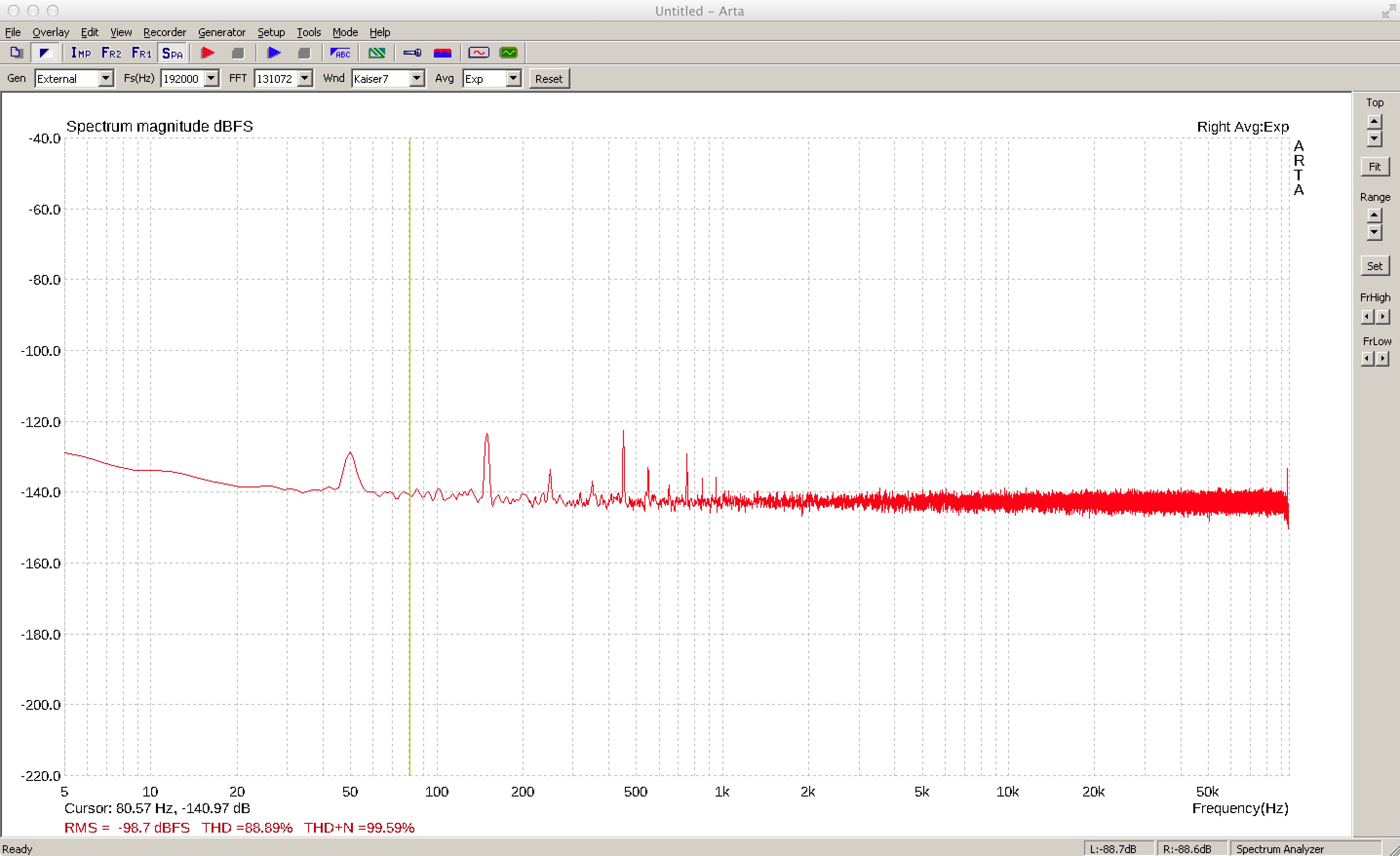

I agree that the noise looks suspiciously low. It is difficult to read the exact value, but in the flat region it could be something like -177dBV/sqrt(Hz). This is equivalent to 1.41 nV/rtHz. The input noise is low, but not quite that low. I would expect something like 4 nV/rtHz.
@PaulBC
Can you provide some details of the test setup, like cable connections, terminations etc.?
@JensH, you are right. It was just a simple stupid mistake. I thought the unit of the input gain setting in ARTA is dB, therefore I set it as "20". However, it is a 20X gain, not a 20dB gain (i.e., 10X gain). That is why the noise floor is only half of the expected value. My apologies.
The key I posted this screenshot is to show there is no 60Hz harmonics under the -20dBV input configuration if the transformer is moved away, not the noise level. It is just a shorted-input measurement. However, even a shorted-input measurement, these 60Hz harmonics are also there under the -10dBV and -20dBV input configurations with the internal transformer. Therefore, moving the transformer away benefits not only single-ended but also low-level balanced measurements.

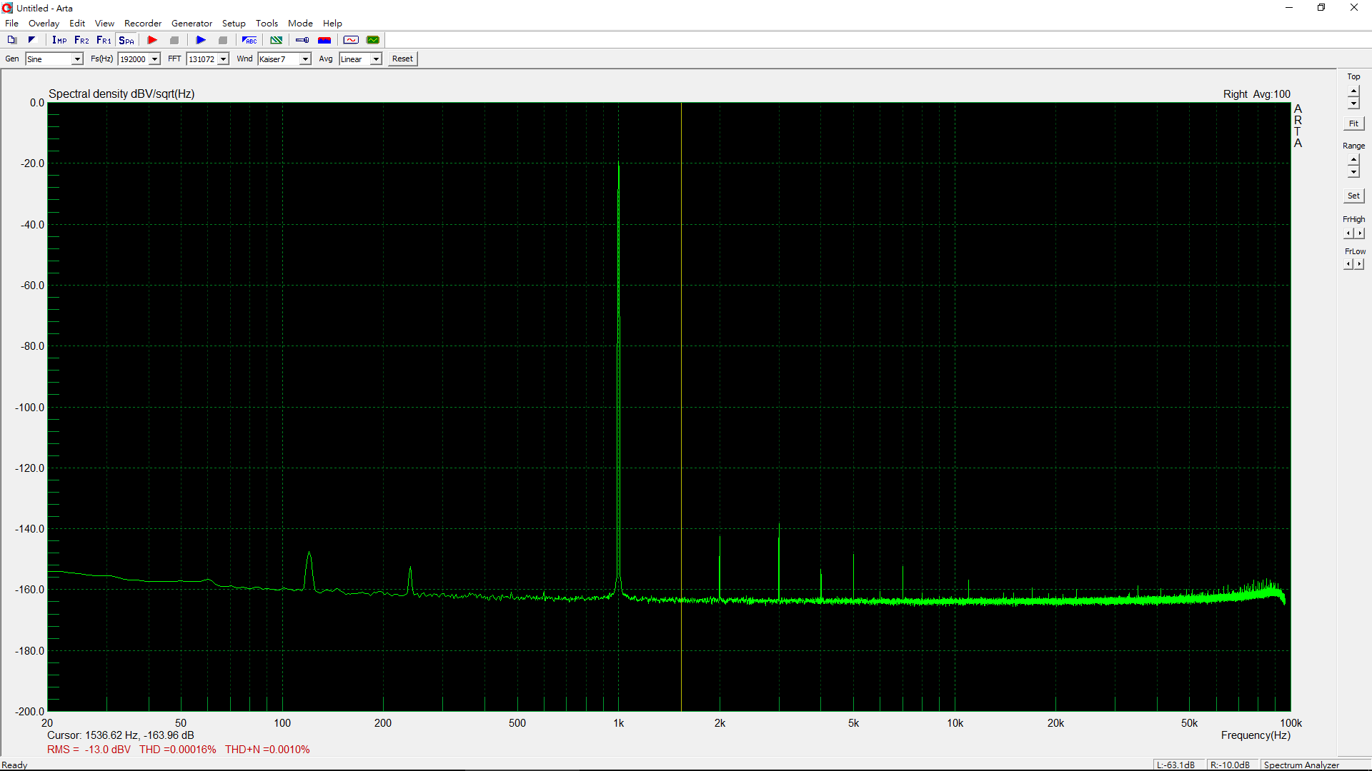

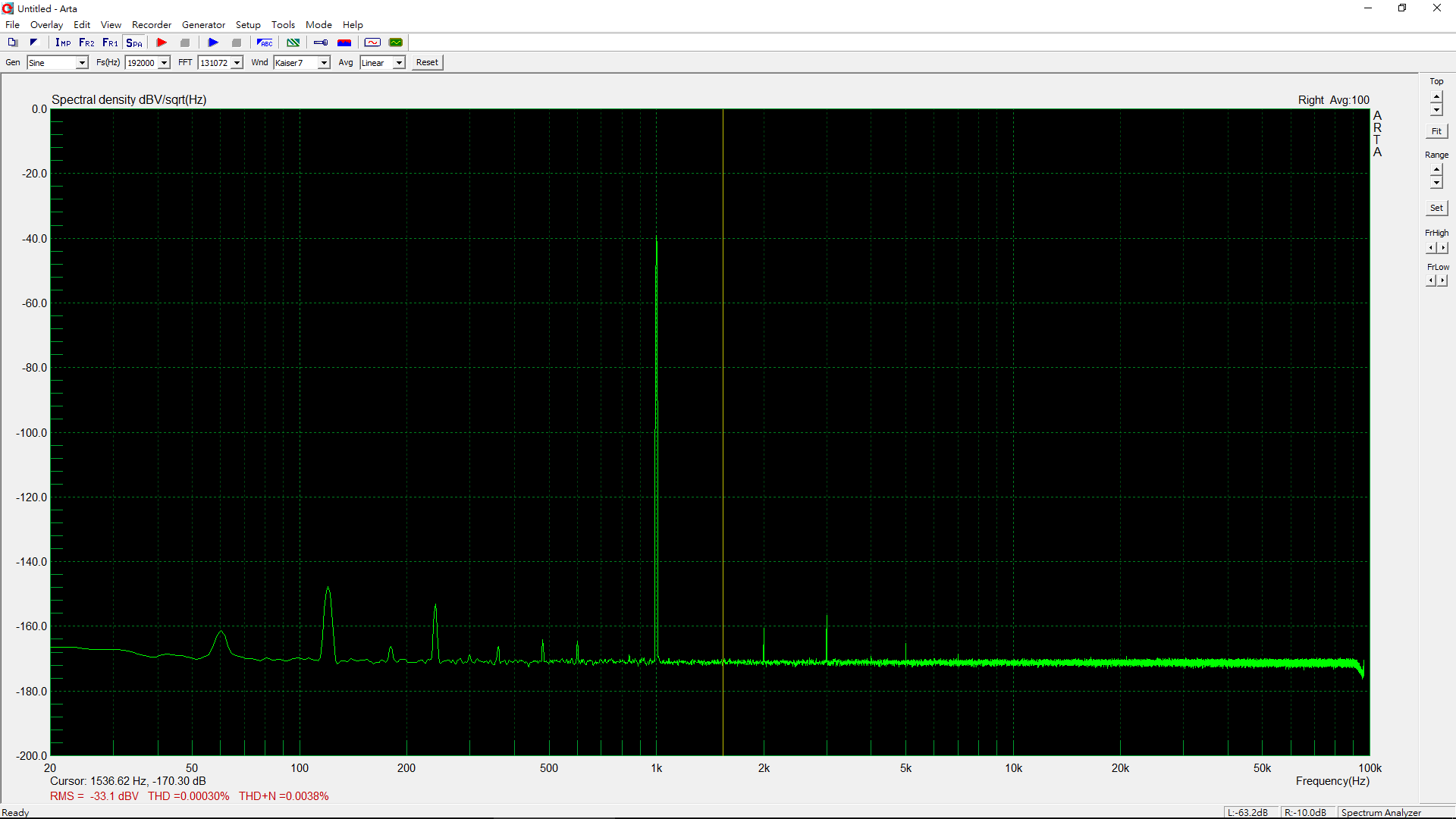

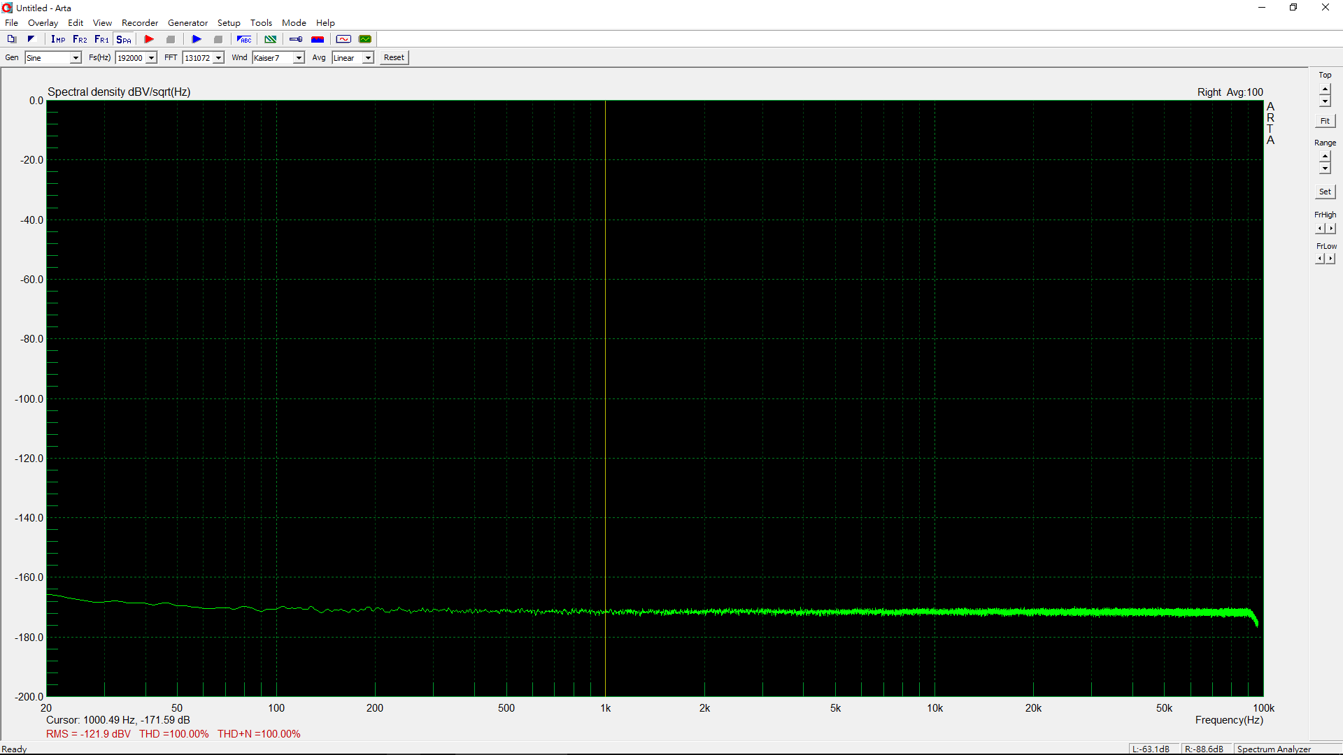

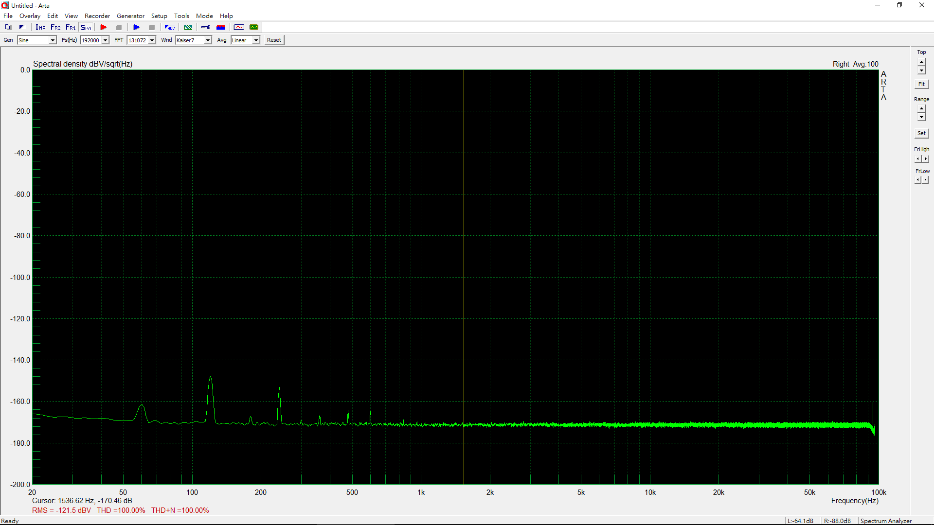

I attached three screenshots:
1. noise floor with a correct gain setting (-20dBV, shorted input).
2. single-ended measurement with 0dBV input and output.
3. single-ended measurement with -20dBV input and output.
For 2 and 3, I used zfe's configuration and the results are consistent with zfe's results except the odd harmonics of 60Hz. It shows that moving the transformer much further away just reduces the odd harmonics of 60Hz with a single-ended measurement. To suppress the even harmonics of 60Hz, some additional efforts have to be made (e.g., battery or SMPS).

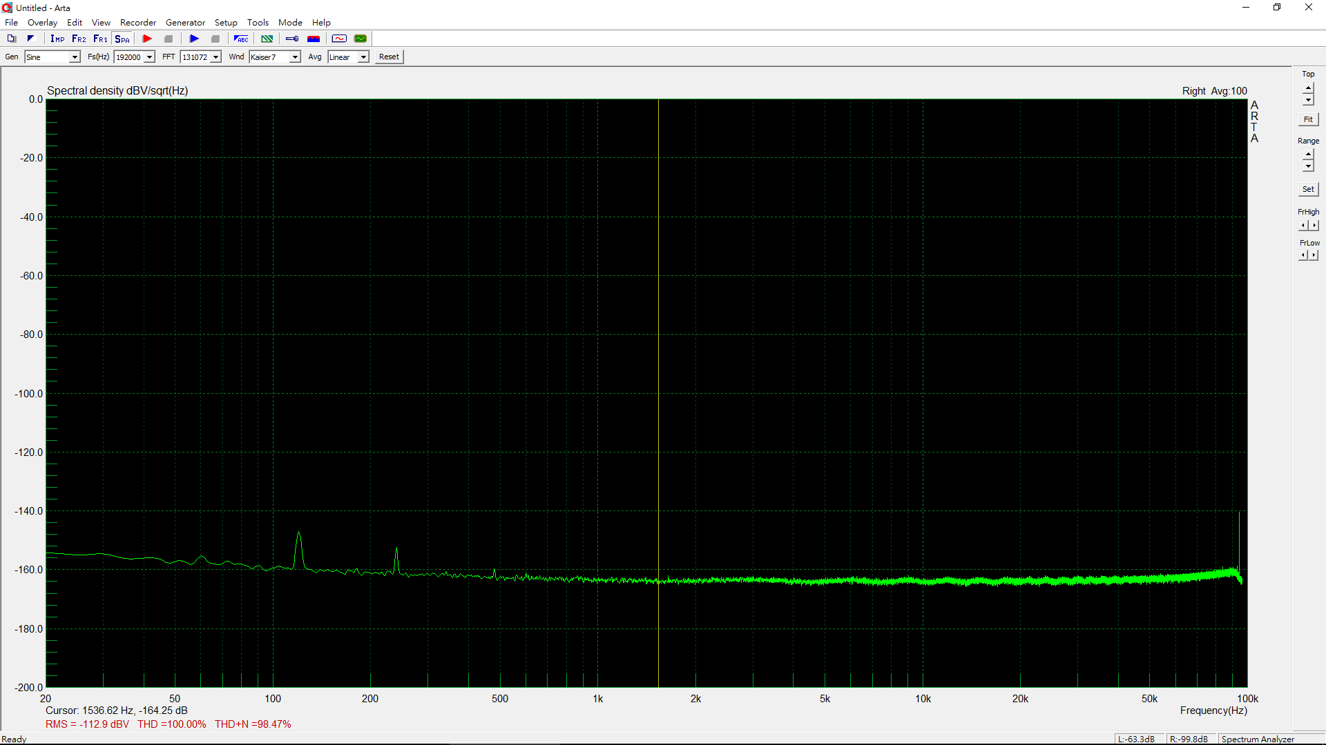

There is also a lot of pickup of environmental noise possible.
Here two unbalanced loop-back noise floor measurements, -20dbV in, on battery power (!), no line connected, in a noisier environment.
The setup is: out to 1.5m RG58 BNC cable to BNC-XLR adapter at input.
First the BNC cable is routed as a big loop
Second the BNC cabel is routed such that it encloses only minimal surface.
