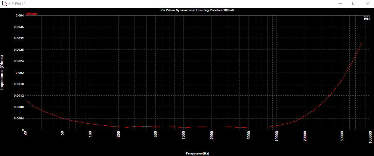

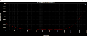

...here is a Zo (PSU) with the floor of measurement on 0.1mOhm
Is this the residual impedance of the PSU output, or is this the residual of the cables, connectors and stuff used in the measurement setup?
Probably, this is the residual Zo of PSU+cables+connectors.
I don't know for the rest, I used the "Power Supply impedance Measurement" from the list of Virtins MI-Pro DUT Measurements.
I used short input-outputs cables (20cm, well made) with bnc and xlr connectors.
I had a very low Zo measurement with a 0.7mOhm on the LT3042 before, but now this measurement of TPS7A4901DGNT was extremely very good!
