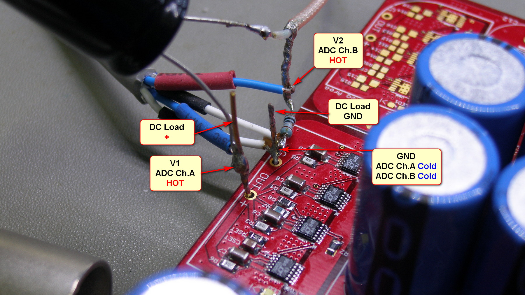

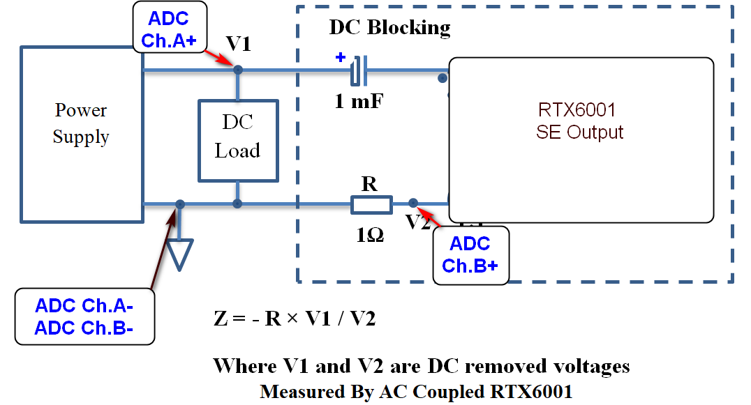

The diagram that I used for the Zo measurement is attached.
The AC injection is always the 10-15% of PSU Load, ie 100mΑ testing load = 10-15mA of AC input signal.

That measurement setup seems sensible. I know from experience that you can reliably measure below 1mOhm, but only at lowish frequencies. The impedance will invariably rise above a few kHz due to drop in loop gain of the error amp.
I would do it slightly differently; I would insert a controlled current into the output and then measure the residual, using Ohm's law to calculate Zout. Not using the 1 Ohms as reference, so any connection-resistance that would add to the 1 Ohms have no effect.
For instance, there are two currents flowing in the ground connection between the 'bottom' of the DC load and the ground point of the measurement probes; one current from the load, one from the 1 Ohms. So do these currents add, or subtract? It is a confounder.
Jan
If you are using the single ended output you need to be sure there is no hiddent parallel ground path. remove the 1 ohm resistor and measure the DCR between the marked ground and the BNC shell on the RTX. The BNC is tied to power ground I believe to meet safety requirements.
- Sure, this setup goes reliable to the lower frequencies against to the high upper frequencies.
- The inserted AC stimulus current is controlled by the software, you can change each time the amount of AC current (at the .dtp file) that inserted at the output.
- I don't know the exact role of 1 Ohm resistor. I think, that this is a common diagram to many related documents. Usually, they insert a transformer at the signal output to break any continuity. I don't use any transfo, but I care to lift any power gnd from my measurement setup, usually (to break any gnd loops).
- The 200K ADC input and the differential input measurement, are the positive of this setup and probably minimized the effect of cable length.

The 1 Ohm resistor is the current sampling point. You are measuring the voltage across it as representative of the current into the load (Va). The voltage across the load (Vb) is the other part of the equation. The amplitude and phase relationship converts to the impedance in VI, Vb (E)/Va (I)= R. You should check the resistance R with a meter to make sure that it is 1 Ohm in circuit and that you are measuring differentially. Testing a reference resistor of around the same value is very helpful in validating the measurement.
The resistor has measured by a DEREE LCR meter and is 0.999-1.000 Ohm
The diagram as told before is the following:

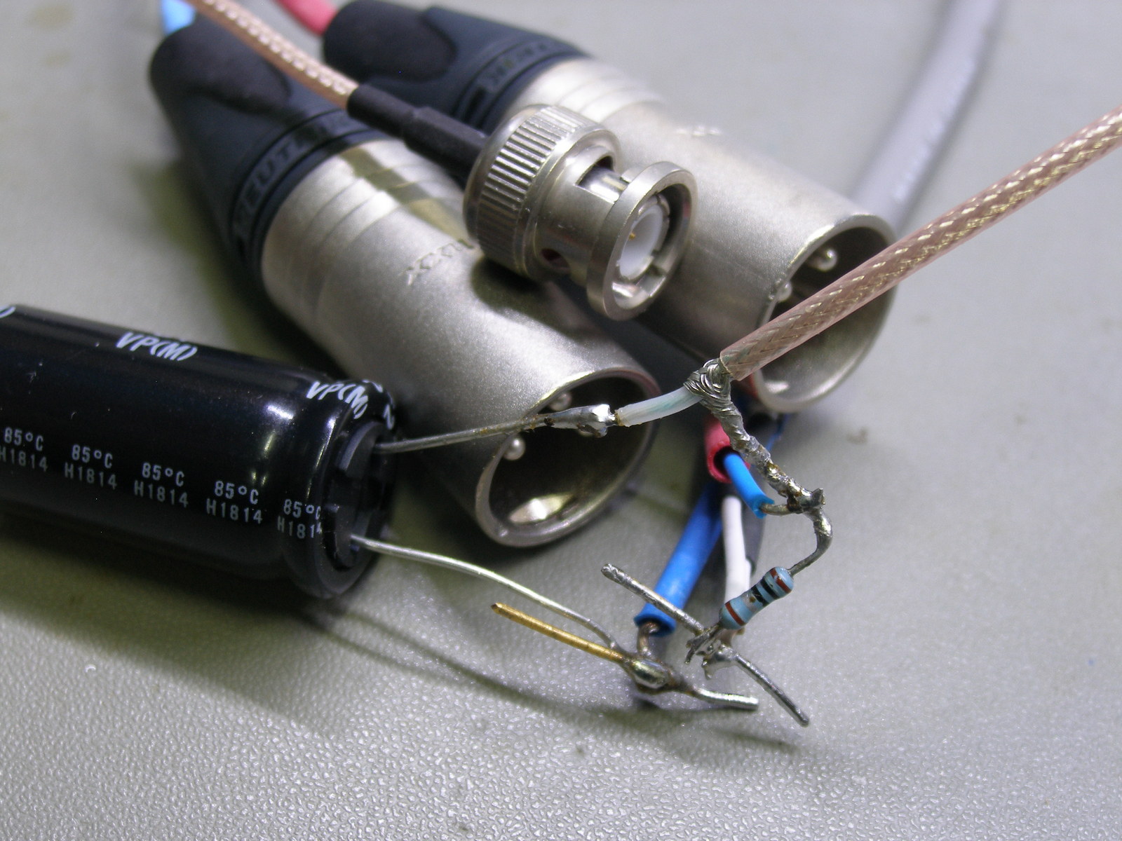

The attached photos are the connection on PSU output for Zo measurement and a photo of cable with the connectors.

Do you have another 1 Ohm resistor? Replace the circuit board with the resistor and you should get 1 Ohm on the plot.
I'll try this later today If i get time. I have a 1 Ohm reference resistor (.005%) and some other good references to check with.

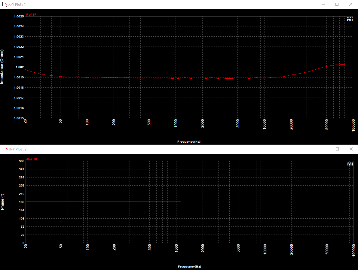

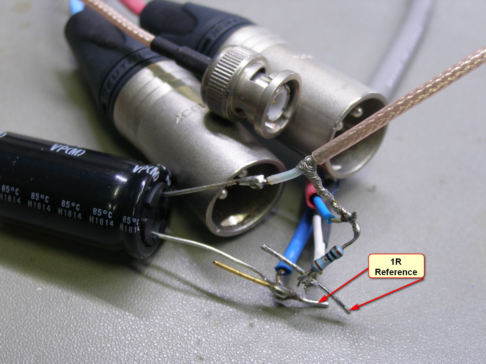

Hi Demian,
I took an 1R resistor that the LCR DER-EE DE-5000 measured:
100Hz..... 1.01R
120Hz.... 1.00R
1KHz..... 1.006R
10KHz.... 1.007R
100KHz... 0.996R
This resistor set between two OFC terminals of my cable setup like photo attached.
If this is what you want, the Zo measurement was from 20-20000Hz to 1.0019 Ohm with upper at the 1.0022 Ohm of 85KHz.
If this test was right, I think must repeat with real reference resistor for valid results.
That measurement looks good except the phase is reversed. Swap one pair of differentials going to the RTX so the phase is 0 degrees across the measurement range. Then take about 20 cm of 20 to 24 AWG copper wire in a tight loop to get something in the 10 milliOhm range (I got about 8 milliOhms for 20 CM of 24 AWG copper at room temperature) and make sure its still around 0 degrees and much smaller than the 1 Ohm resistor. If a and b are swapped you will get 100 ohms instead of 10 milliOhms.
I have been dealing with this for years measuring driver impedance and always need to go through these checks to get everything right. (8 connections mean 8 factorial ways to get them wrong. I have done all of those) If its not fixed like the DER there are many ways to get confused. These simple checks ensure the measurements will be accurate.
