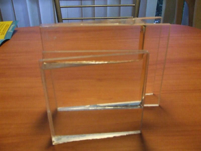

The best result so far is the prism I made on post 537 of this thread. The one I made last week looks beter than the prism on 542 (less bubbles but not bubble free) but can not be used due to crazy cracks on the inside of the Pespex.
I have had this crazy cracking before, so tried out a combination of Perspex and Plexiglas (one of each per side) and it appeared that the Plexiglas is OK...

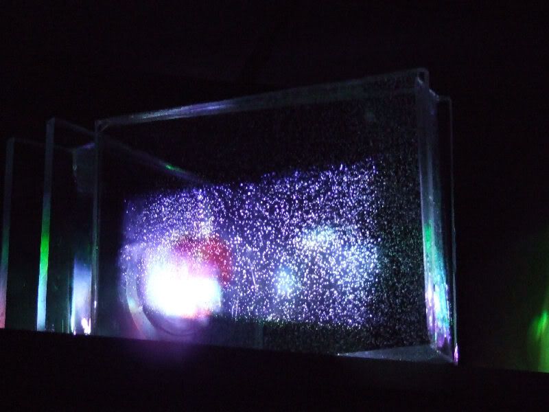

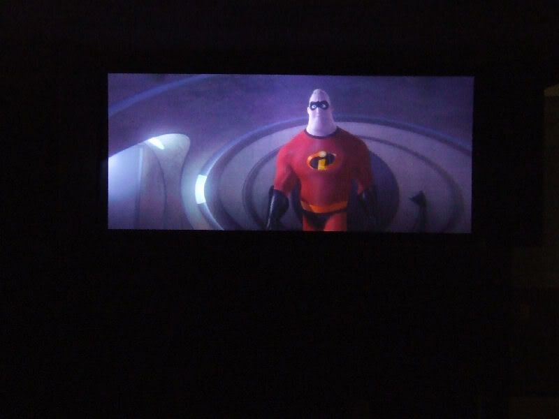

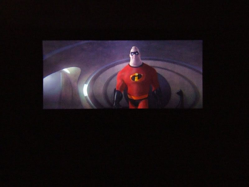

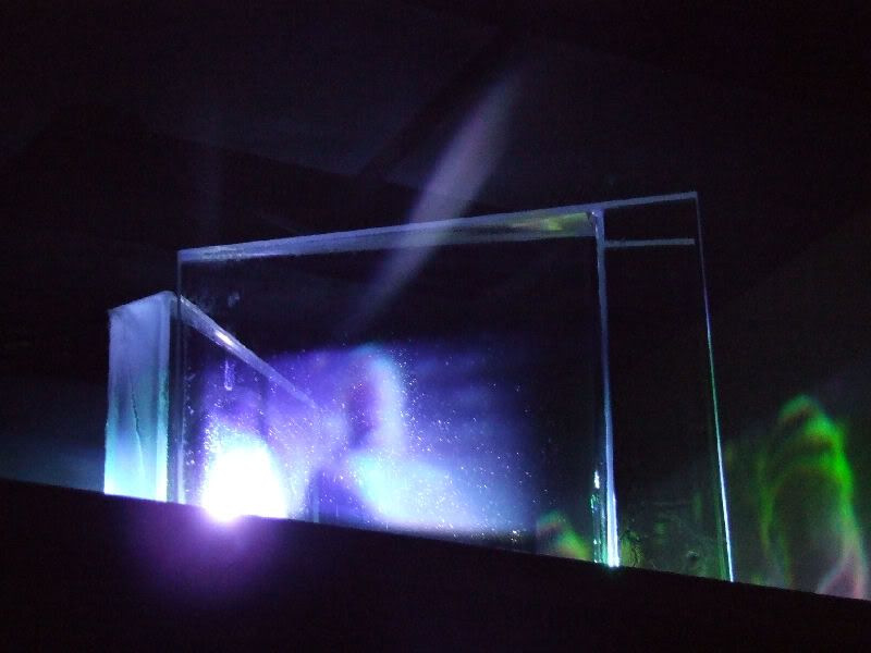

update for those that still care...
Over the weekend I made some more solid prisms, and here are some photos of the lastest development.
The last time I posted the same frame (pictiured below), there was some light patches caused by the bubbles in the front prism. This time round, both prisms are bubble free, and the prism I am using as the larger front prism is actually the same prism I used as the smaller, rear prism last time.
The good news: The resin for this prism was mixed and poured WITH OUT the need for a vacuum chamber. So it can be done by other DIYers!
Here is the older attempt...
I have used the same camera, but must have used a different light setting, hence why this older shot appears brighter than the latest shots...

Whilst there is a slight difference between the water prisms and the solid casts I have made, both seem to have about the same clarity. My problem now is crazy cracks appearing on the inside surface of the prisms. Whilst holding the prism in your hand, the light passes without any problems, but at distance, the fine cracks give the illusion that the prism is foggy and might cuase a slight defocus to the projected image.
There are many explainations for this ranging from a possible chemical reaction between the resin and the Pespex (Plexiglas did not seem to be affected here) to thermal differences due to the exothermic nature of the casting resin Vs the ambient air temp whist it set. I also think that some of these crack are stress related due to contraction of the resin when it has set.
I might give 2mm glass a try and see if that solves this problem...

Yes I have and today I was looking for glass that could be used with a release agent. The resin supplier has two types of agent 🙂 a liquid and a wax.
The only problem I see is that if the surface is not 100% flat, then the image will be affected in much the same ways that crazy cracks have. This is why I wanted to leave the mold front and back on the finished product - a very flat surface and no pollishing required 🙂
I still need to test this and will soon enough...
Mark

I hoping that the glass (I am inquiring to day about an optically treated anti reflection product) has a better surface adhesion than the Perspex. What I have found is that the resin tends to shrink a bit when it has cured, and as a result seems to be stressed and then tear itself away from the plastic, resulting in these crazy cracks. I'm hoping that the glass is more stabe under the same pressures.
