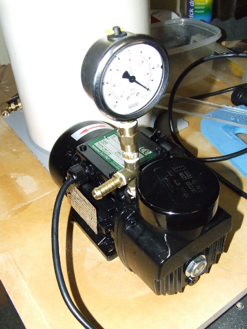

I pick up my electric vacuum pump tomorrow...
It is supplied with a gage and hose. I wonder what fittings I'll need before I can use it?
Mark

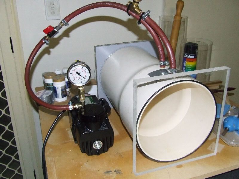

Anyway here is the vacuum system now that it is fully assembled...
Mark

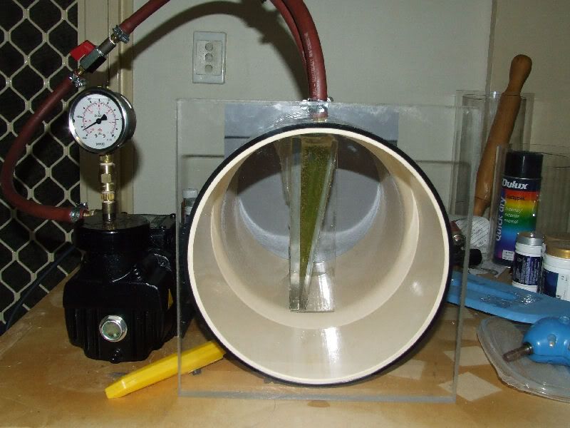

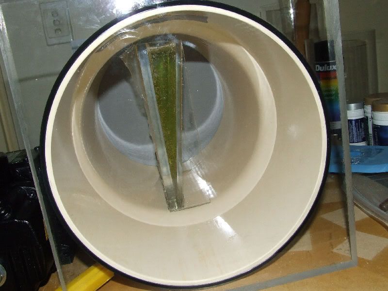

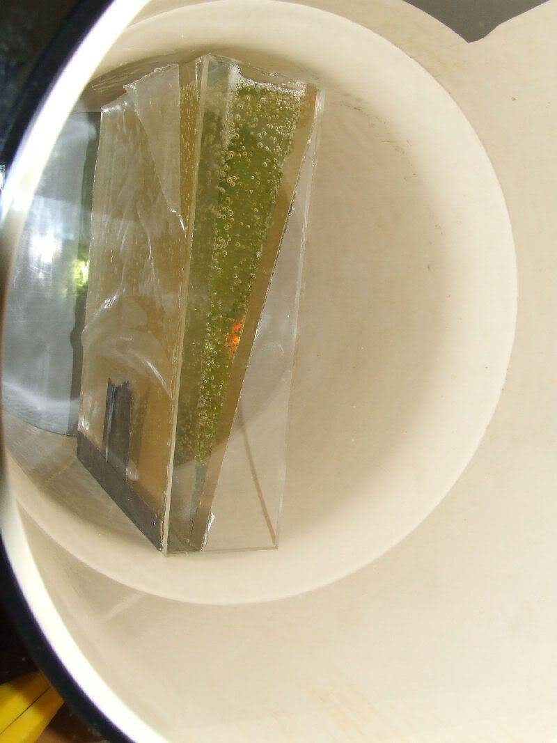

Couldn't wait any longer and had to see what would happen...
I had two molds left over from the last batch I made, so I decided to experiment with yet another tin of resin - all to a good cause in the end 🙂
As I have said, I am not an expert in resin casting and mold making, and had no idea how this product would perform under high vacuum. The hand pump could pull 27.5inHg, but not 29.5inHg.
I mixed the resin in a container and then poured it into the mold. Straight away there were more bubble than you could poke a stick at, so into the vacuum chamber it went.
The last time I had a real successful cast, I used 27.5inHg and the bubbles all came out, but today they didn't seem to be moving real fast, so I let the pump take the vacuum to the full 29.5inHg.
When the bubbles are in a vacuum, they expand, then raise. The bubbles are said to increase in size by up to 6 times, and it was pretty amazing to see just that. There was some "foaming" at the top (image 3) of the mold, but the resin did not "rise and then slump" like my research suggested...
It took a long time and I forgot to actually time the process with a stop watch, but checking my wrist watch, the resin was in a vacuum for over 10 minutes, and research tonight suggested anywhere from 2 to 10 minutes is normal. Also the fact that I am casting vertical adds to the time as the bubbles have much further to travel...
But the bubbles did not seem to disappear, but rather new bubbles forming at the bottom, and I can only assume that I had too much vacuum, and that the resin was starting to burn off...
Anyway, something very interesting (later confirmed on the net) was that when the chamber is re-pressurized, the bubbles that did not escape can be crushed by the sudden change in pressure, and this is pretty much what happend here...
So overall, a pretty good result. I will know exactly how well it turned out in the morning when I can remove the paper...
Here are a few images...
Note the colour change. The resin is slightly offocolour before theit is mixed, then turns green as it goes to a gel state, then goes clear when it has set. I have just quickly checked it and it has already gone clear...
