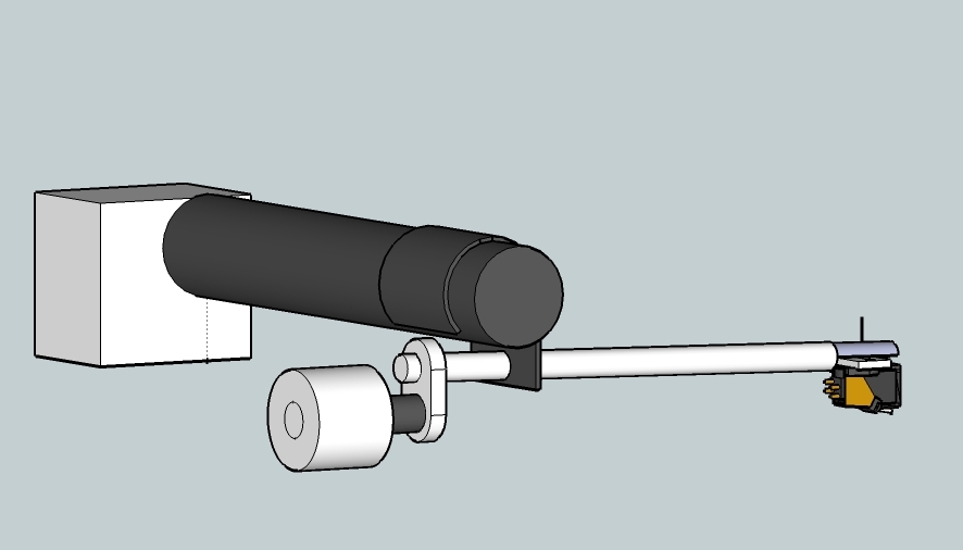

looking at Inertia a little closer....
First, the side of the arm that the counter-weight is on has a higher Inertia for any given accelerations so it resists changes more than the stylus side of the arm.
Secondly, the arm doesn't care where it rotates. Yes, rotating about the centre of the arm appears more elegant, but again, due to Inertia, it is of no consequence. The arm should remain very stable. The acceleration required to overcome yhe counterweight's mass is very large compared to that which the stylus cantilever can provide.
There is however an inherent stability to any "under-hung" arrangement.
I'll do a few sketches to illustrate the point
stew
stew
cid a couple of sketches....
the result? less than a .84% difference in the effective length from the location of the moment to the stylus tip. Pretty sure there are other things to consider before trying to kill off the source of a relatively minor issue. As I stated, a hanging arm is inherently stable, and the round "hanging" arm has fewer parts, so in theory the source for erroneous machining is reduced, and hence the accuracy of said device.
stew
stew

On the subject of the mass and the stylus being under pressure. I did a quick and dirty eyperiment using a verve record with an odd lead out groove where the lead out groove runs the stylus in and out over the entire lead out area - its kind of hard to explain - but if you9ve ever seen one you know what I mean.
Anyway, on that fairly tough test, I could not see any deflection of the stylus as it moved the whole arm in and out repeatedly at the end of record. I think I used it in one of the youtube vids I posted back up aways.

The lower the moving mass the better. Nanook, the moving horizontal mass is dominated by the counterweight in a very GOOD air bearing arm, but not in one where the rest of the moving parts weigh more than the counterweight. I vote for reducing the total moving mass as much as possible.
As far as "seeing" the cantilever move, once you get the arm in motion, its own inertia is trying to "throw it" to the inside of the record. The flex will take place on the take off where the slope of the groove suddenly increases. Might take a slow mo camera to see it with the eye...
In the meantime, the arm is constantly being pushed toward the inside of the record by the outside of the groove - assuming the TT and arm are level. There is no other mechanism by which it can be made to travel, it has to follow the groove. By contrast, the standard arm wants to travel to the center, so we apply "anti-skate" to keep it centered in the groove. (another approximate solution) So again I vote for the arm that can change direction the fastest, and that will be the one with the lowest total overall moving mass.
This is why - in part - that several very smart designers of linear tracking arms have made the part that moves very light, and the length of the "arm" that holds the cartridge very short...
