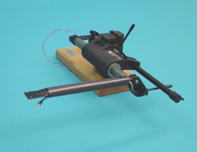

I had an idea today for which I would like some feedback - a modified Laadegard approach (not a Terminator style, it would be tricky to invert it, I think).
While the Laadegard and Terminator arms use right-angle Alu stock and a knife edge pivot, couldn't a similar DIY air-bearing be constructed out of two concentrically matching half-round cross-section pieces? The arc would point upwards (rainbow) and if the armwand attached directly to the upper piece, you could get rid of the knife-edge pivot. The air-bearing track would be the pivot! The stationary track could actually remain a hollow tube, the arm-bearing track a semi-circular cross-section piece riding on top.
Potential challenges include: trying to mount the armwand as close as possible to the centerline of the bearing, and of course lapping or somehow conforming the inner and outer bearing surfaces (or even finding closely matching tube to cut down the middle in the first place!) But it seems to me that there would be added simplicity and tangential rigidity by doing it this way.
I'm gonna try it! Unless I missed something tragically obvious as to why this might not work so well...
Sure it will work - most of the commercial air bearing arms are done like this. Have a google for kuzma, ET, cartridgeman, arms. Heres a pic to help you on your way:
BTW, there are speciality manufacturers out there who will make the 2 sizes of tubing needed for this jobwith whatever clearance you need. If someone was willing to go for a group buy I reckon you'd get a few arms out of it, prob have the cost for the tubing down to about 40-50 a person.
That would allow for a neater style of arm compared to the terminator. Sonically I don't know, but all those commercial arms are well regarded.

Fran,
yeah, I'm well aware of many of these designs, which of course use a tube-within-a-tube design. The barrier to DIY there being of course the precision fit required between the two.
My idea is a stop-gap between the Ladegaard and these pro air-bearings. I figure if the angle stock approach can yield results by careful selection and lapping to improve the fit with the Ladegaard then why not try some cylindrical stock? With the carrier being only half-round, it seems to me that the fit could be tuned DIY without the difficulty or expense of matching concentric tubes. The fit should be at least 50% more forgiving!!! (gotta love my math - you can tell I have a PhD in physics)
Seriously, it seems like this approach wold look more elegant and even simplify some matters of construction (no knife-edge, primarily) and so I was just surprised, once I thought about it, why I haven't seen this approach before, DIY or commercial.
But thanks for the air-bearing porn - just adds fuel to my fire, you know!!! Cheers.
